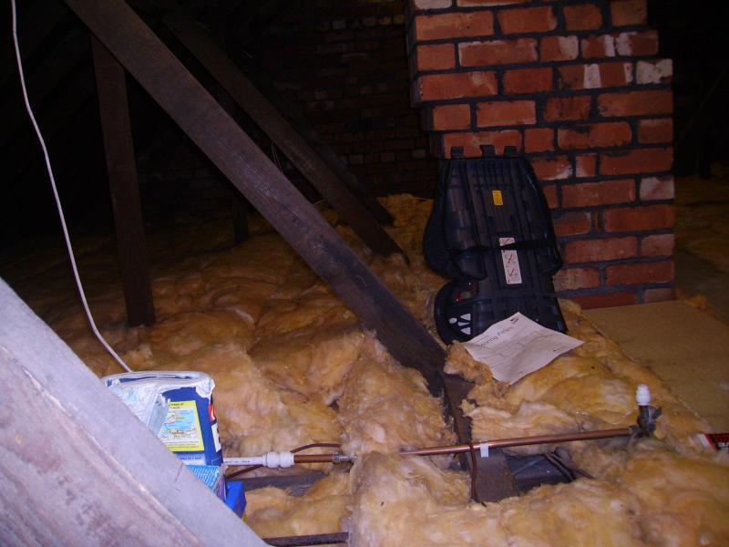

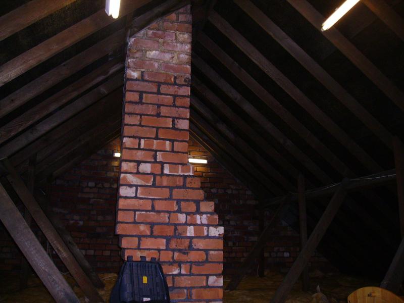

my ceiling joists are 3x2 do you think it would be safe to cross bastten with 2x2 and board with 18mm chipboard flooring to create a room my my son to play games console ??
many thanks guys
A lot of weight you are adding to very spindly joists, and I'm sure some kind of furniture would end up there too, so even without asking about joist-span, my opinion is no.

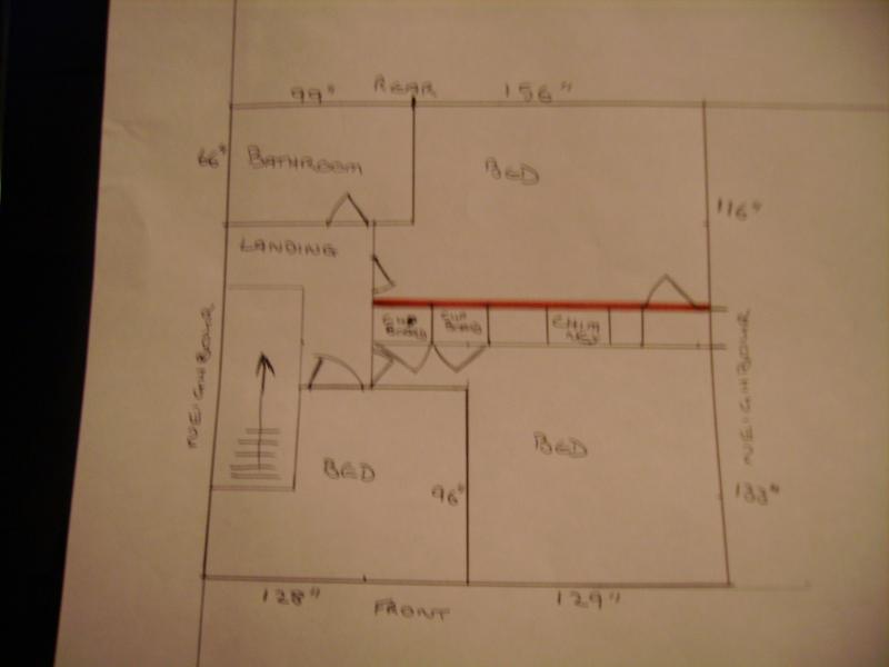

the red line on the plan shows a load bearing wall
could i run 8x2 joists (or less) from the wall plate to the wall from either side and then overboard to create the game room.

do you think it will take the load ? the red wall runs right through the house and after a quick search i thought 8x2 (at 16" centres) would be enough as the span is about 10' one side and 11'6" on the other.

checking span tables i see that C16 170X47 @ 400 ctrs should be fine for the span 3.4mtr

I'm not being funny. I must have done something wrong and I want to know what which is why I'm asking. Am I mis-interpreting the tables or is it no good using the exterior wall to spine wall for the span distance ?

but im still none the wiser as to why 8x2 joists are no good to span wall plate to internal load bearing wall. 3.4m @ 400 ctrs
