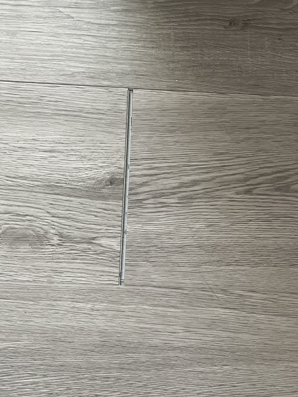

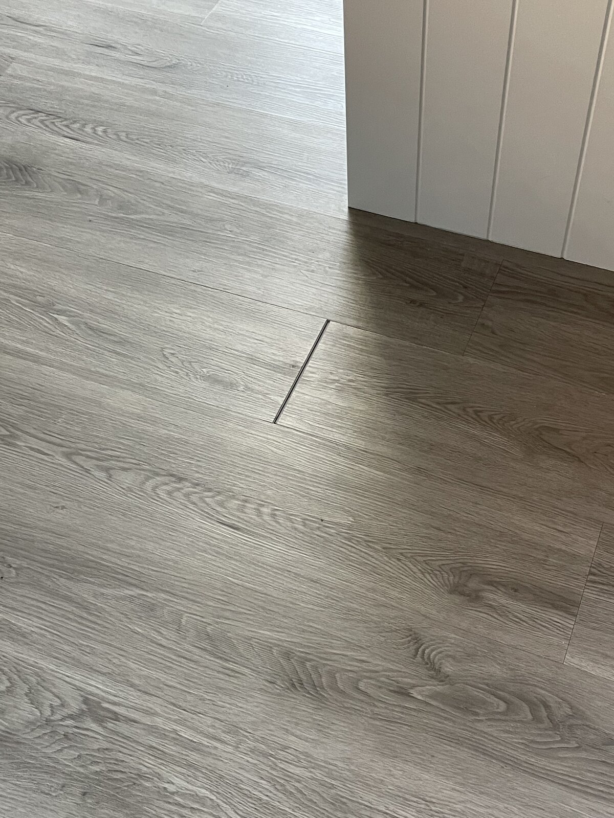

Is there an easy way I can get rid of this gap please ?

Bare feet work well as they provide suitable friction , if it keeps happening you can put a small panel pin thru near skirting at end of run to prevent further separation .
