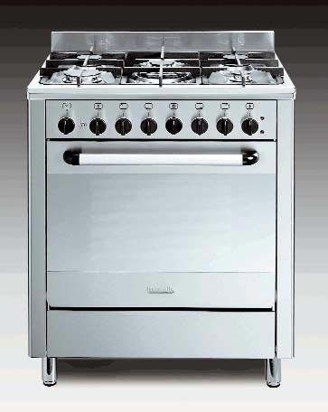

Hi,
I have a freestanding gas cooker that won't fit right up against the kitchen wall due to the gas tap and piping.
This leaves a gap of about 1-2 inches between the back of the hob and the wall, which food likes to fall down.
Has anything been designed to fill this (a strip of metal would do). I have tried searching online, but as I don't know if anything like this exists and, if it does, what it's name is, I am having no luck.
when I am stirring things, like pasta, whilst on the hob, things tend to get a bit messy and food has been lost down the back.

Here is a pic of a similar oven to mine. As you can see, there isn't much of a splash barrier at the back so food keeps falling behind it down the gap between the cooker and the wall
I am not sure I understand what you mean? Do you mean attach a splash back to the the kitchen wall that sticks out by a couple of inches thus covering the gap?
Personally I would have the Gas moved so that the cooker sits flush to the back. Much neater finish.
