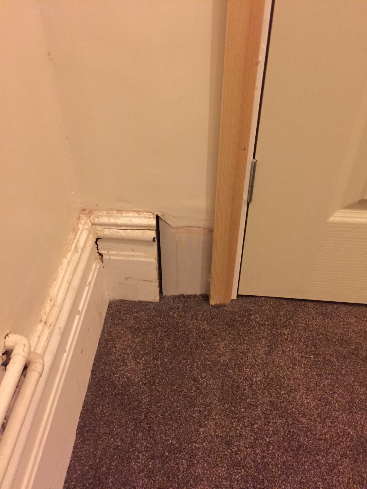

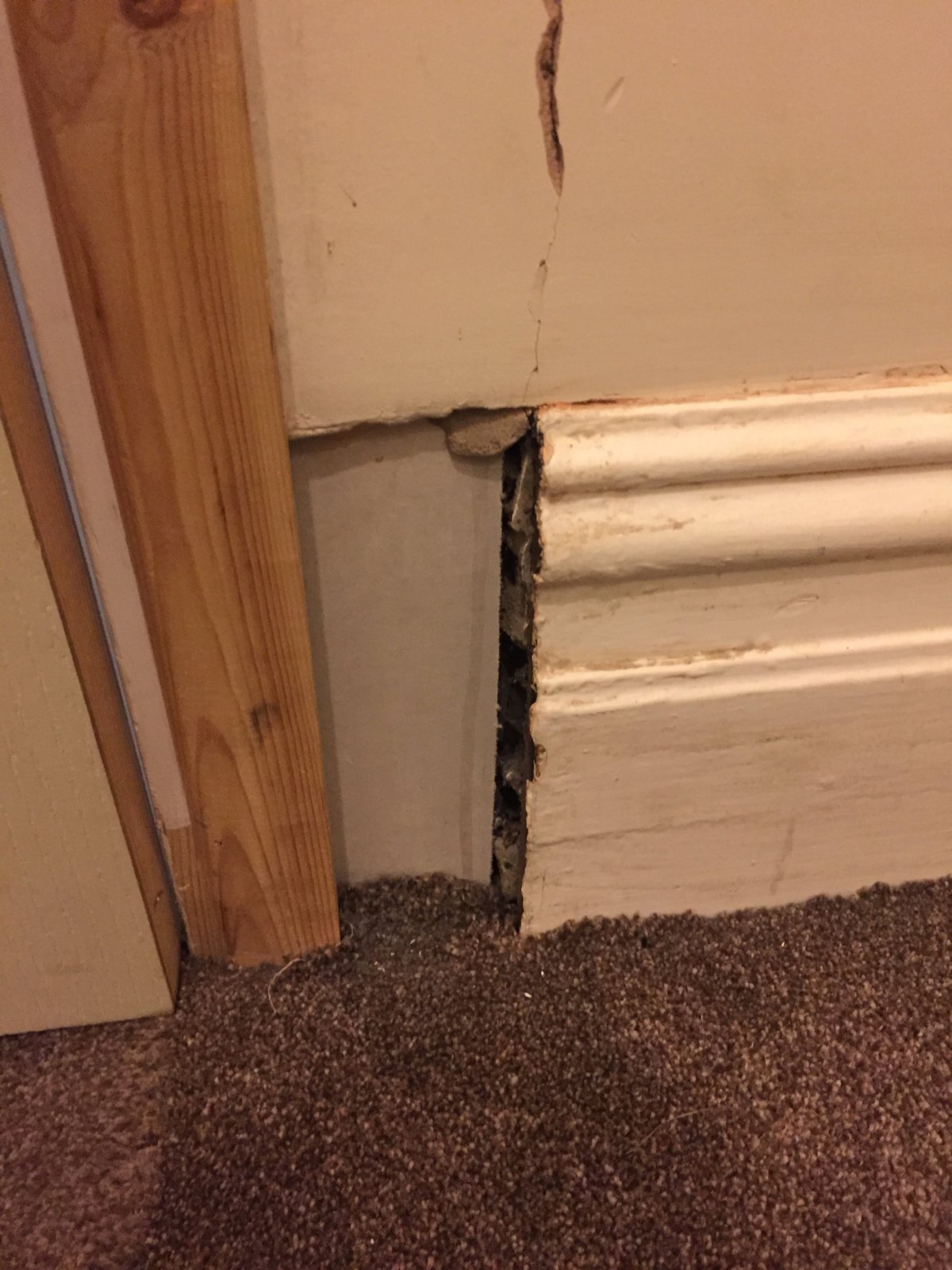

Hi All,
I have had a new door put in and the trim around the door is much smaller then what I had before. I am now left with a ugly gap.
I am struggling to find skirting to match, any advice how to tidy this mess up so its does not look so bad?

Various options open to you:
1) Wait until one of your neighbours chucks out a length of matching skirting.
2) Make some duplicate, yourself. Looks like it could be done with a few layers of 4mm MDF and some beading.
3) Replace the lot
4) Install plinth blocks to fill the gaps, and add similarly deep architrave around the door. (The door and architrave you have now is the cheapest you can get, are you on an extremely tight budget / rented house?)
5) I think this is a close match: http://www.dressermouldings.com/store/timber-skirtings/type-34-timber-skirting.html

In an older house, you would do better to fit a larger architrave, as near as you can find to the original.
Next time, keep the old architrave.

Try and find another bit from around the house in an inconspicuous area that you can take off and use to fill the gap. For example an under stairs cupboard.
