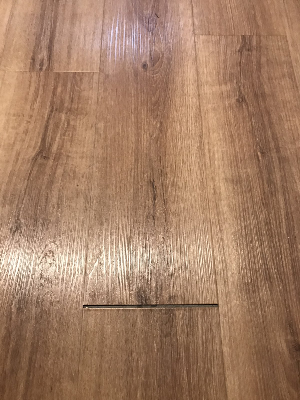

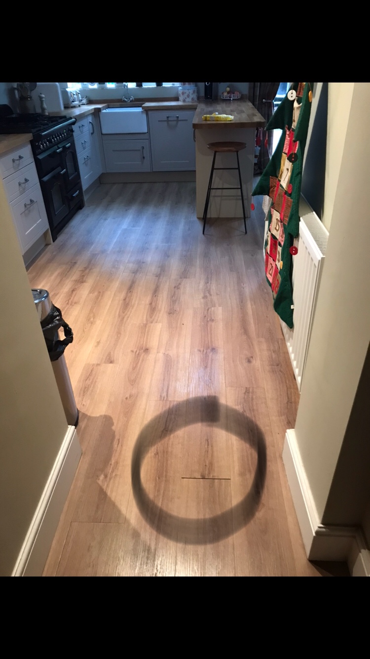

Good morning all,
Gaps have began appearing in the floor we had fitted over 12 months ago. The floor has a very slight raise which I guess it can be expected. As I cannot move the board back, is there any fillers on the market that I can use to make the gap disappear? I’ve shown a pic of the worse gap. The flooring was from howdens and was a new line. It’s like wood but on a bendy, rubber type board. Can’t remember what they called it.
Many thanks
It’s vinyl click.
It should be able to be knocked back in. You need to hit the end of the row with a block and hammer.
Many thanks daz. It must be under the kitchen units where the end is. I’ll have a look later.
Is there any such filet incase I cannot get it back together?
You can see then length of the run as the end must be under those units you can see in the kitchen. Will is still be ok to hit it?
