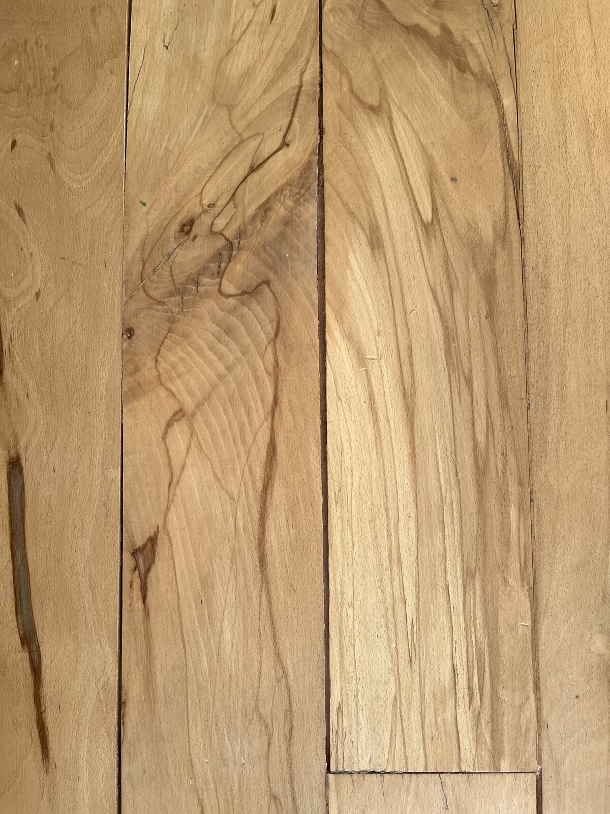

I'm trying to fill in gaps of my bedroom floor so I can sand and re-varnish - floor is birch and hasn't been touched in 25yrs.
Problem is some of the gaps are about 8mm and wood looks like it has warped abit. Not sure if I should use filler or glue in some pieces of wood. See attached picture.
Any help/ advice appreciated.
You can mix sawdust from a spare or similar species board and mix with glue for filler, its a bit messy though. Can you leave as is to allow for the movement that has already occurred?
Used sawdust and glue for the smaller gaps. But wasn't sure about using if for bigger gaps or if there was a better way. But you are right, leaving boards with gaps is one option.
Slivers of wood for the larger gaps, or use filler and sand floor after
Found some pine slivers - was going to use these even though floor is a birchwood floor. Should I really get Birchwood slivers?
