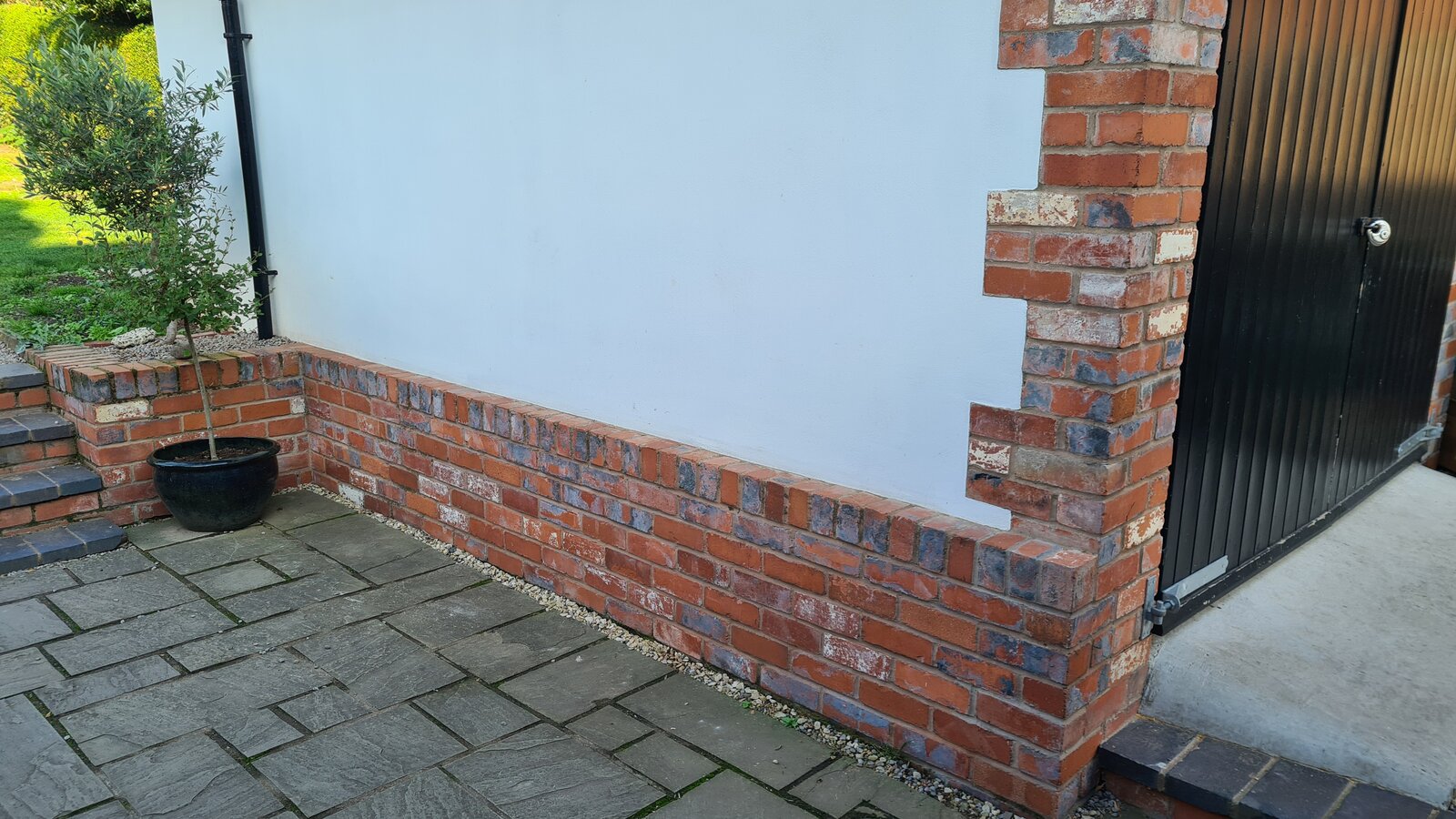

Hi all.

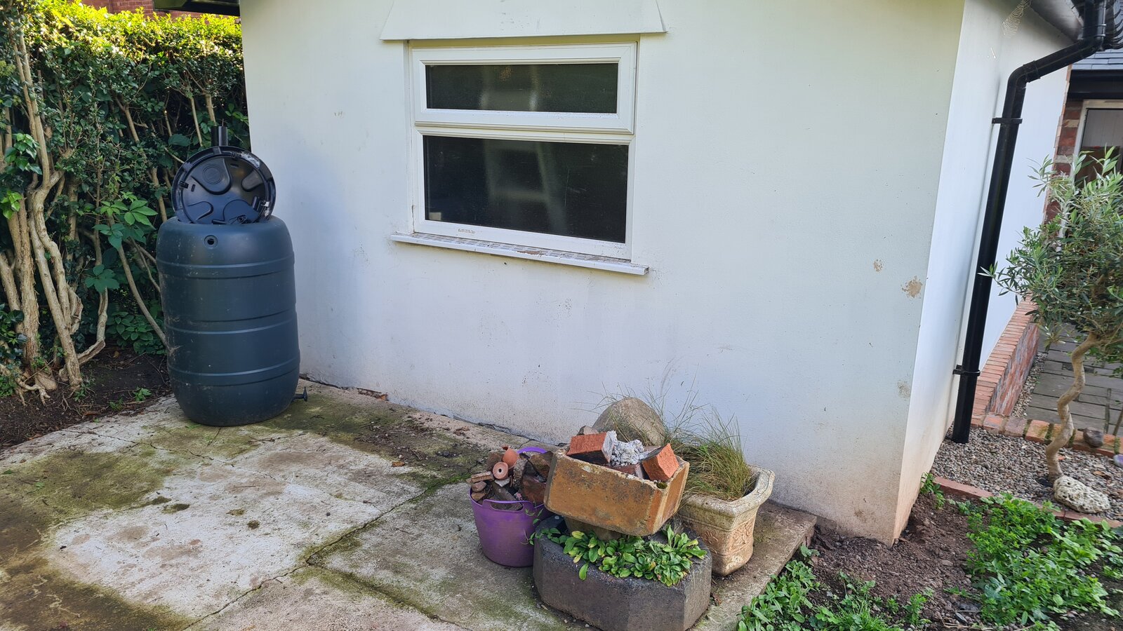

Not far off starting a conversion on our garage. Was built approx 18months ago.
Single block skin with render finish. The plan is to stud out inside, rigid insulation board between studs then a sheet of rigid over the face, then batten (service void) then plasterboard. Obviously taping and sealing for vcl etc.
What I'd like to know is what's the best idea for ventilation within the cavity? We have vents ontop of the fascia, underneath the first corse of slates but that's it. Would this suffice? Or is there any ideas? Or do I leave as it it...

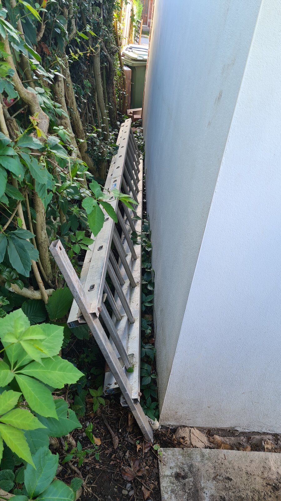

As you can see the rear wall is retaining some of the garden at the moment but will be tanked etc once the new drainage line etc is put it. There is no signs of damp inside etc either.
Much appreciated

Because that's what you do on garage conversions!
Otherwise you'll need to continuously vent the top, and fit a tray and drainage at the bottom

The back of the wall would be lined with a DPM
Sorry I miss understood your point. So your saying build a timber frame but tight to the block?
But what if (highly unlikely) water did get in??
