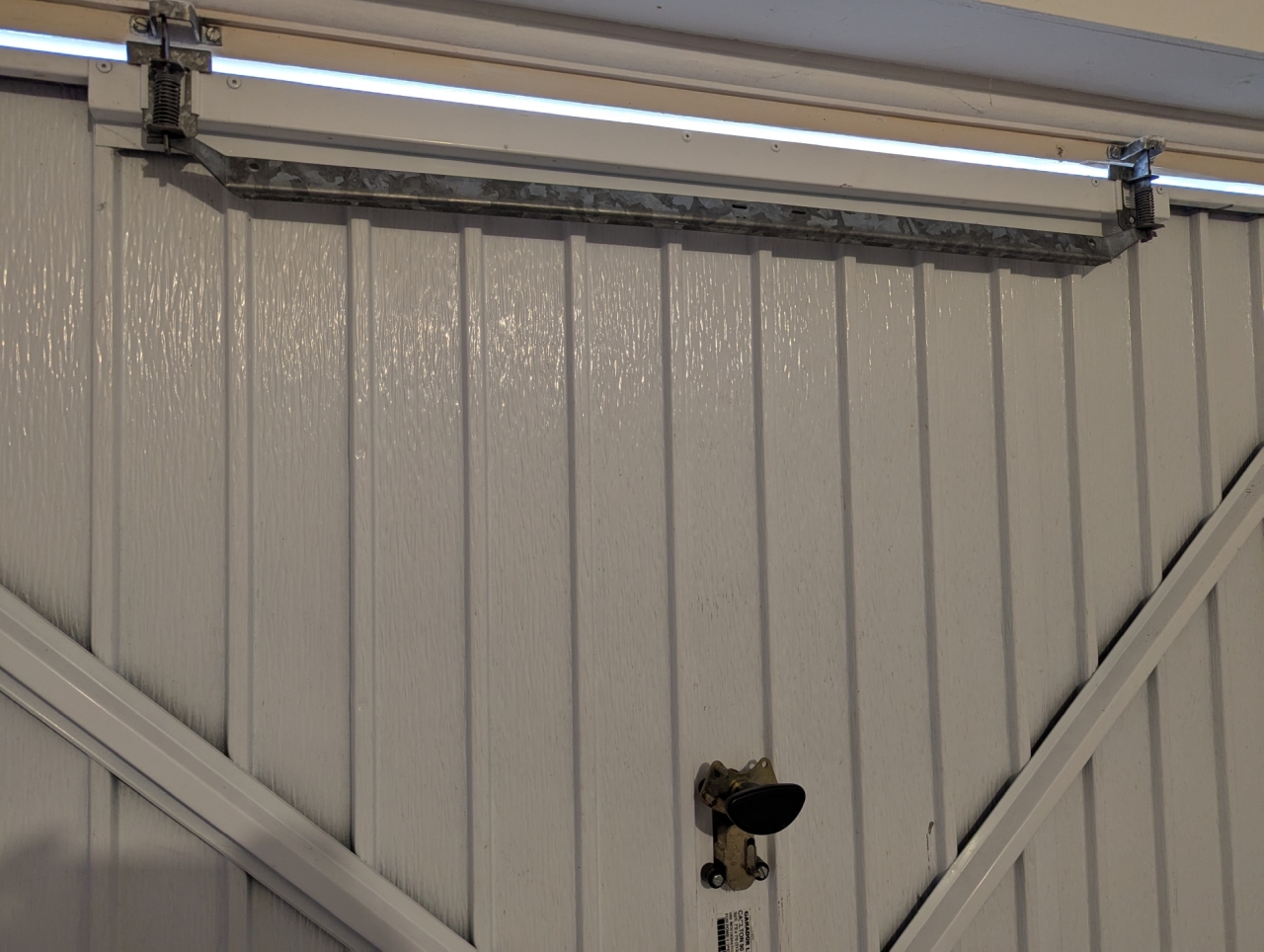

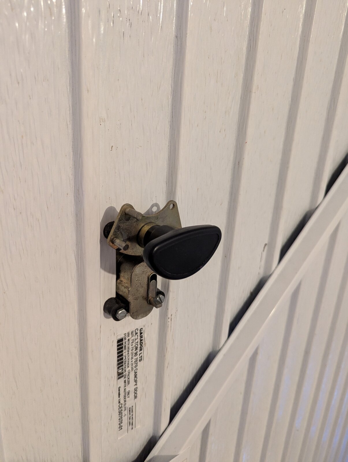

Garage door missing parts

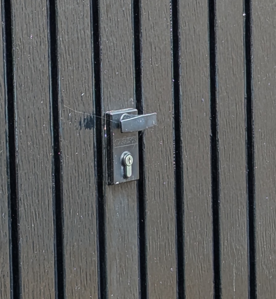

And all a burglar does is thump a pointed screwdriver through the tin door and push on that vertical bar and doors open, seen it 100s of times when doing burglary locksmithing
Nor could my original up and over door, it's a 'feature' of many of them. You could lock it from the inside, by disconnecting the vertical linkage.
Those up and over doors are very easy to break into, which is why you see some with added hasps and padlocks either at the bottom, or the sides. If there is another means of entry, then simple sliding bolts can be added, at the sides, on the inside.
