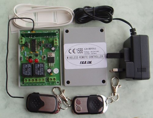

the one shown is just £8 so it would be easy for an installer to add a remote control instead of push buttons.
This unit
Often there is a pneumatic switch worked by a pipe at bottom of the door rather than beams of light. But it is down to the installer to ensure safety, I am sure with my father-in-laws the installer intended to remote to be used when in the car or standing outside, not from inside the house when I have phoned him to tell him they have been left open.
The installers were clearly not that good, they had to be called back to install a keyed release for the doors, there was no personal door to garage and the consumer unit is in the garage so had the power failed you could not open the door to reset the overload. Ups!
But it does seem you can buy replacement fobs and even a complete system is only £35 complete with two fobs, as to if it could be DIY installed is another question. I looked at the instructions and it seems it does not switch the neutral as shown in the diagram you have linked to.
The diagram shown does not match exactly with your unit, it would need some changes, I just selected a random advert to show you can buy the units to add onto a simple system. There were many others on this site I am sure one would suit your door. It is a case of selecting the one which best does what you want. With one of the options it states when you fit photocell remove this wire, so it would seem some are designed for use with safety beams. As user/installer you will know the dangers and you would not try closing from inside the house. But for user only they do all sorts which the installed does not expect.
