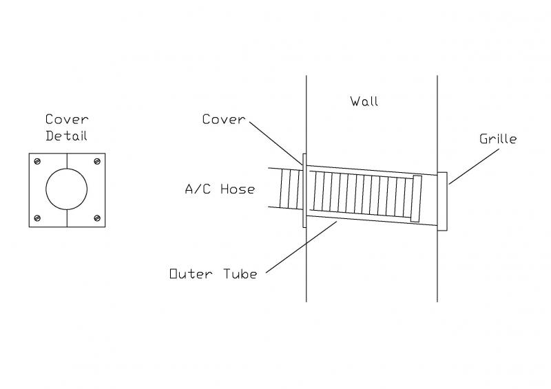

The a/c unit came today but i havent a clue what to do about venting it through wall as the end of the exhaust hose is oblong (7 1/4 inch x 3 inch )see photos ?
Any help would be appreciated
It looks like it's pre-formed probably to fit some sort of outlet sold as an extra by Dimplex. Can the end section be removed back to the circular section, or is it moulded on? If it's moulded on, here are some suggestions you might like to consider.
1. Cut off the rectangular section and connect the hose to a standard venting kit. Check you can get one of the correct diameter for the hose first though. However I don't know if this may effect your guarantee or not.
2. Insert a pipe or flexible duct of a larger diameter than the rectangular section through your wall, slope it downwards slightly towards the outside so that any moisture that gets in doesn't run indoors. Fasten a grille on the outside (one which has as little restriction to the airflow as possible) Then insert the rectangular section of the A/C hose inside it. A close fitting cover can be made to fill in the gap between the two hoses and prevent exhaust air comming back into the room. The cover can be cut in half placed around the pipe and screwed to the internal wall after installation of the ducts. Here's a sketch.
