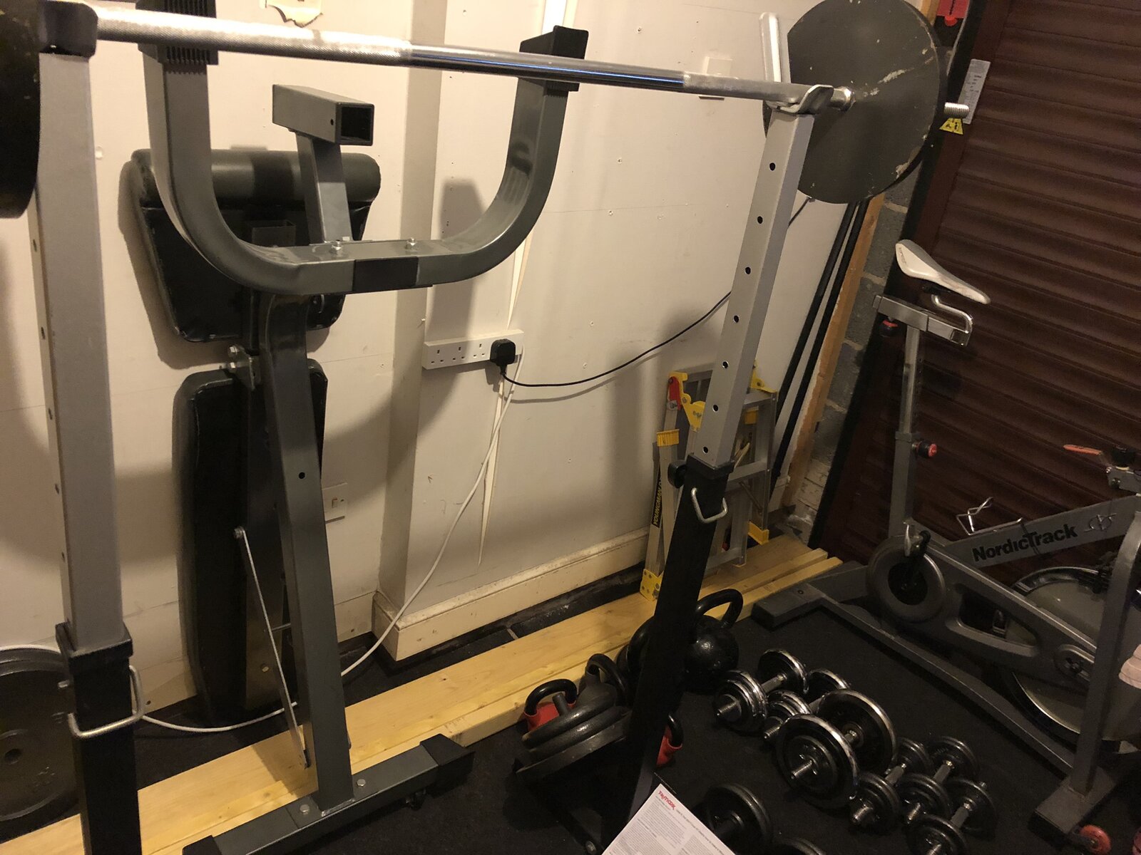

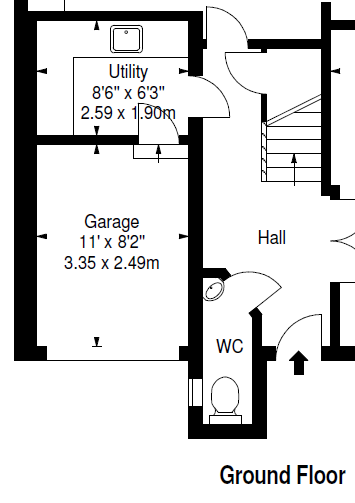

I am considering how best to line some unused garage space which I currently use as a gym (and bike workshop).
My house originally had an integral garage. Previous owners adapted this for use initially as an office space by lining the walls with plasterboard (using 1 inch battens and no insulation then installing a floating floor on top of the concrete base.
They later had part of the garage converted to a utility room. They removed the flooring throughout, but leaving some unused space still with the plasterboard lining. I’ve attached some images below to hopefully show what I mean.

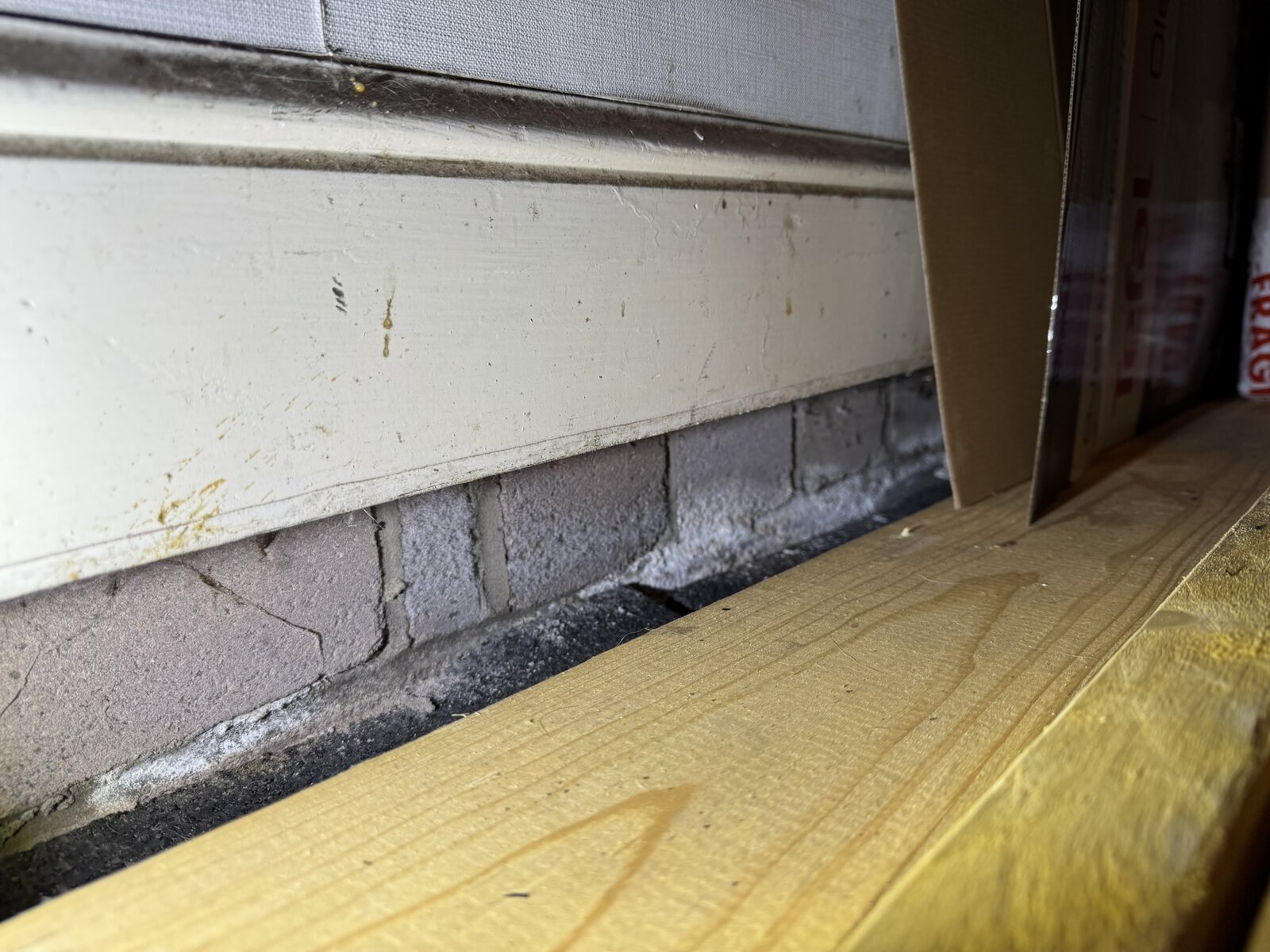

I can see the garage concrete slab has a DPM and when I bought the house they had already insulated the cavity walls.
External walls of garage are breezeblock built on brick piers (my ground floor is suspended timber floors) and the garage floor itself is a concrete slab.

So the simplest way I can see to achieve what I want is a floating floor system with chipboard on top of battens, with a DPM below lapped up the walls to the height of the exterior wall DPM between the brick piers and blockwork. Then batten the walls and apply the ply sheets.
I’m unsure about insulation though. I’m happy to put insulation in the walls and floor if it is a good ideas, but unsure the merits of this as one side of the room is still the roller garage door and whereas the Hormann door made a vast difference to the room temperature compared to the old metal up and over door, would there be any real benefits from installing insulation in the rest of the room as the room temperature would ultimately be dictated by the heat loss through the uninsulated garage door?

Insulation would still have an effect even with the uninsulated door, but you’ve said you’ve got no issues with the temperature in summer or winter, so not sure what to advise. A popular approach is to line the walls with 50mm+ PIR trapped to the masonry with battens and a vapour barrier and ply it.
Is it a habitable/heated space above?
