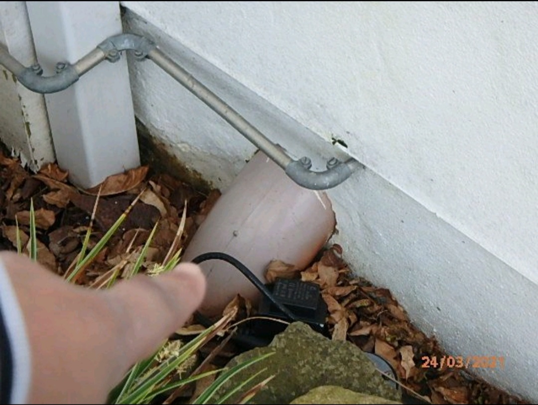

The main issues will be solving a small patch of damp (see photo) and sorting the insulation - would welcome some thoughts on both of these.
I think the damp it is probably condensation but I can't rule out rising damp. I was planning to knock off the plaster, inject a DPC tank with cementitious tanking slurry, then plaster with cement based render.

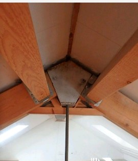

The second issue is about insulating the ceiling. You'll see from the picture that it’s a sloping ceiling and there are a couple of velux windows already installed. I had initially thought that I would just overboard the ceiling, adding a layer of celotex + another layer of plasterboard, but that seems like a faff because (a) it will be difficult to find the rafters and (b) I can't think of a decent way to add any additional insulation around the velux windows using that method. (We might also add a couple velux, which would be easier if I took the ceiling down.)
The trickier issue is that there is a metal thing (see other photo - not sure what it is called!) at the apex of the roof. You'll see from the pic that there is a ton of mould up there from condensation. Because its metal it is prime spot for cold bridging - does anyone have any ideas on how to insulate around there? Should I build a wooden box around it and fill it with foam? Between the two purlins near the very top of the roof I was going wedge celotex and plasterboard over the top.

Will be penetrating damp, not rising, probably roof/gutter leak or higher ground levels or failed render.
It’s thermalite blocks and rising damp is a myth .
Any photo’s externally?
Photo below of the outside of the damp patch.
The garage is built against the party wall, but I can see from the original plans that a dpm was inserted between that and the garage.
Looks like pipe through wall is not sealed so rain can run right thru.Leaf litter will also hold moisture against wall and if thats a down pipe likely its blocked at gutter?

The hole around the conduit has not been properly sealed, so I was planning to sort that with some silicone.
But I don't think that is the whole story.
The dpc is above floor level in the garage, but it had been plastered on the inside right down to the floor. Could the internal plaster be bridging the dpc?
