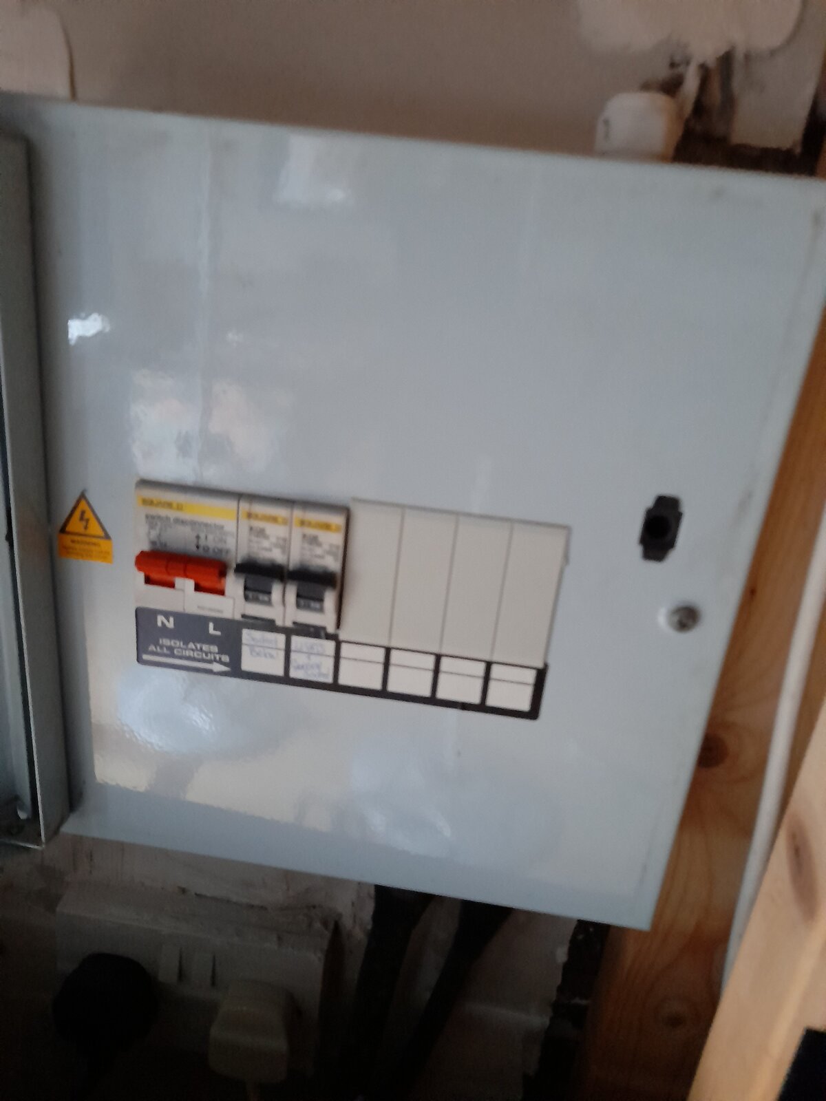

The garage has it's own fuse box. Last weekend, we had rather a lot running off the garage plugs (outdoor heaters, sound system).
The power suddenly went off in the garage. Both the lighting and the plugs (2 sepearte circuit breakers in the garage fuse box).
Nothing tripped. No burning smell or anything. Tried resetting by turning the power off and on
The question 'Oldbutnotdead' was asking: Have you had anything tested since the fail?
Garage fuse board. Swapped over the un used one in the main fb but nothing still

So. You need a multimeter at the very least to determine where the fault is. A voltstick or neon screwdriver isn't suitable for proving dead, nor are they particularly useful for faultfinding (if a neutral has gone astray you'll get some very odd indications).
When testing, assume everything is live (and thus hazardous if touched) until you have PROVED with a known good test device using a PROVED good earth that it is in fact not live.
Ok, nothing obvious in the garage then.
As said, you need a 2 probe voltage tester, which will tell you which parts of the wiring have 230v, and which parts don't have 230v.
Do you think there may be a switch or isolator somewhere between the house consumer unit and the garage consumer unit?

If you feel you can safely test, where the power leaves the house at the MCB serving the Garage would be the first point. Then where it enters/terminated in the garage. Can you report back you findings with a few pics? May be something simple like a loose connection.
As @chivers67 . You were running a fairly heavy electrical load (the heaters). It was fine for a while then it stopped working- which indicates something in the circuit was overloaded, got hot and failed. So you need to test the circuit, starting from the house. Your voltstick could give you a guide- if it is still glowing at the garage end of the cable then you have a neutral fault somewhere.
