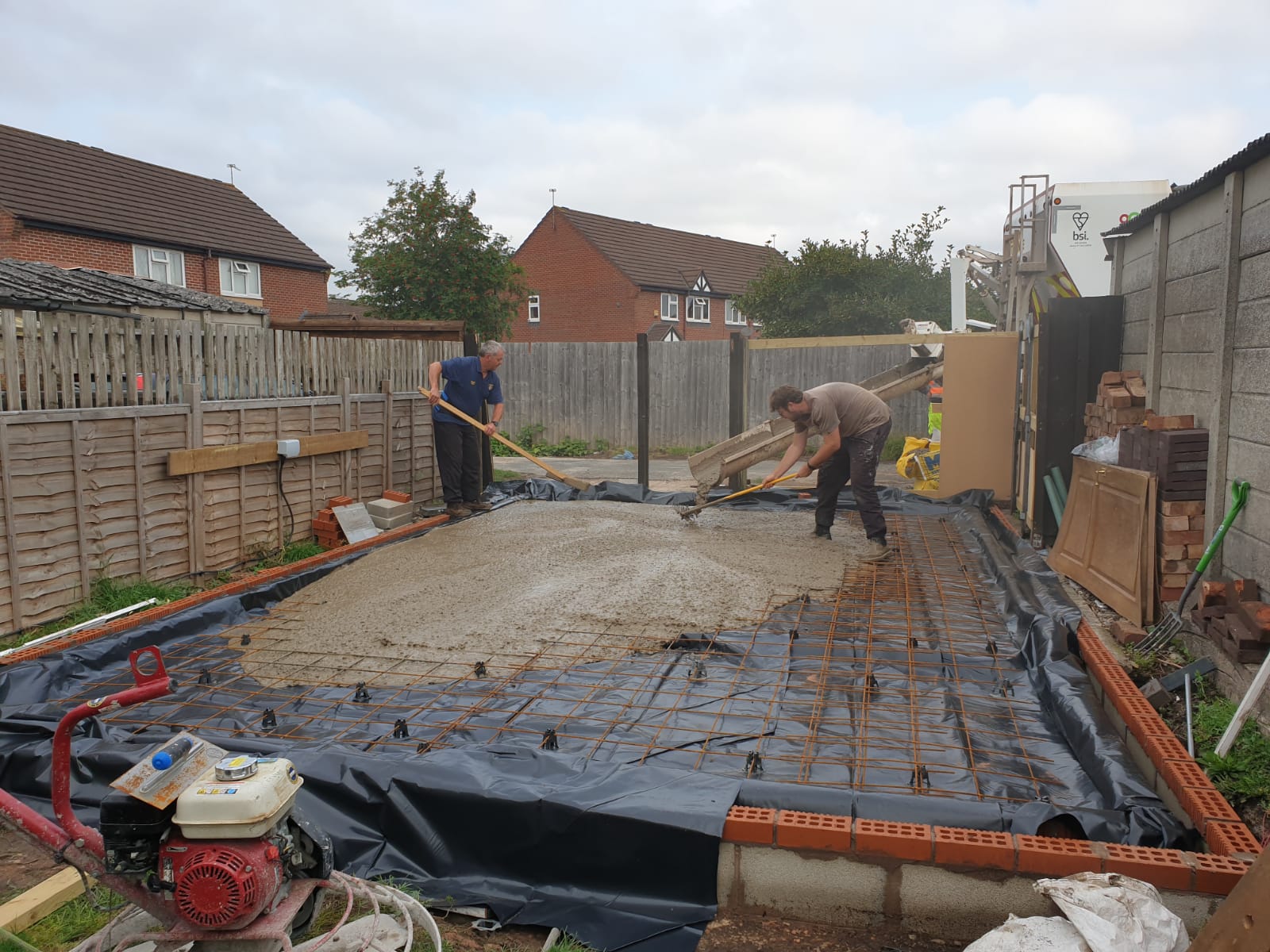

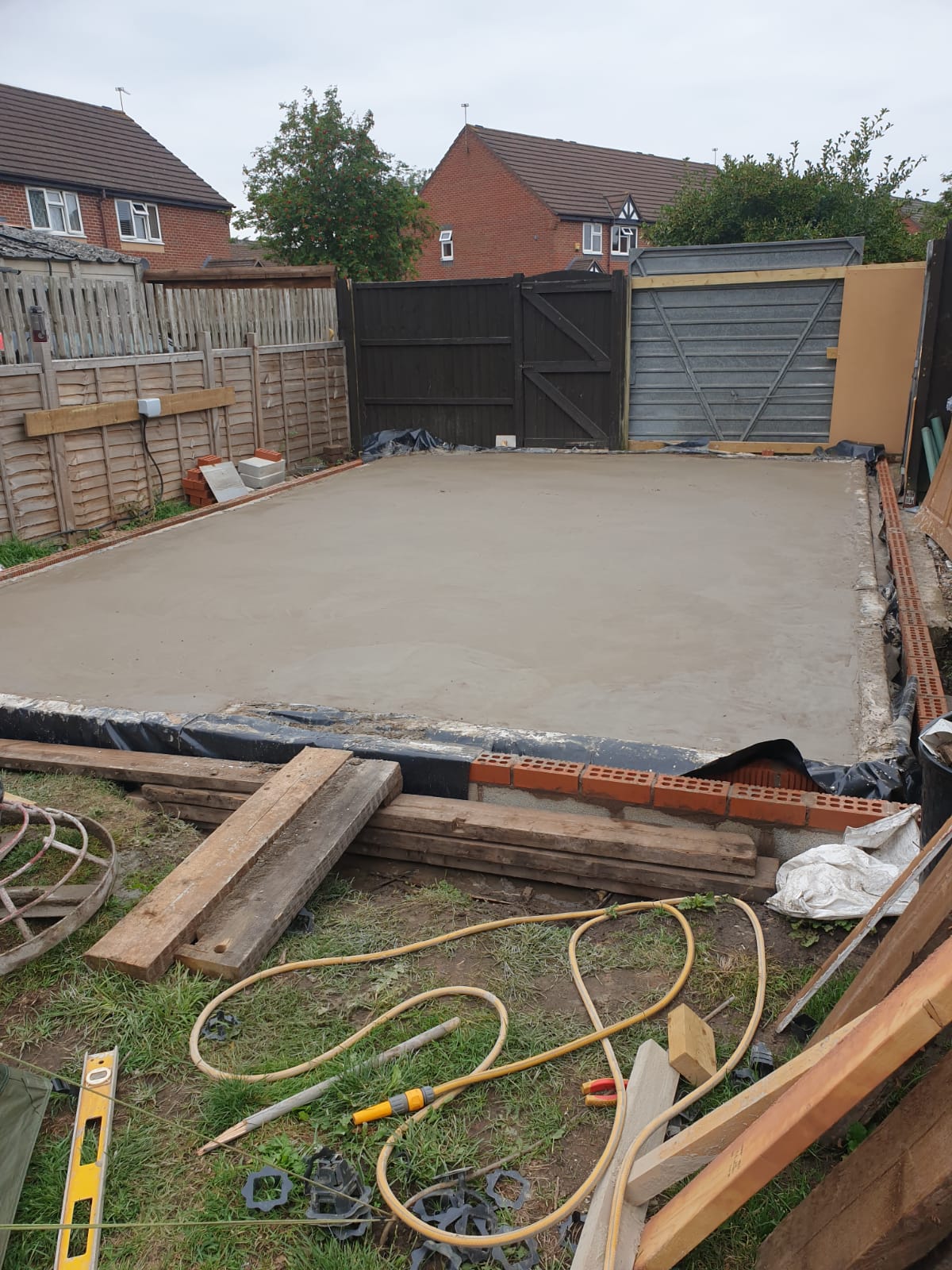

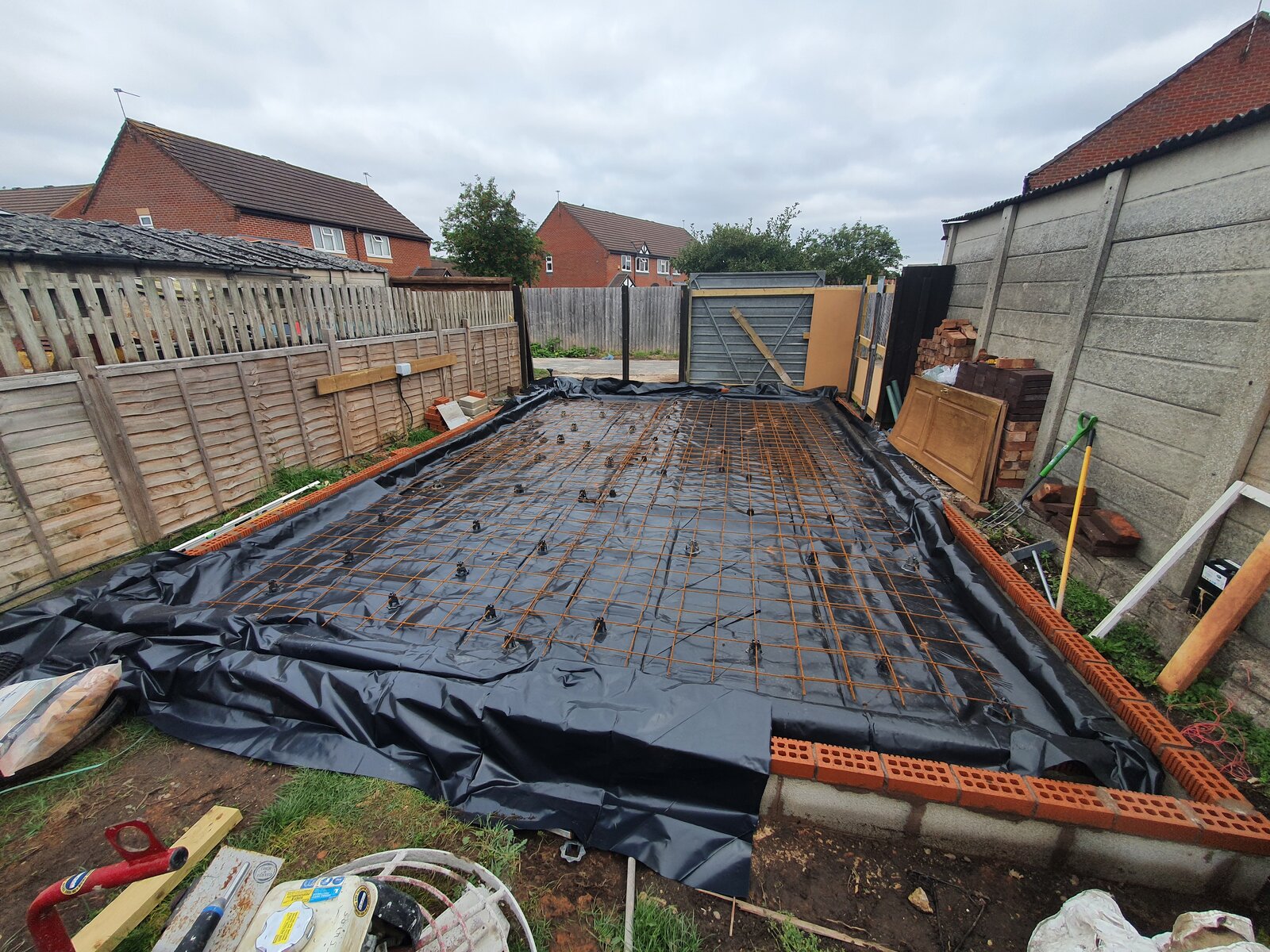

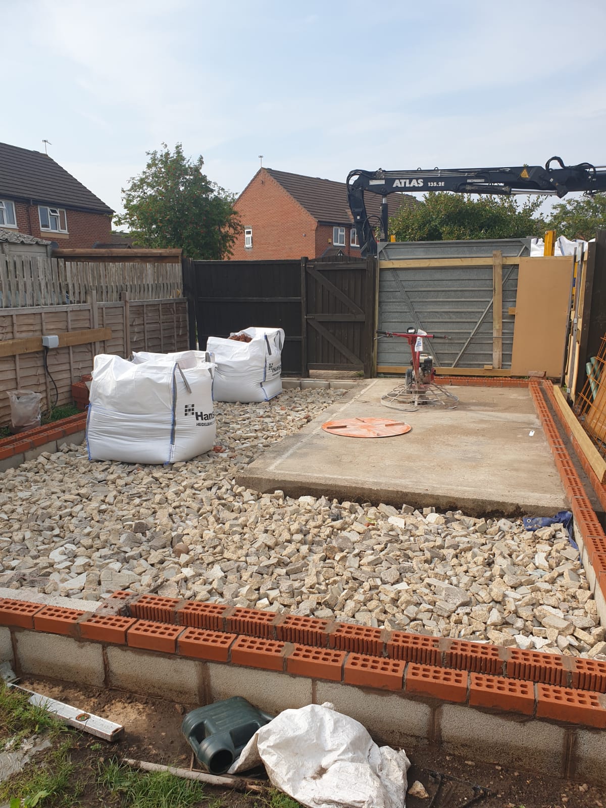

Thought I'd post an update. All steaming ahead to get slab poured Saturday. Breaking up the old concrete garage certainly gave the SDS a workout. Decided to reduce the size to avoid BC
Just thought I'd post an update
For those wondering so far including mini digger and driver, muck away, tool hire, all materials and running electrics down to the site for the build and the eventual building the spend so far is just over £2000 to get it to how it looks now.

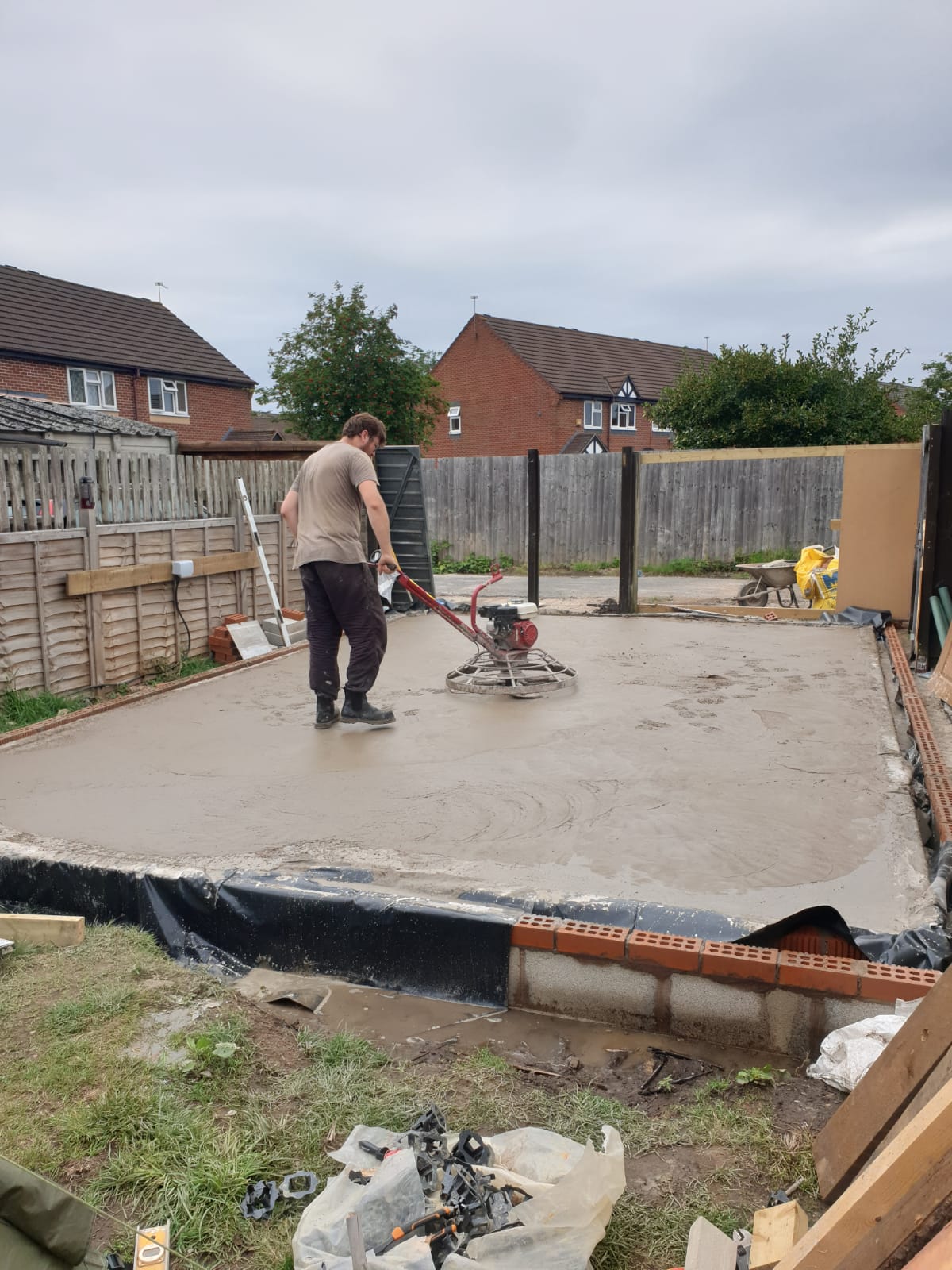

Was an experience using the power float, managed a reasonably smooth surface but a few peaks and dips to the level... not 100% happy so might put down some self leveler before the resin floor paint once the building is watertight
I didn't get a photo but there is approx 2.5 tonnes of soft sand on that rubble before the DPM was fitted.
I was going to ask how you got on with the power float? I ended up just using hand float (big blue) for mine - was very tough going but is pretty smooth.
I also used about 3 times as many plastic spacers as you, and they still gave up once the concrete was barrowed onto them :eek:

That might be where you went wrong as you're able to stand in between the spacers and the mesh just bends then springs back.
I'm certainly glad i can get the lorry right to the site as with it being 4.5m3 for the slab... meaning approx 11 tonnes+ when wet!
The garage is kind of a prequel to a possible kitchen extension and for that I cannot get the lorry to site so i'd seriously consider a pumping truck.

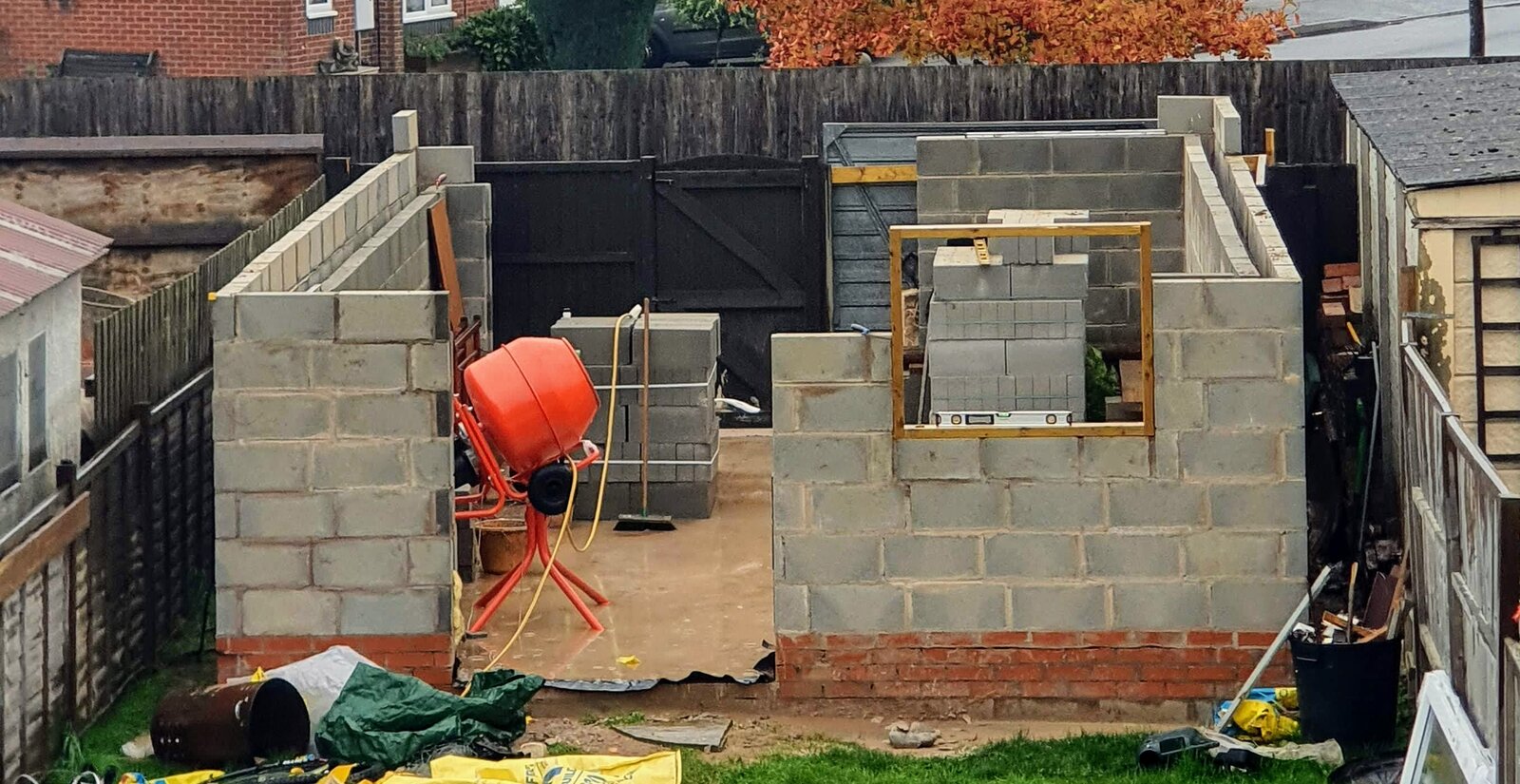

Progress update, walls are going up slowly. Did consider paying someone to throw the blockwork up but I had quotes for between £2-4k for labour only for approx 1000 blocks
Planning permission is really dragging its heels with an original deadline of the 22nd of October we have settled on the 5th of November the planning office of course blamed covid
Current spend including french door and a window and all 3 catnic lintels is just over £4500
Not fully priced out roof yet but looking to be circa £1500 including tiles
Electric roller is about £700
Then around £1000 on the internal fit out, electrics and boarding out means I should come in just over budget of around £7,700

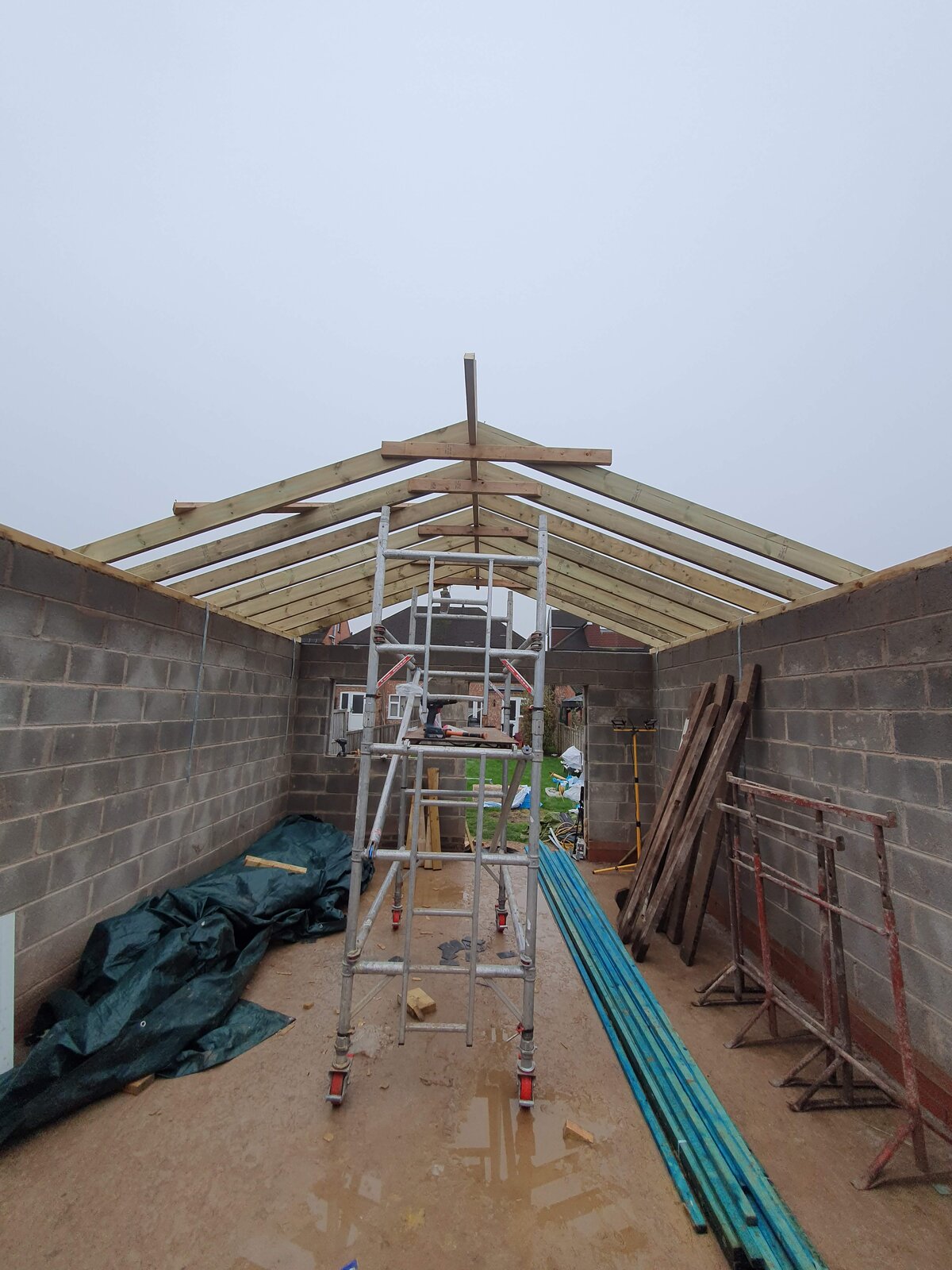

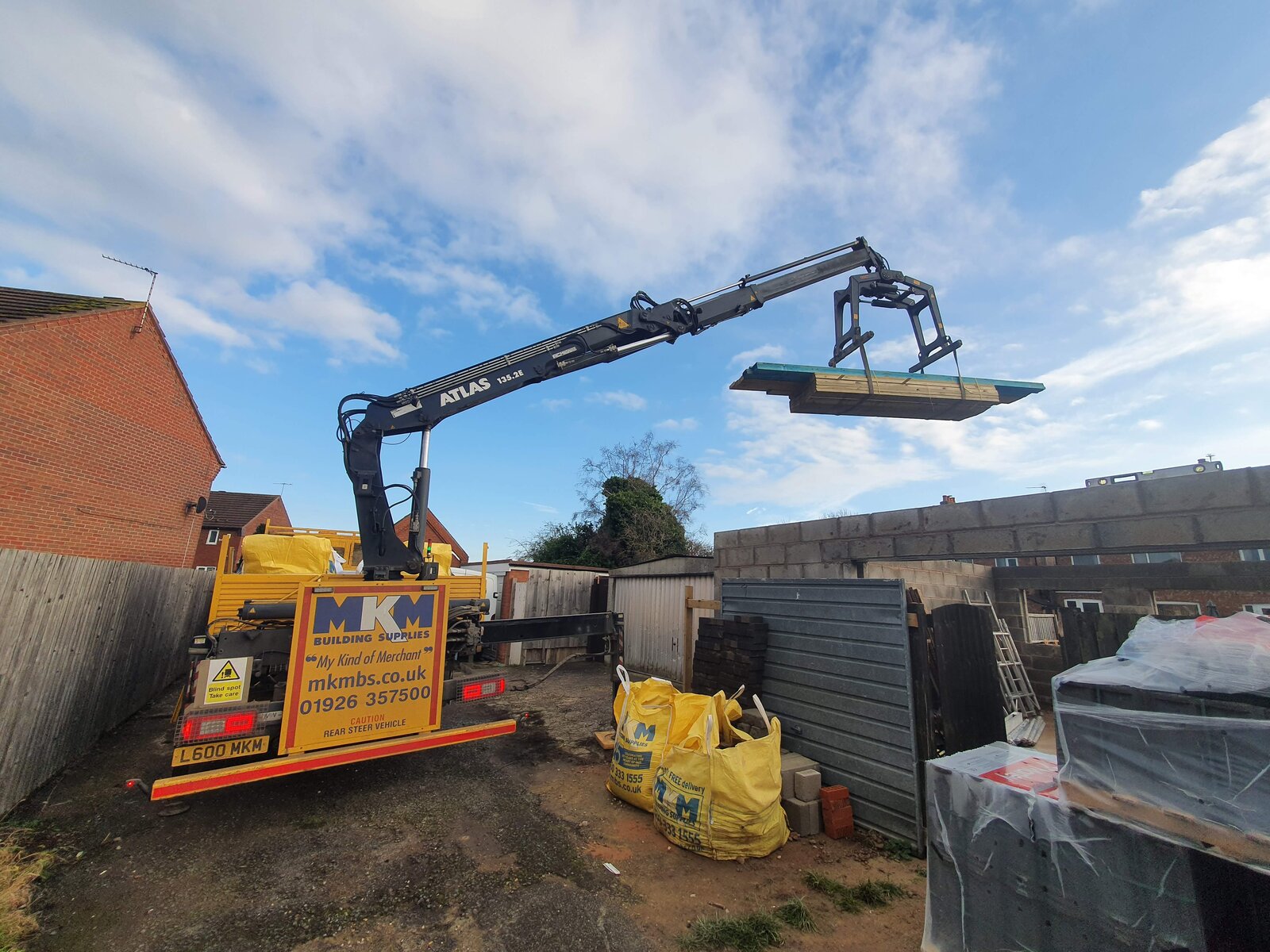

The build has progressed
one flat pack roof with no instructions
Roof after day one
Day 2 we have a roof structure :)

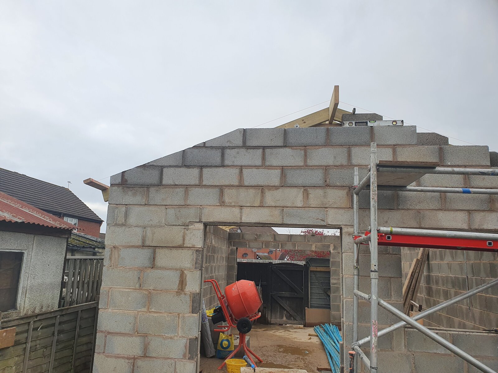

Slow going gables, Looking less forward to the other one as access for the tower is blocked by materials
You'll be in for Christmas matey :)
Making good progress by the looks of it. It always amazes me how strong those hiabs cranes can reach, and how the drivers can drop their gear on a sixpence!
