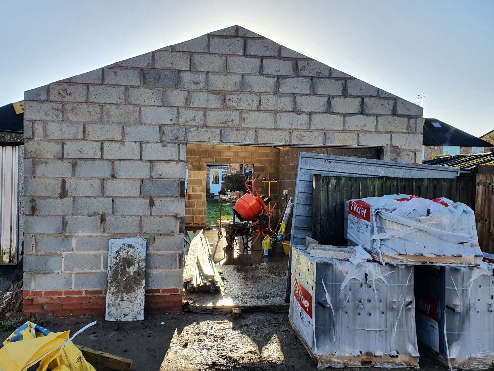

Garage Self Build
You'll be in for Christmas matey :)

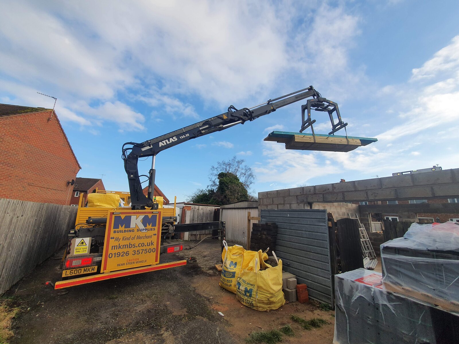

Making good progress by the looks of it. It always amazes me how strong those hiabs cranes can reach, and how the drivers can drop their gear on a sixpence!
They are impressive beasts although working in servo hydraulics their control seems very crude compared to what i'm used to! (link here if you're curious what i'm upto when i'm not laying blocks!
From my experience hydraulics always win when something gets in the way.

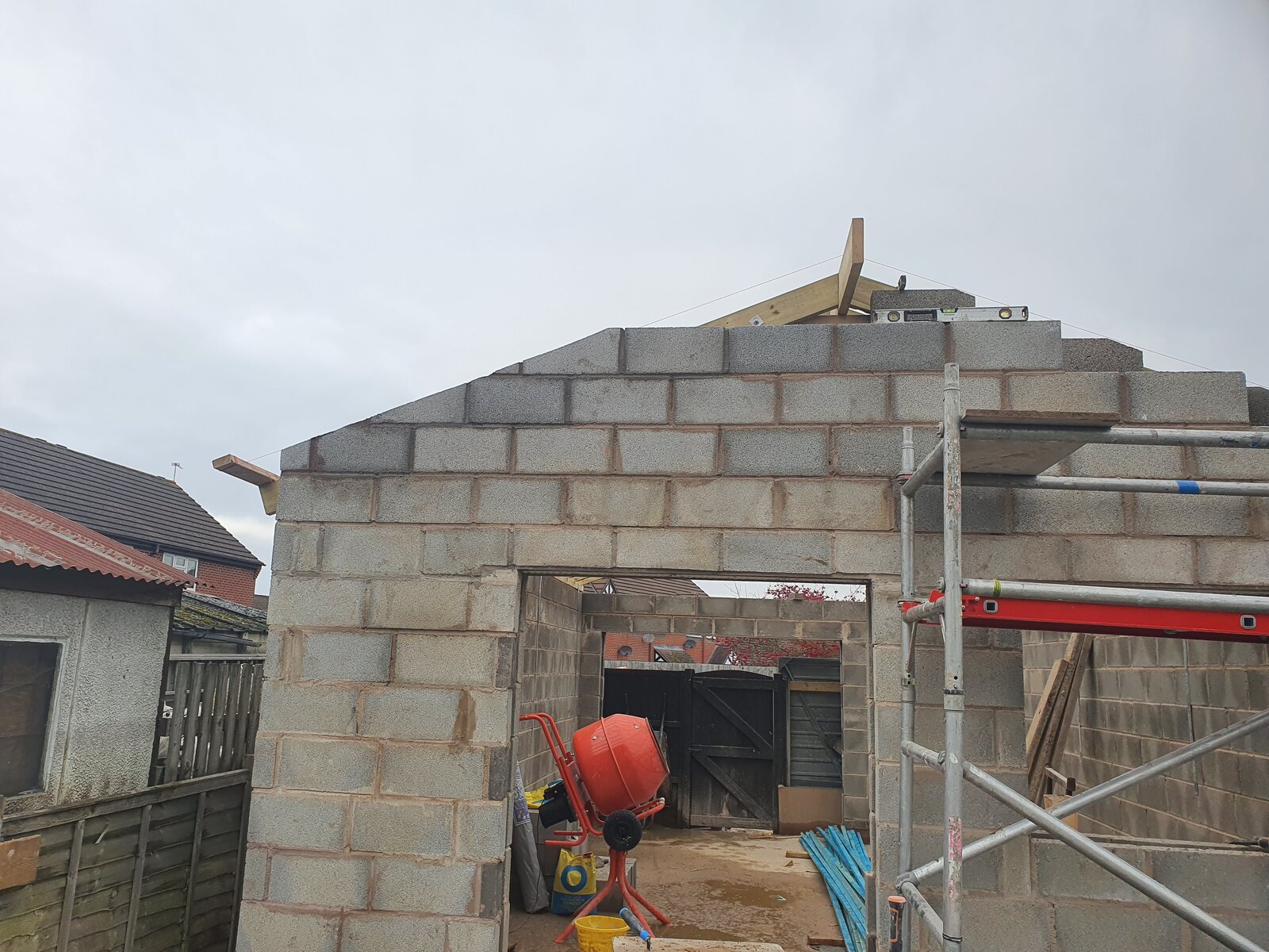

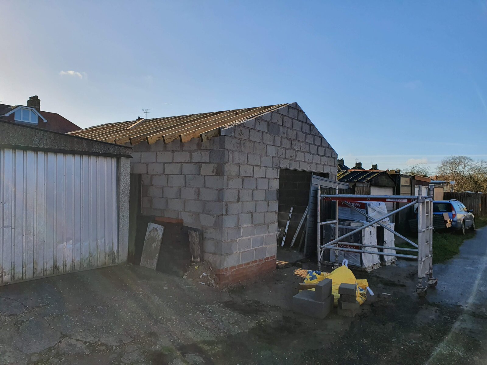

And here we are another 2 weeks later
Excuse the mess, really cannot wait to get the roof on working in the dark in december is no fun!

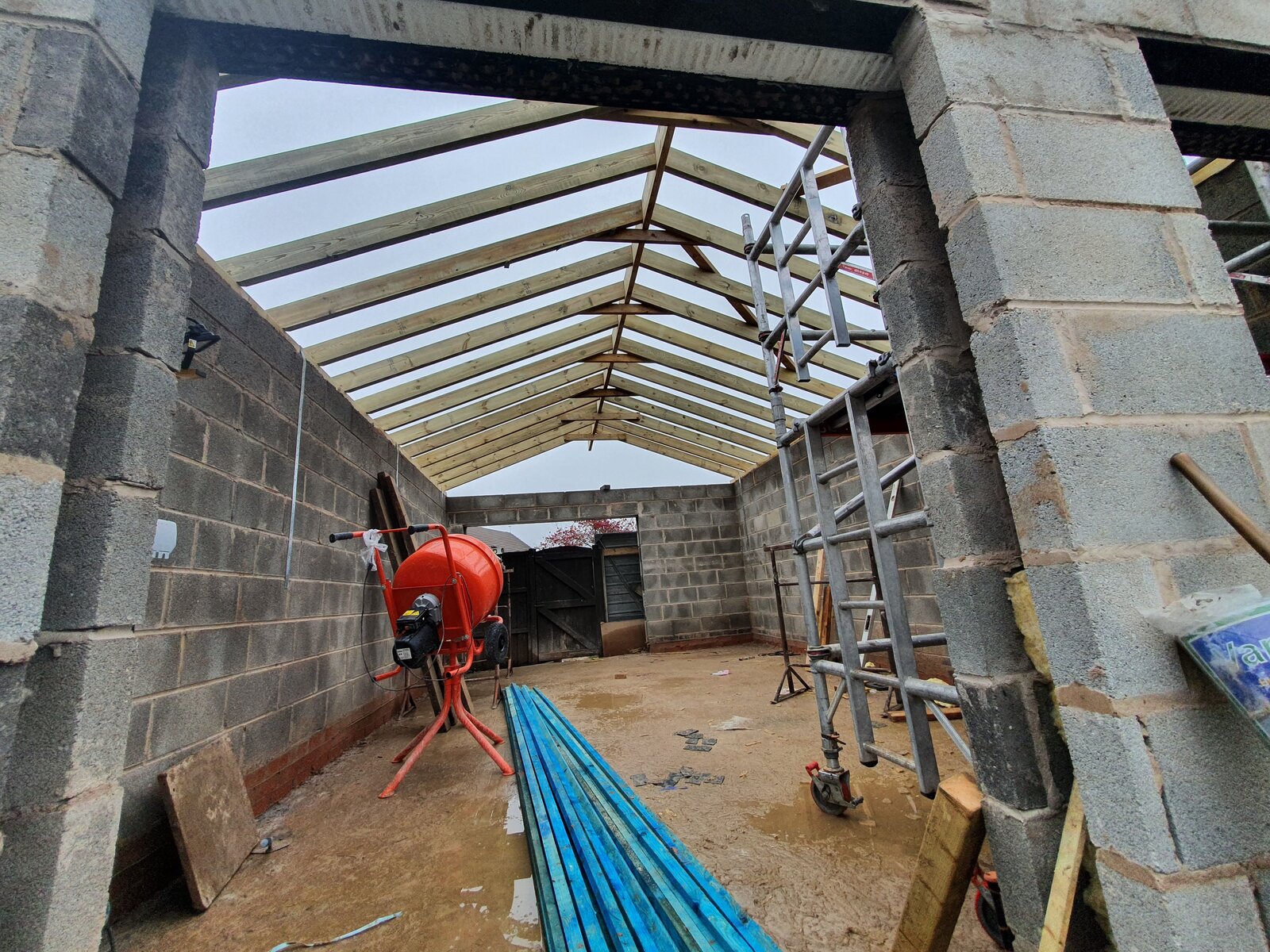

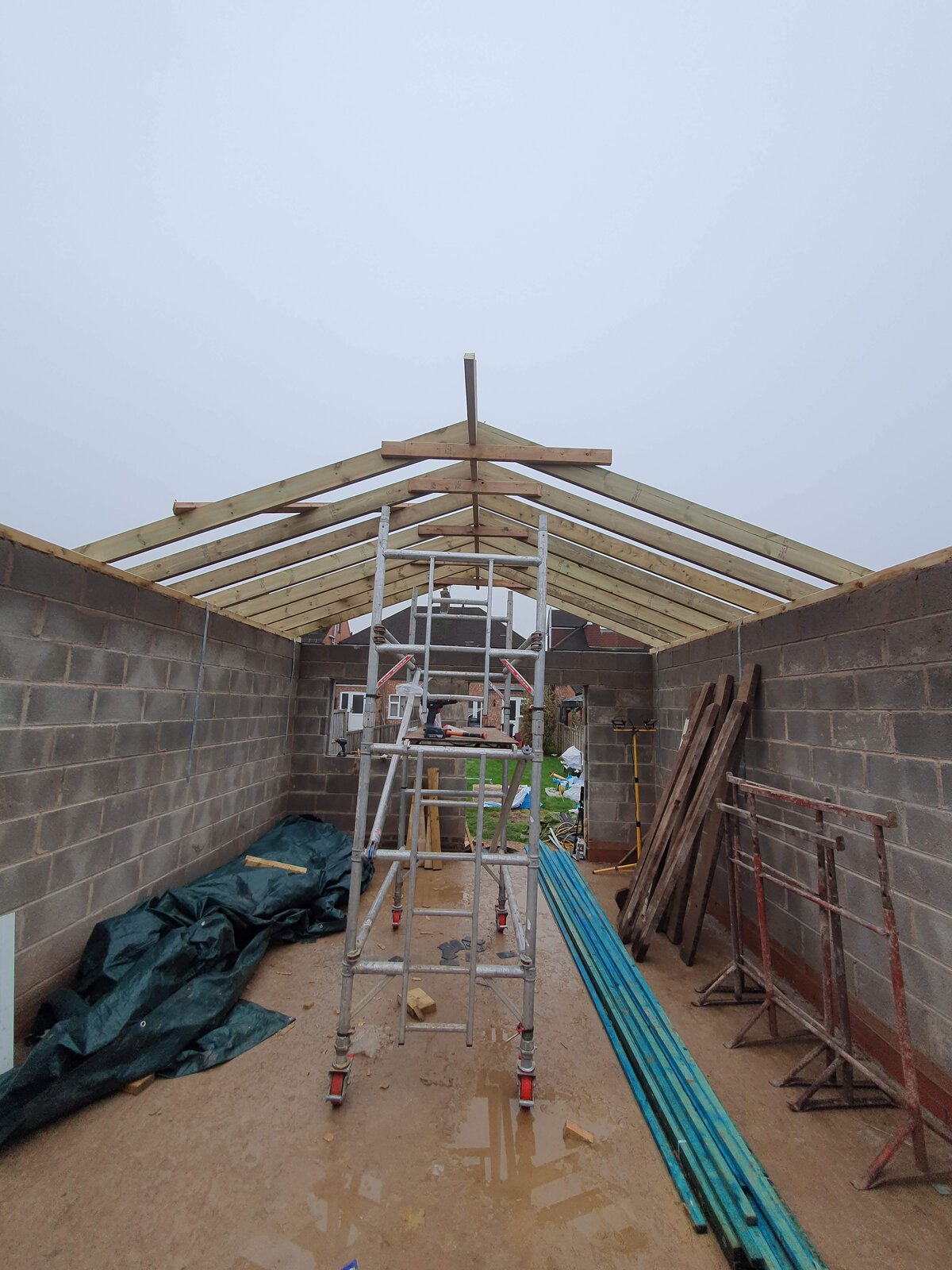

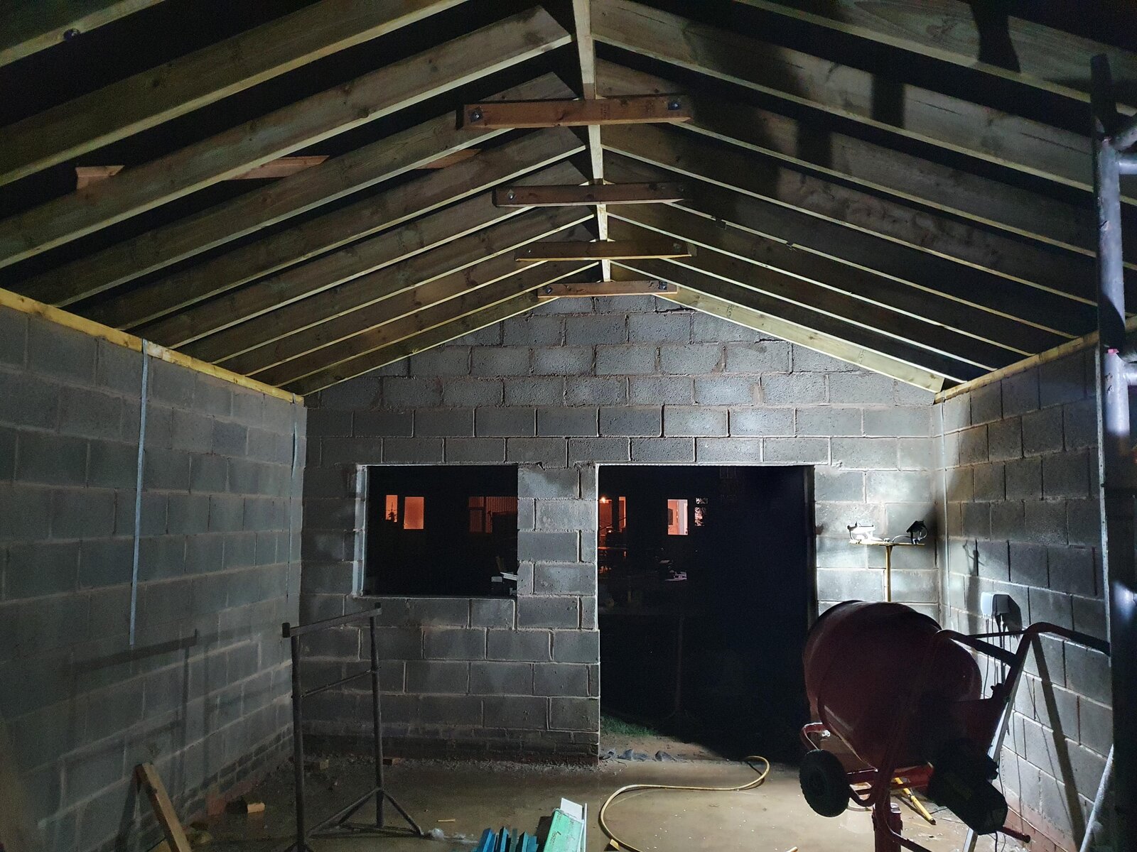

Nice build. Can I ask what's stopping your roof spreading? Is there a hidden ridge beam or have you just not fitted the ceiling joists yet?
The wall plate straps and the 150mm concrete screws holding the wall plate in place. Also just under the ridge at alternative rafters there is a brace that is bolted in position with dogtooth washers and m12 bolts. Also the ridge beam rests on the internal walls at both ends.
But there will be no ceiling joists I quite like the lofty vaulted ceilings...
My partners uncle helped me construct the roof hes now a site manager but his trade is a chippy he also asked his truss supplier to do some quick calculations for sizing the timbers. (for reference the rafters are 150x50 and the ridge is 200x50 both C24) (TR26 was took expensive and the calculations revealed unnecessary).
I just hope its right as the tiles are 2 tonnes+

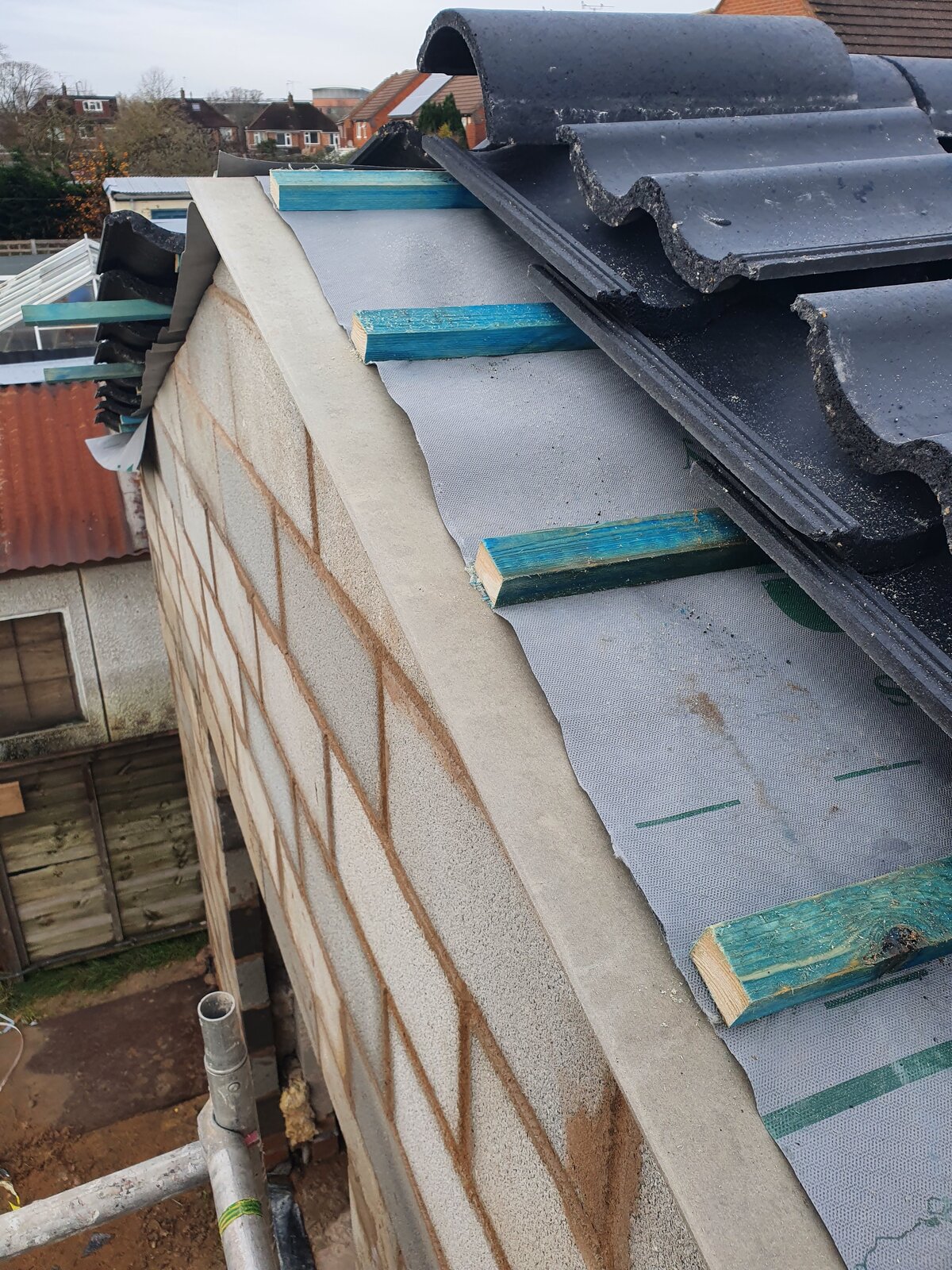

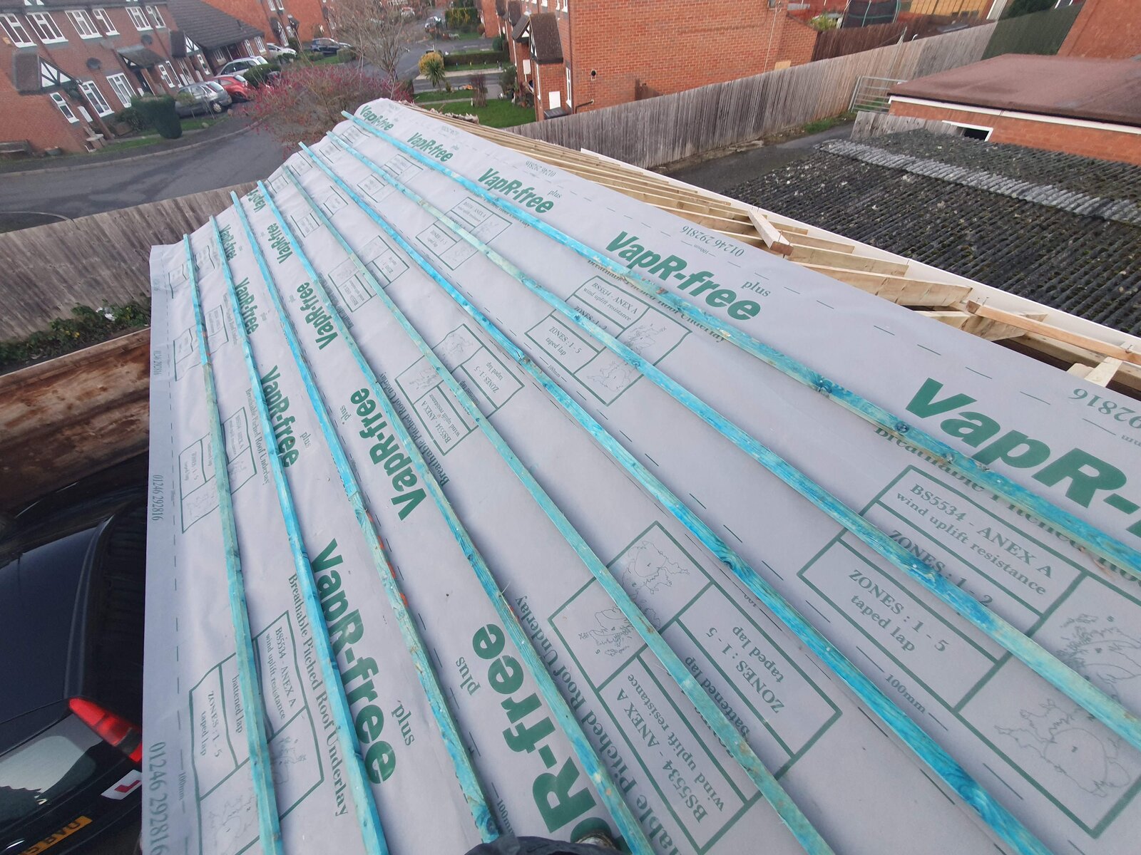

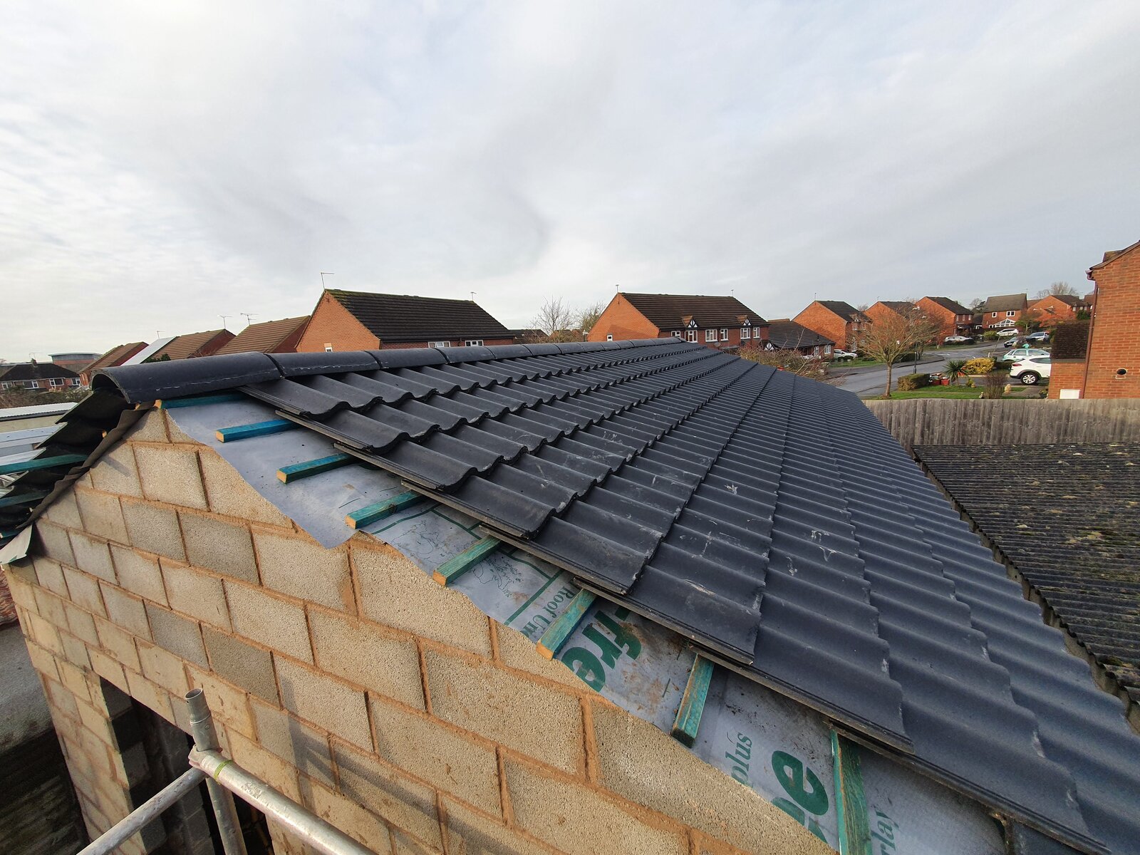

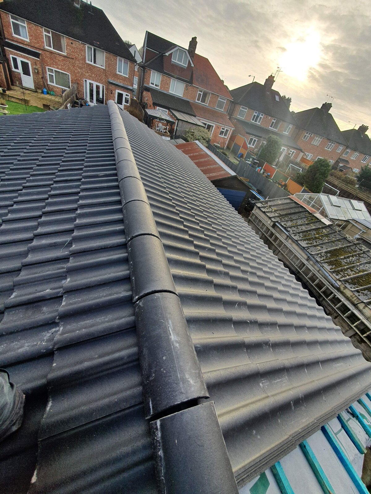

Due to covid we couldn't go anywhere or see anyone so I used the time to get some tiles on the roof (Nearly all 450 of them!)
really tested my fear of heights doing this!

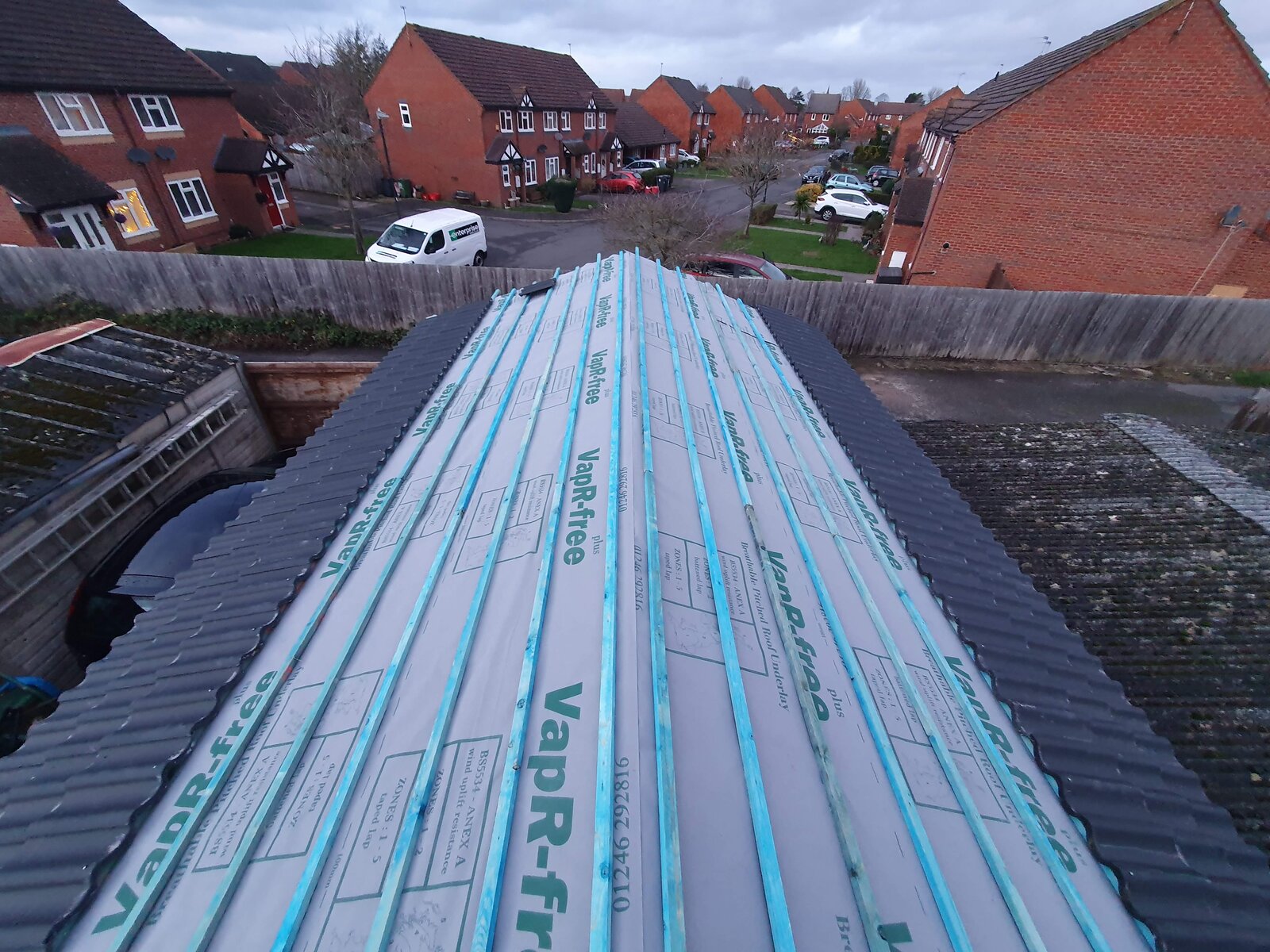

Top tip - Remove the protective tape before you nail on the facia

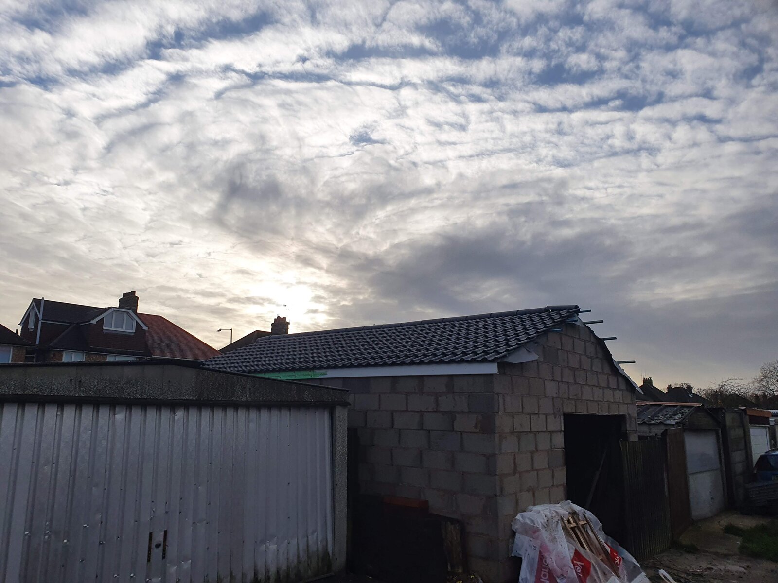

undercloaking fitted and battens and felt trimmed, just need to cut tiles now then mortar them in place along with ridge tiles
Personally, and I don't know what others think, but I would install some joists across the garage fixed to the bottom of the rafters to prevent potential roof spread, which looks to me like a risk. That's a shallow pitch roof and the outward forces are therefore going to be considerable when the roof is loaded. I don't think those short collars bolted high up are going to help much. I'm not a SE, but have a technical background, and it doesn't look right as is to me.
