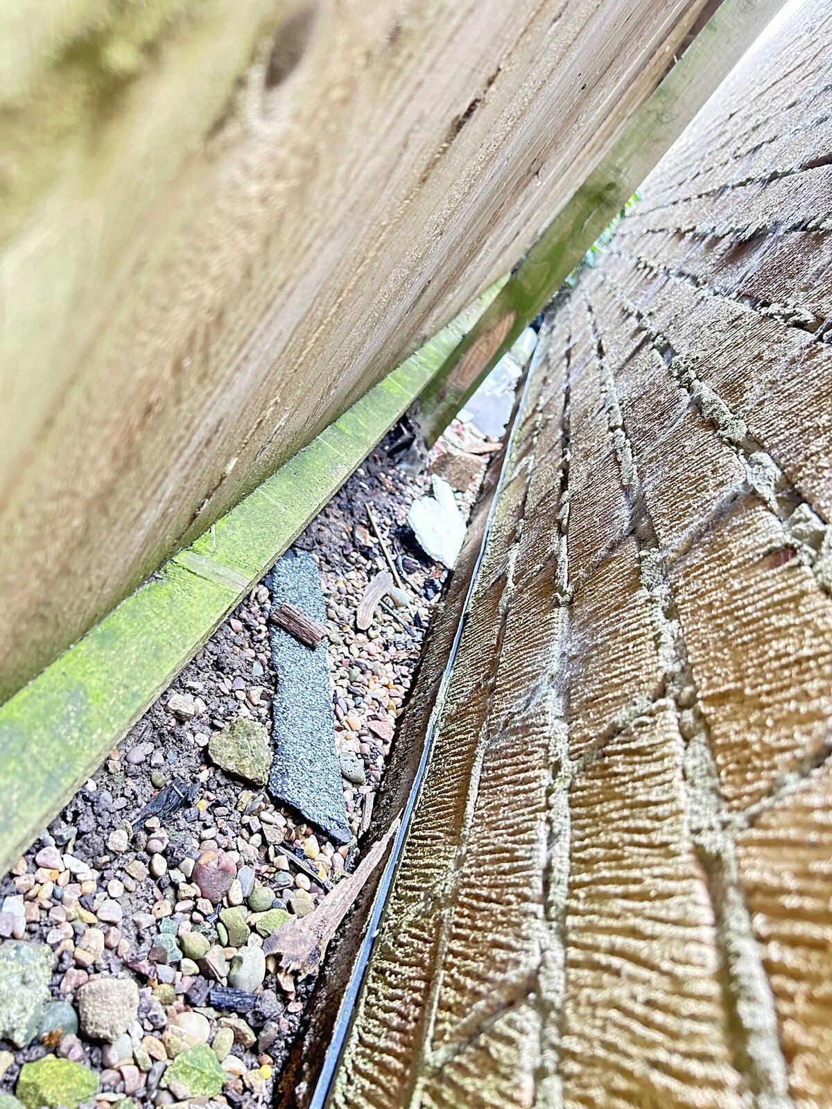

My detached garage has water coming in at ground level, I think that I have fixed the rear wall by digging a trench and dropping the ground level but the 7M long side wall has soil and debris about 2-3" above ground level. I have no access to clear this area as I did with the back of the garage as my neighbour has built a fence leaving only a 15cm gap so I have no space to work.
I an wanting to get this sorted in a dry spell in the coming weeks so wanted to know how practical it would be to knock down the side wall and move it 30-50cm inwards to give me access to dig it out. I would then replace it with a dwarf wall of brick and a timber side wall on top.
Has anyone done this themselves, I can only find the odd youtube video on it so any advice would be much appreciated.
What kind of fence has your neighbour built as lap panels or other fence styles set between concrete posts can be lifted upwards and if your neighbour is the reasonable sort he/she may assist. A photo or two would help people give clearer advice.
Thanks DAZB, a few pictures as follows.
Its not a cheap shiplap fence, traditional fence boards against posts cemented in. Its also brand new so less inclined to have me remove bits of it. To be fair its a nice fence, just in a bad location for me.

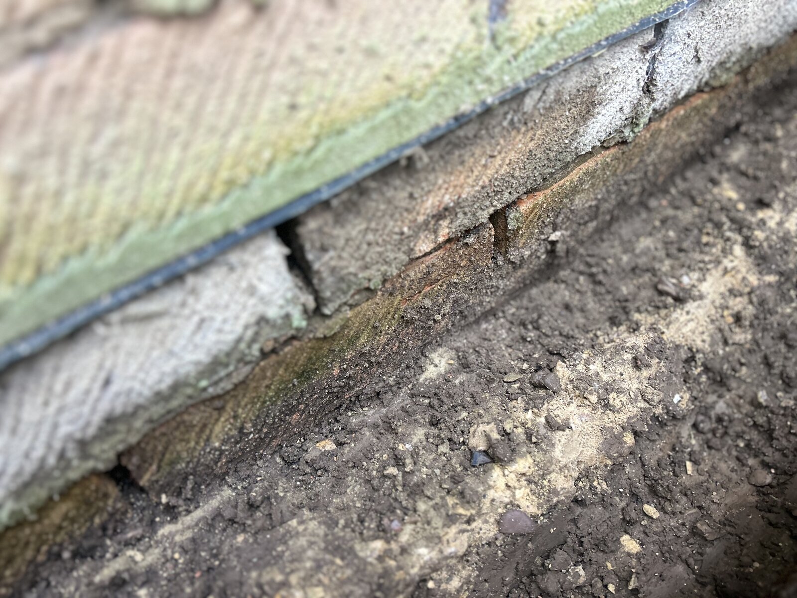

Dirt and stone is 1.5 bricks deep.

Why not talk to your neighbour and see if they would allow you to remove the fence enabling access? Then reinstate.
This is for maintenance and your neighbour can’t really stop you
Plus one for the "rake" approach. Presumably you can get on the roof and break it up from above with a long pole, something like a scaffold tube with a flattened end. It could be adapted for dragging the spoil back with a partner pulling a rope attached to the bottom end.

Thanks all, turns out I was in luck and the neighbours allowed me to take the fence down while they are away for a week.
Half way along the wall but the bottom 1.5 bricks was covered by thick mud. Looking at the mortar gaps its not really a surprise that I had water getting in.
I plan to clear the second half out, wash it all clean with a hose and run an angled mortar filet along the entire base. Not much space for a trench of any kind but I got maybe 6" out with a trowel.

I'm sure blackjack / tanking will help but you dont want to raise the outside unless there is a good drainage path. Ideally, break out some concrete and lay either a gutter or half round pipe with a slight fall which is below the lower course of bricks with a mortar bench so water cant get trapped in the area. When the pipe / gutter has filled with krud in the future a drop scraper can easily be used to clear it from the end. Putting in a fillet is unlikely to work if there is standing water.
Just power wash, leave it to dry then point it. Leave it to breathe. Any sort of waterproofing is more likely to seal water in than out. Water will be constantly wicking up from the ground, if you stop it evaporating to the outside then the only route will be to the inside.

There will always be damp in the bricks but I expect the issue is water seeping though the wall and ponding (albeit slightly) on the inside and not moisture wicking up the bricks. Experienced this with a conservatory where the base course of bricks were set on the patio – same level inside and out. Not a massive puddle but a visible wet patch noticeable on the dry (inside) concrete floor.
Getting it all cleaned up is first step (also good to get the pointing done). If the garage floor is above the top of the concrete outside this is likely to sort it (until the muck builds up again), but if a small puddle can form next to the wall it is likely to work its way through and you need to eliminate any water puddling adjacent to the bricks.
Putting a fillet in may help initially (until water finds its way through the fillet). However, I would also consider a sloping render (screed) on top of the concrete outside so that water cis unable to pond on the concrete – I assume your neighbour hasnt a concrete path that traps the water.
Key is avoiding any standing water adjacent to the bricks.
. . . . and just a thought that you dont have a drip from the garage roof, which saturates the wall and results in water draining out of the bricks on the inside.
The problem with any barrier of any sort (fillet, render or waterproof paint), is that none of them are one-way - all are just as capable of trapping water in as out. The only possible exception is a waterproofing cream paint, which allegedly allow vapour to evaporate - in reality I'd assume that they do at least reduce the evaporation.
If you put a fillet in then yes it will push anything landing on top of it outwards. But that dribble coming down a perp joint is likely to get behind it and be pushed into the wall and is physically prevented from flowing outwards.
We had a rendered skirting from just above the DPC to the ground at our last house. Total nightmare, it had peeled away at the top so I had to botch some sealant in. It was always wet behind it though, as the wicking groundwater had nowhere to go.
Definitely point it and clean. A land drain would be a very good idea. If the concrete foundation has any protruding blobs that might hold water against the wall then chip them off. I'd be inclined to skim with an SDS chisel along the whole lot to give an outward sloping surface.
