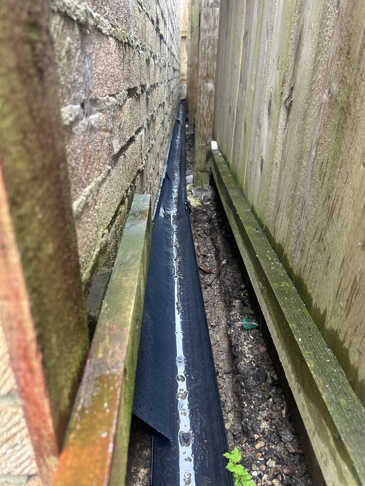

To clarify - water was pooling on the inside of the garage to the point that the kids could splash in the puddle. While it kept them amused I was a bit fed up.

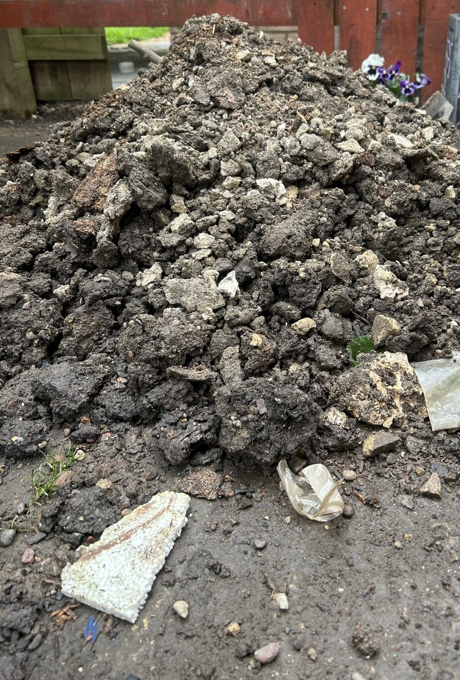

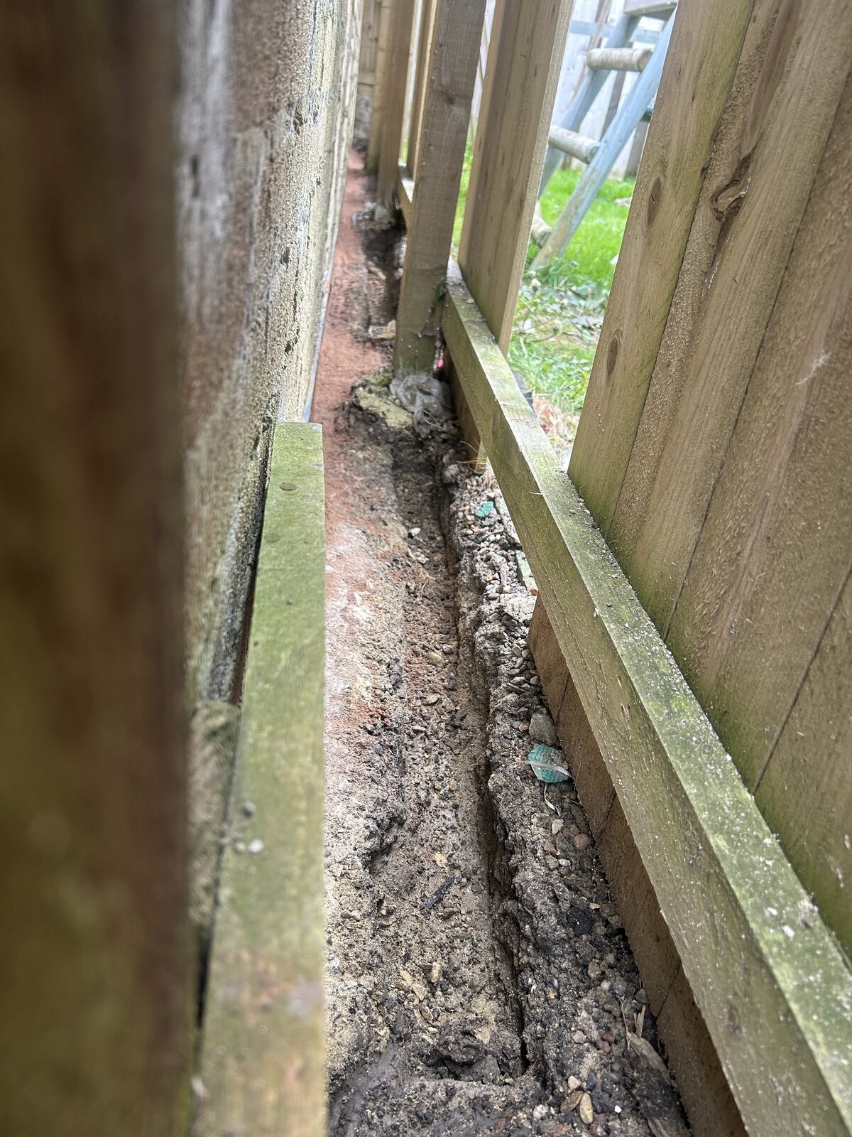

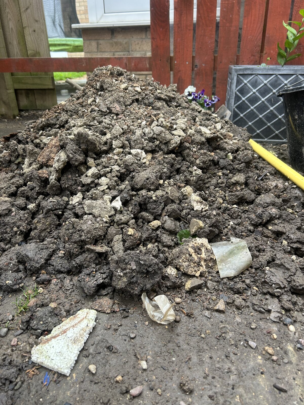

I had only had four days to take the fence down carefully, do whatever work I could and get the fence back up as agreed.
Ended up digging out any excess dirt that I could access, surprised by the amount that came from a 6"x6" space). Bottom two courses of bricks are no longer below ground level.
There was no space for a proper land drain as the concrete support for the neighbours fence posts was in the way.
Sorted the pointing out on bottom few courses of bricks, chipping away any dodgy bits of the slab that would direct water back towards the wall and as a last resort I ran a length of DPC along the existing material and had it fall into a gutter I setup at ground level.
Made the best of what I could in the limited time available.
I know the pictures don't show much but they are there as my suggestion if anyone has similar issues with limited time & budget. Seems to have worked well enough over the last very wet weekend. Next onto the roof which is truly on its last legs with a hole appearing in the felt over the last week.

Great job for summarising what you did. Usually, the outcome is unknown and very useful for others that come across the post to appreciate the issues. Fingers crossed that the fix continues to work.
