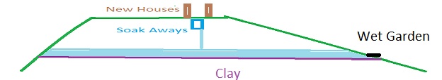

I've dug quite a few big holes which are now completely full of water, ive dug a hole up the top of the garden but there is no water, it seems that the water is coming through the side of the garden rather than the top... which is weird as the gardens next door don't really have any water?!?
There has been new houses built at the top of my road about a year ago which is when the water had got worse, although there is 6 houses without any water in the garden closer to the new builds which is strange!
if your house is on sloping ground there may be a layer of impervious clay which is trapping water and your garden is just above that layer while the next door gardens are higher than the clay
That would make quite alot of sense thanks for that Bernard. Any ideas what i could i do about that?
Have a word with the local council. explain that this problem has occured since the new houses were built. Ask if these houses do have soak aways for their surface water. Ask if the new soak aways are enabling rain water to get to the aquifer in a flash flow instead of the slower percolation that would have been happening before houses were built.
If they agree that it is possible then ask them for help in resolving a problem that seems most likely caused ( or increased ) by the houses that the council gave permision for and ( probably) insisted on soak aways being used.
Two options (1) the council agree to your garden draining into a surface water drain or (2) the council install means to remove surface water from the new houses and close off the soak aways.

I asked about the development because houses being built even at the end of the street can have a strange but severe impact on the passage of ground water.
They may have interrupted the flow of a free draining layer of ground etc or diverted ground water towards you inadvertantly. I doubt they have done anything wrong it can just be bad luck and ive seen it happen a few times.
Often the best technique is to put a deep land drain on the high side of your garden to intercept the water. You should seek permission or advice from the council regarding permission to drain this into the surface water drain.
