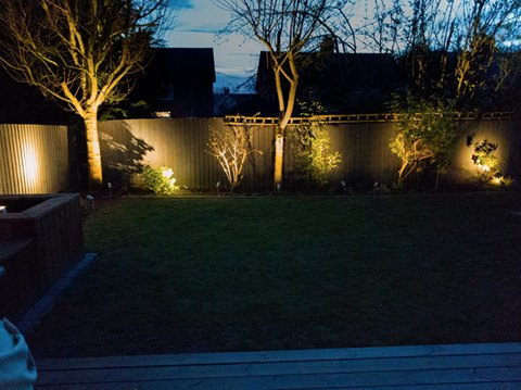

Finally got this all setup and power up. Looks great given the garden has no plants etc in it really.
The only issue is the sodding LED driver died after about an hour! It's a 60W driver which should be sufficient given I've only got 10 3.5W LEDS...
Does it have a minimum load?
What sort of driver is it?
Not as far as I'm aware. Its a 12V 5A, 60W driver.
I'm not sure on any more specifics that that as I haven't got it in front of me.
Looks like I'll be sourcing another one.
Anyone have any good suggestions? Ideally could do with one I can wire into a fused spur

It might be that 35W is too low a load.
One hears of flashing/flickering/instability in that situation - I've never heard of a supply permanently breaking because of it.
If you think about it, an ELV lighting supply could reasonably be expected to become under- or un-loaded due to lamp failure, so whilst shutting down would be acceptable in those scenarios, breaking would not be.
If it really has broken, Winston is almost right - return it, but not for a replacement - get a refund.

The light units themselves came with 5m tails, using 2 x 0.75mm cable. I have used the same cable throughout. There are then 10 3.5W MR16 LED bulbs in each unit.
The driver has some weight to it, I'd say probably heavier than the power bricks on laptops, but about 1/4 of the size. It's only a 60W unit.
The lights were on for a good few hours before it failed and showed no signs of flickering etc. I'm trying to find a replacement driver at the moment, however would prefer the unit to come with sheathed cable so that I can wire it back into my JB's as I currently have.
What do you mean by "sheathed cable"? What sort of cable have you been using outside, where/how is it installed, and is it protected from damage as the Wiring Regulations require?
Armoured cable is ran to the transformer, and then rubber 2 core from the transformer to the lights. What came with the transformer is the same. Essentially the same as "pond" cable but without the earth
