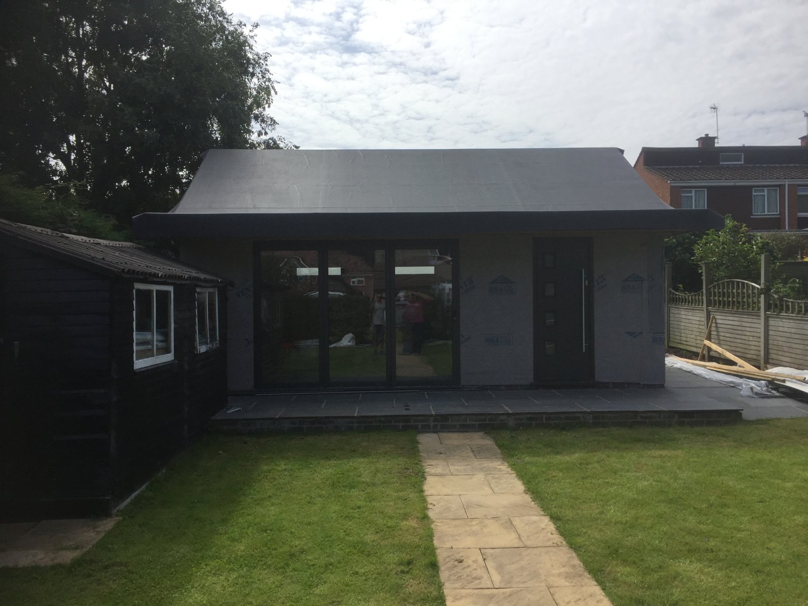

if you ever plan to be in it during the winter, I'd go timber frame/SIPS. I used 100mm celotex in walls and ceiling and 50mm + 100mm poly in the slab. I can heat mine 5m X 4m with a 1kw fan heater on for a few mins every hour. I wrapped and glad mine and used marine ply to reduce rot.

Final external size is going to be approx 9m by 4m. Walls will be timber frame and I plan to do a gable roof with a 4m high apex.
So I need base ideas.
I'm thinking concrete pads approx every 2m (600x 600 x600 deep) and then either a steel frame with timber floor joists in between or possibly block and beam with 50mm underneath for airflow.
I'm thinking steel and timber would be my best bet as I could insulate below finished floor where as block and beam would have to be above.
I need to keep the finished floor as low as possible for the 2.5m eaves and ideally I would like 2.1m high bi-folding doors.
Has anyone done anything or seen anything similar? or is this just a bad idea?
The plan is to leave a 2m path down the sides and around the back (2m from boundary) and come right upto the plumb tree, Hopefully without killing it.

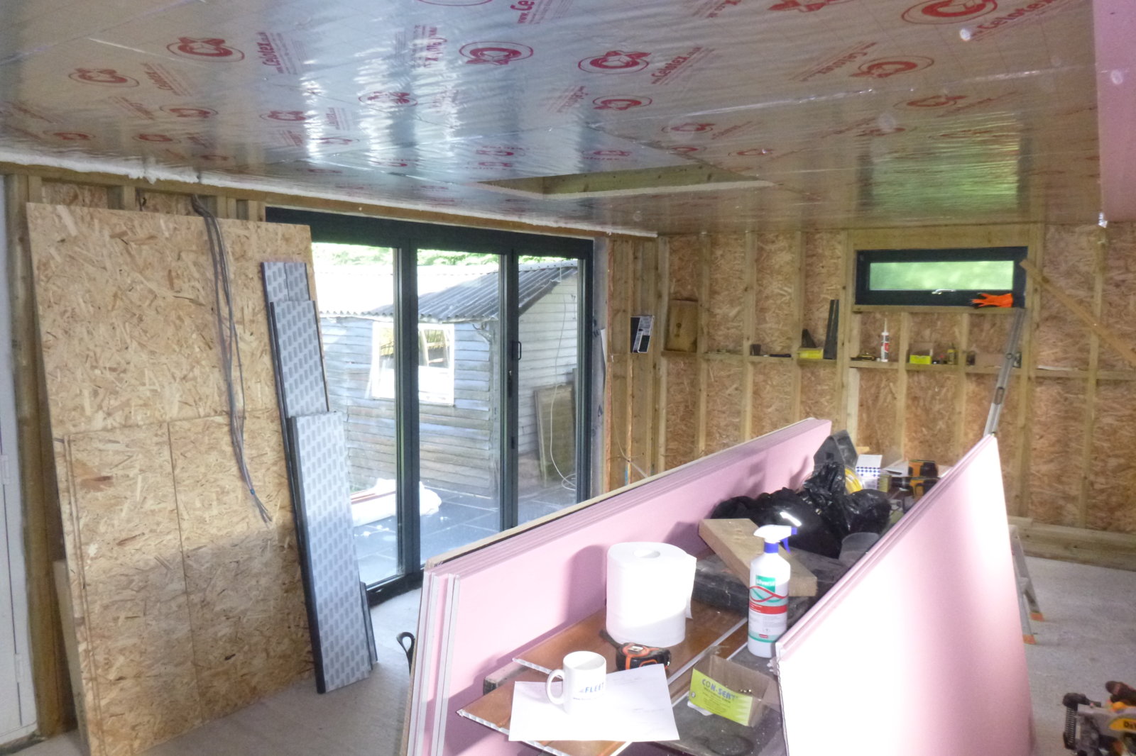

My shed is coming along and is water tight finally.
Questions about insulation?
I am leaving the roof for now. Will insulate it at a later date using up offcuts from jobs.
Ceiling I have used 25mm celotex (tuck taped) and 15mm pink plasterboard under the joists and I will fill between the joists with wool insulation and then board over.
Just need to decide on the walls.
150mm timber studs OSB and breather membrane outside (to be battened out and cladded).
Inside I will vapor barrier and finish off with 10mm insulation backed plasterboard.
What should I do between the studs?
1. Full fill with ridged insulation?
2. Partially fill with ridged insulation (100 or 120mm)
3. Full fill with wool insulation? Cheapest and easiest option but is the U value alot lower than rigid?
I am going to partition out an office in here so would like it to be nice and warm
