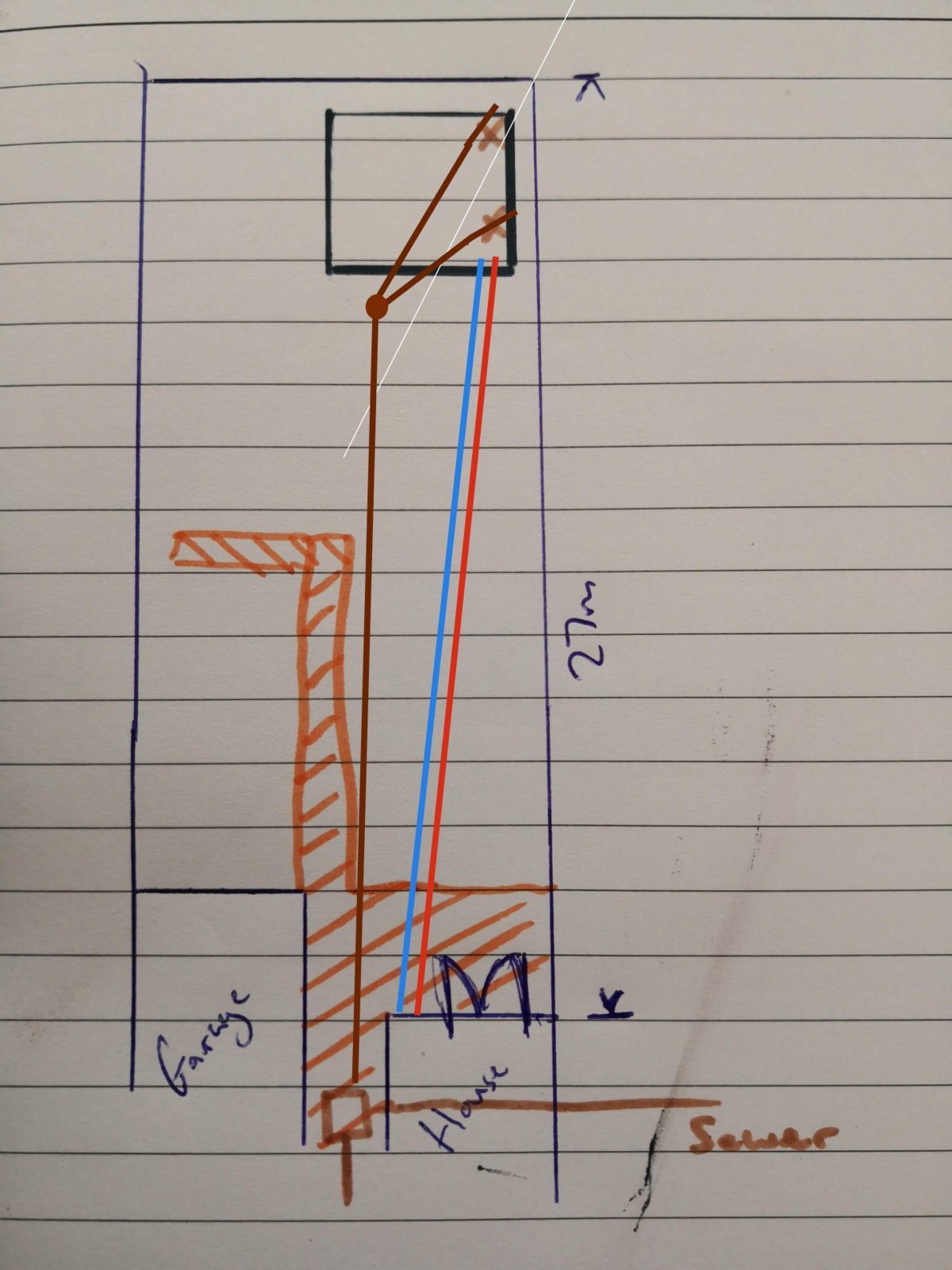

So as I've mentioned here, I'm currently planning a Garden Office build at the end of our 30m garden.
The building will contain a small kitchenette, for tea's/coffee's etc and a small cloakroom with hand basin, so pretty minimal requirements.
I'm now at the point where I need to start laying in the water and waste services, plus electric and internet, but they're not what I'm after some advice with here :)
Water:
So currently, the nearest point I could access the mains water is a 15mm copper feed behind our washing machine, which is ~27 meters from where I want the feed to enter the office.
My initial thought was to go with MDPE, however the smallest I can seem to find is 22mm, or more commonly 25mm. Is stepping up from 15mm copper to 22/25mm MDPE sensible? Am I likely to experience pressure issues due to the step up?
Alternatively, could I bury a PEX Barrier pipe underground? As I could use 15mm then to match the copper feed, and also use the same pipe for all the internal plumbing at the other end.
Waste:
So I'm going to trench in a 110mm waste pipe back to the nearest sewer access, which is ~28m. I'm pretty confident there's enough height difference to get a suitable fall from office to manhole.
As per this diagram, I'm intending on adding a mini inspection chamber just outside the garden office. The toilet and hand-basin for the cloakroom will be in the back right corner, and both will connect into a stub stack with an AAV installed.
garden-layout-drainage-1-jpg.165186
However I'm unsure how to handle the kitchen waste.
One option would be to run an additional 110mm branch from the inspection chamber into a bottle trap which is positioned under the kitchen location, and then I just drop a 32mm waste pipe from the kitchen sink straight into that.
Alternatively, I'm wondering if I could hide a 32mm waste pipe behind the plasterboard walls, as I'm intending on battening out for a service void. However all the clips I'm finding suggest they need a depth of 50mm+, which is a lot of space to loose to a service void. Are there any other smaller clips that people know of?
Any advice greatly received.
Cheers
Gavin
20mm MDPE is the equivalent of 15mm copper. It should be buried to a depth of at least 750mm and not more than 1350mm.
Have you spoken to Building Control and your local water authority about making a new sewer connection? If you haven't, you need to do so before doing anything else - they will almost certainly want to inspect your work.

Muggles, cheers for the info.
I've spoken to local building control, and explained what I'm planning, and other then ensuring the electrics are part p, they were happy that the garden room was exempt.
He did say about contacting local water authority about a new connection, which I'm intending on doing ASAP. However I might not need to drop a new connection into the manhole, as I think there's an old soil pipe from the original outside toilet that I might be able to connect onto the end of...
The sink waste needs to be 40mm, so your best bet is as you describe, run a 110mm underground from the chamber to the sink position, come up, and finish with a suitable 110mm to waste connector at finished floor level.
If the existing sewer just serves your property, then it's just a matter for Building Control to approve the work, however if it is a shared drain at that point, (and you cant find/use the former outside WC connection), then you'll have to get the Water Company's permission to connect, which can open up a whole new world of pain, especially if the chamber is deep!
