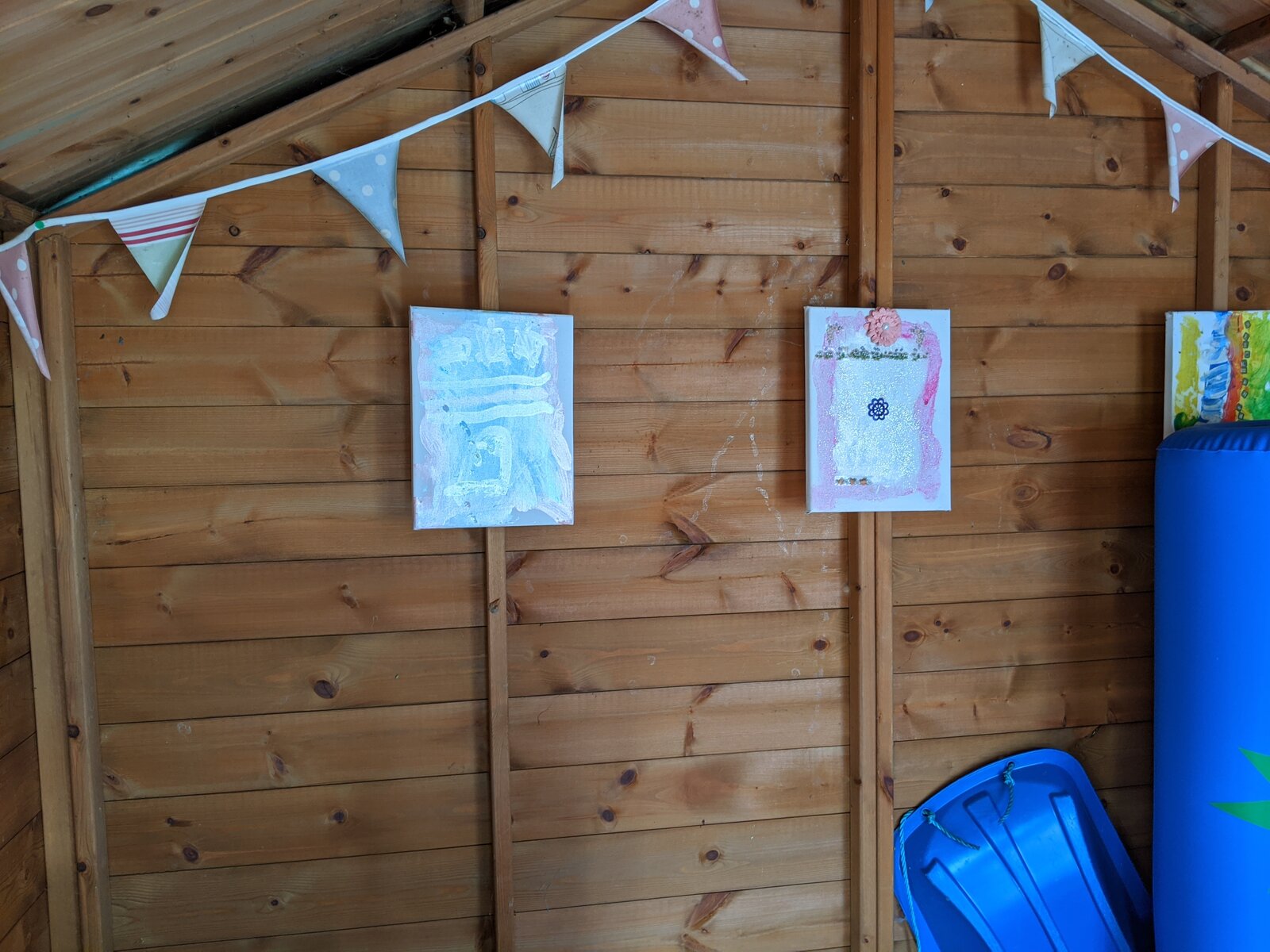

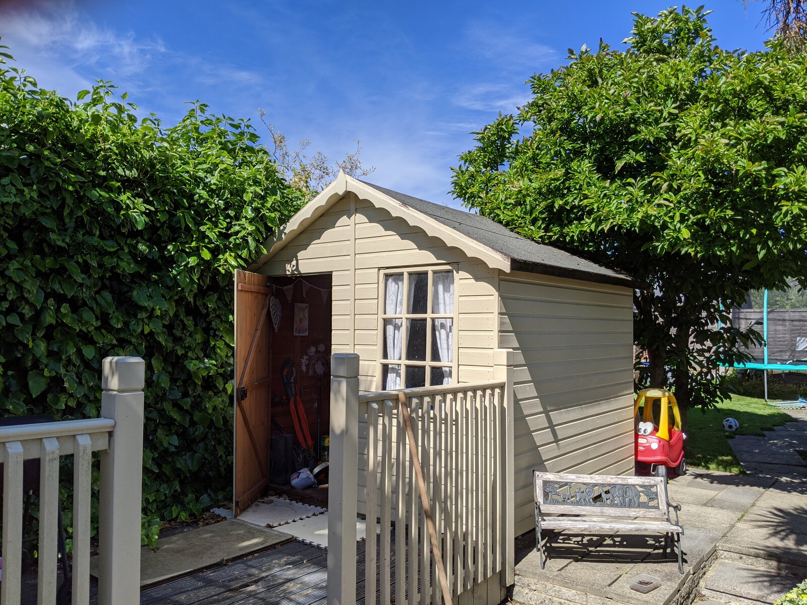

Hi, sorry another shed conversion topic!
Was looking into buying a garden office and was wondering if the shed/summer house would be able to be converted into something for all weathers.
The frame is about 6 SQM.
Is this worth considering or just knock down and start again?
I would have thought the main issue would be insulation and heating, you'd want to put a layer of Rockwool and board internally on the walls and roof, and have some form of heating, probably radiant heaters as they are more efficient for keeping you warm while stationary in a coldish space.

Insulation between those battens (25mm??) then tape the joints then plasterboard over the top (maybe insulated plasterboard as well - might be overkill??)
Obviously get someone to sort out the door and put a double glazed window in.
Whats needed for the floor? The shed is raised off the concrete currently.
You would want at least 50mm of Celotex walls, floor and roof, maybe more. Otherwise twice af much as other insulation.
I'd you've ever worked in a porta cabin, or caravan you'll know why.
