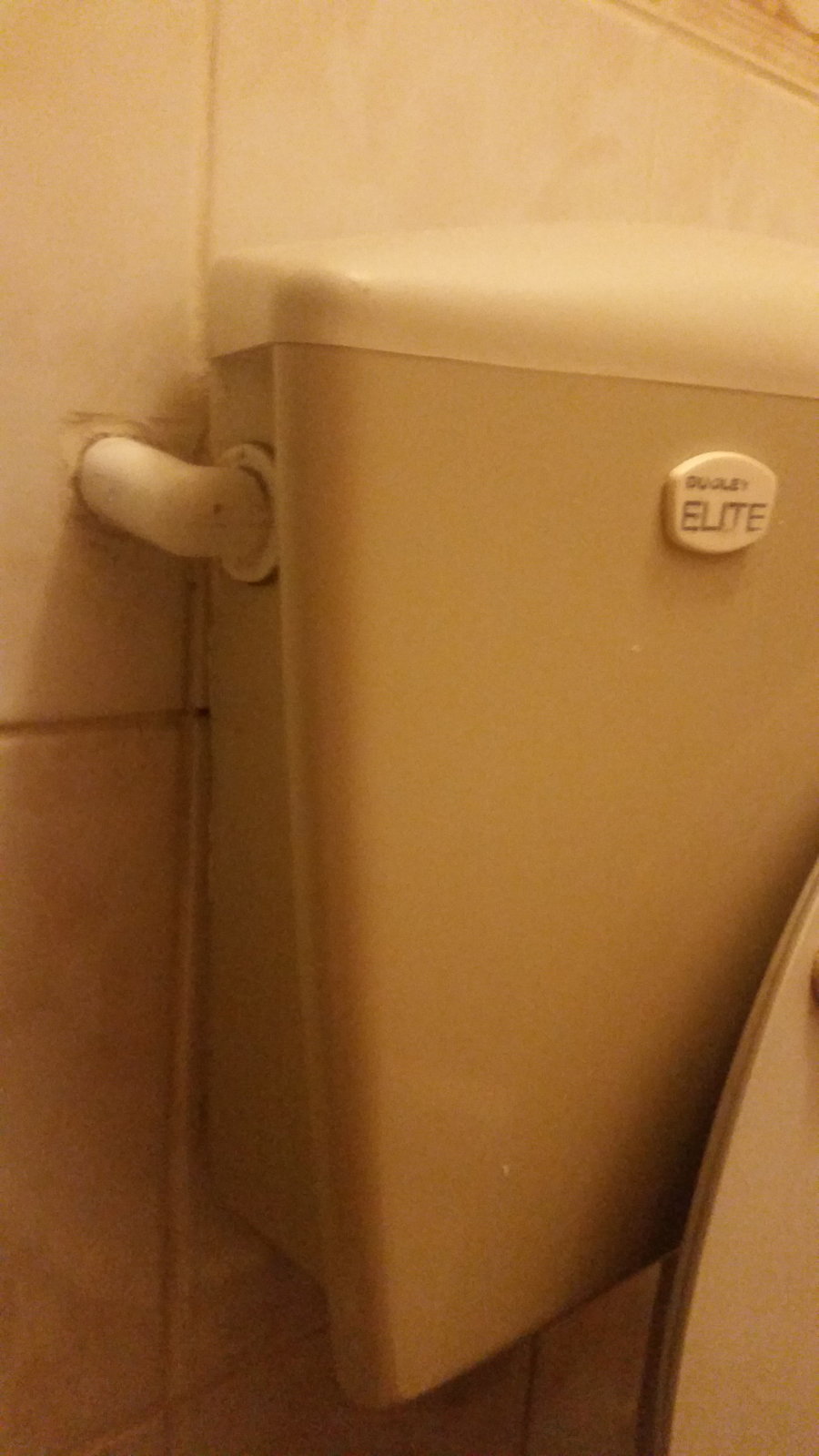

Thanks to those that replied. Here's something to make you lol...
Some of the old mans plumbing. Spot the "deliberate" mistake....
And no. It isnt an optical illusion.
