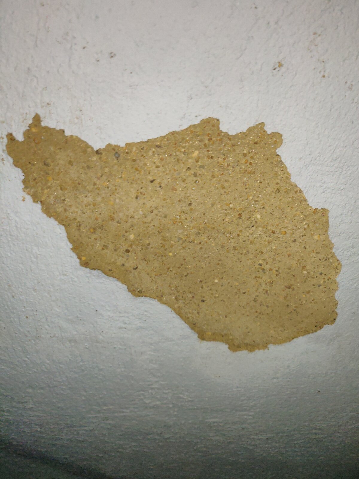

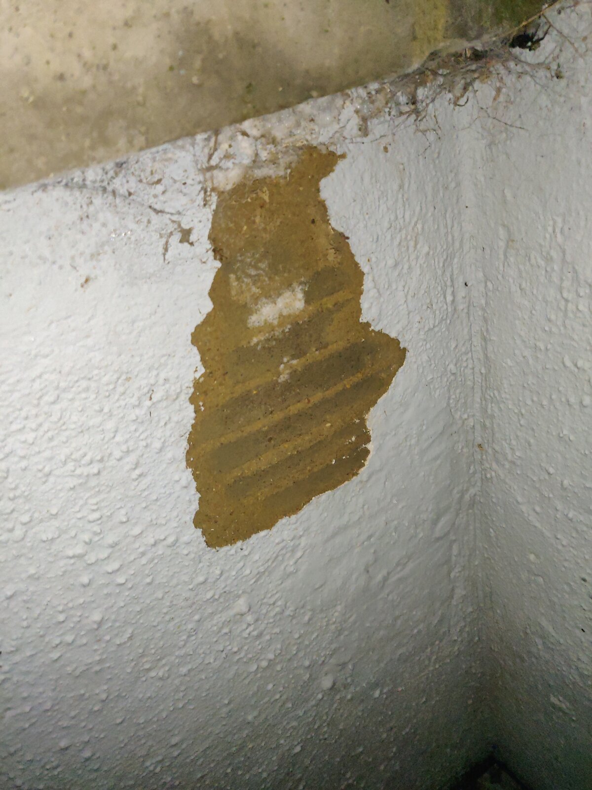

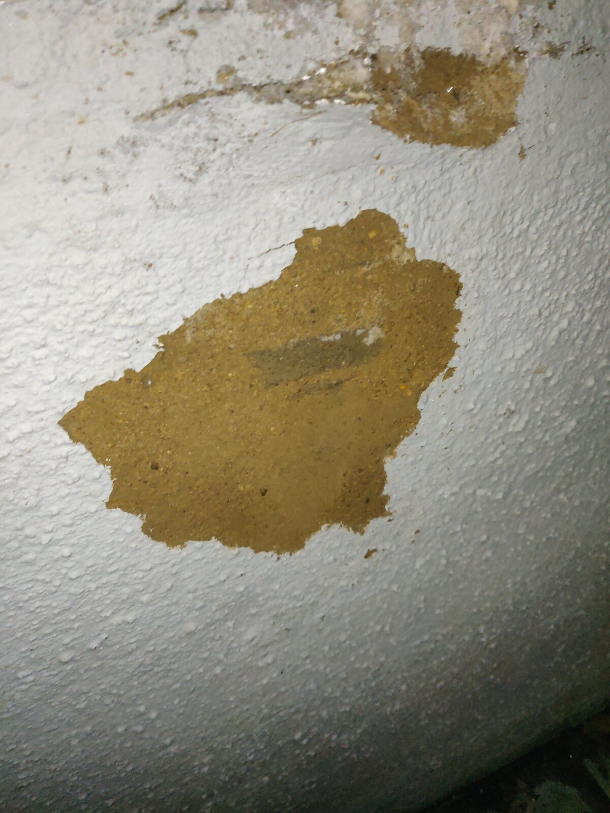

I am revisiting this, wondering whether I can do a bit of work over the Xmas hols.
I attach some photos. These are three bits of the wall where either the paint fell off or I scraped it off. The sand underneath is actually not all that crumbly, actually quite hard to take off. Most of the rest of the wall has a good finish I guess.
Ultimately, I'd like a freshly painted finish throughout.
On viewing these pictures, does the advice above change at all? Also, on Londoner2's reply above, what does fill in mean? Can you recommend a product?

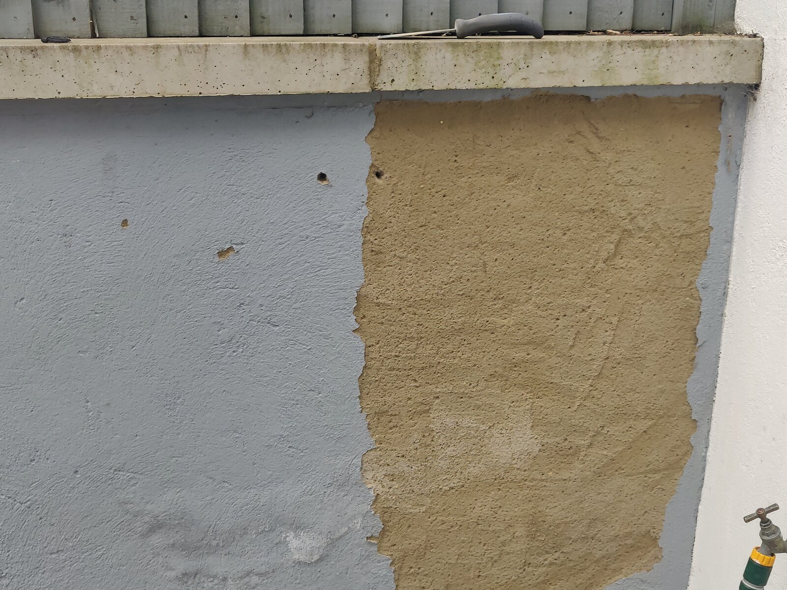

Hi
As a test, I have scraped off part of the wall as Londoner2 suggested - see attached! I am going to practice on a small part of the wall first!
I have got the filler, and some SBR as I heard that PVA wasn't as water resistant.
I am ready to do the filling, but how do I apply the SBR after that? The bottle talks about mixing with sand/cement etc, but now I am getting a bit outside my comfort zone! It's not just a case of painting on the SBR with a brush then painting over with masonry paint?
