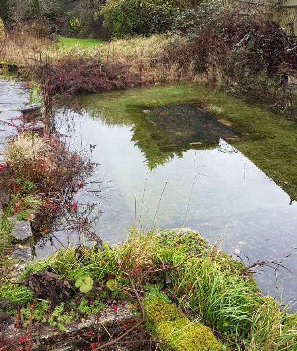

The well looks to be dry, or at least doesn’t look like the water is at the same height.

Level has been like that for a few days since last weeks storm. Will go round this week to see if it has drained. New pics hopefully higher res, plus one from the summer to see it without the water
I see now where I got the idea of it being natural - It's an enclosed space, with it seems no drainage and water run-off will naturally collect there. I would bet it fills up every time there is a lot of rain over a short period. I would be tempted to make a hole in the side of the well, to let it drain in there.
I was beginning to wonder if the well was the drainage point. Maybe it should have some 'weep' slots around the base to allow drainage when it rains and these have become blocked with debris.

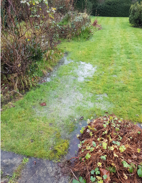

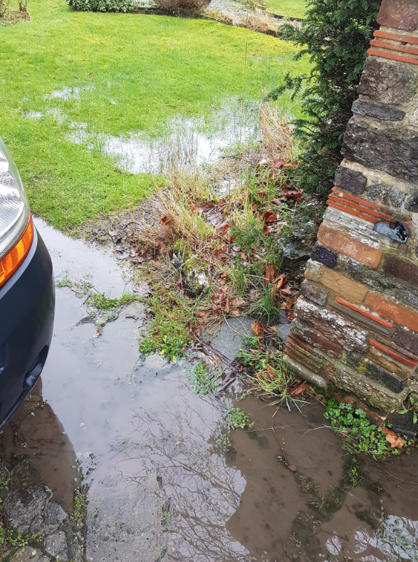

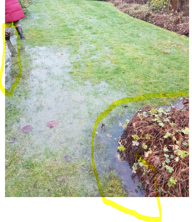

Had a look today! wow, still for the rear water around the well but its expanded in other areas on the property!
Going back to a previous comment this land is actually quite high compared to the surrounding area.
Seems the pond has turned into a swimming pool
Back garden is sopping
Front garden and driveway is the same
Well both sides have had changes, to the right the old house knocked down and completely rebuilt and to the left a large side extension. Nothing on the searches suggest its a flooding risk, but it doesn't look good does it! Its mentioned in the sellers notes that this can happen, so its obviously been going on a very long time.
That doesn't look good at all. At the very least it looks as if it will need some drainage systems putting in place. I had similar problems with my drive following an extension. Took 2 large soakaways and remedial works to cope with the water flow. Still not 100% following heavy rain but a vast improvement on what went befor

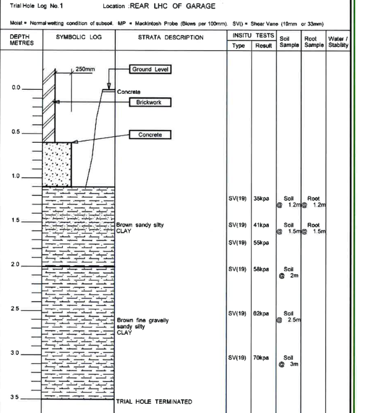

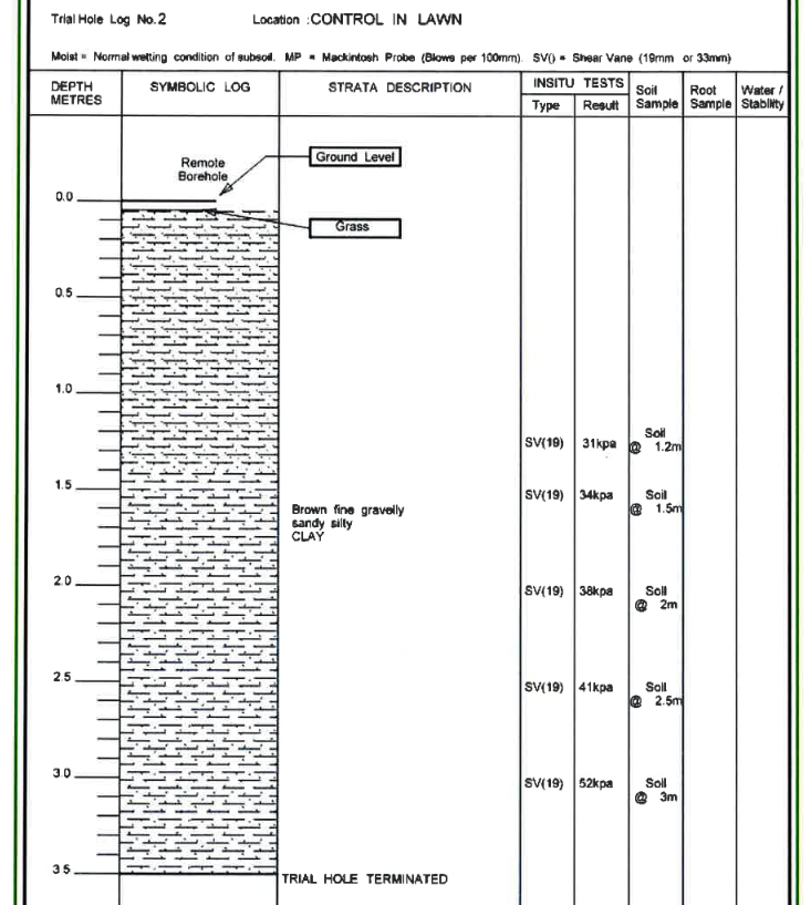

I just had some reports through which were created when they had some issue with the drains. Looks like clay. I need to read up on what this data actually means.

I just had some reports through which were created when they had some issue with the drains. Looks like clay. It also looks lie they have tried to dig quite deep trenches around the lawn, the wife nearly lost her wellie in one!
These should be ringing alarm bells for you.
They know they have a problem, otherwise why was the bore hole done???

I hope the property is cheap enough to warrant the risk.
The problem is, if you do buy, and have all this information available you won't be able to make a future insurance claim for subsidence because you've known about the issues.

The OP suggested it wasn't a particularly low spot, so there is potential to let it drain naturally, it just needs a drainage plan. The clay is water proof, so what is downhill of the place?
I'm on clay too and it can make drainage difficult short term, but dealing with it is not impossible. I used to get two or three inches of water trapped on the lawn at the back of the house, the lowest spot and it would stay there trapped for days after a heavy downpour. A bit of gravel, a bit of pipe and a French drain and now - despite still collecting, it has gone within an hour or two.
