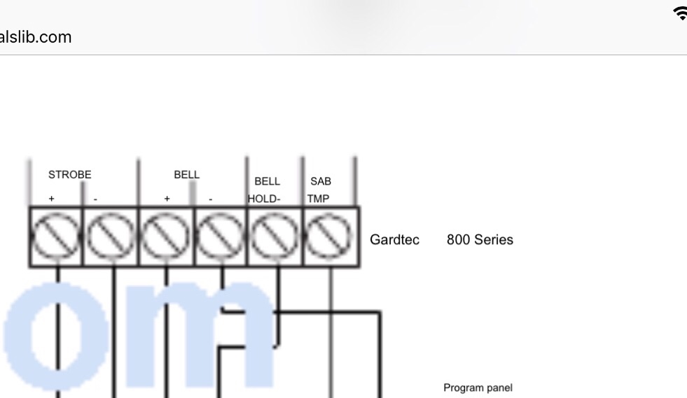

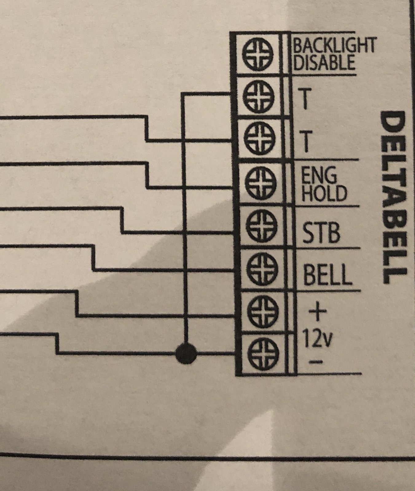

I have a Gardtec 800 series control panel my bell box has gone faulty so I have bought a pyronix deltabell x with light box. I was wondering if any one can help me with the wiring I am not sure where the wires go from the control panel to the deltabell (see photos)

+ Bell = + delta bell
- Bell = Bell delta bell
Bell hold = - delta bell
Sab tap = T delta bell
Put wire link from - delta bell to other T on bell box
Strobe- to STB delta bell
