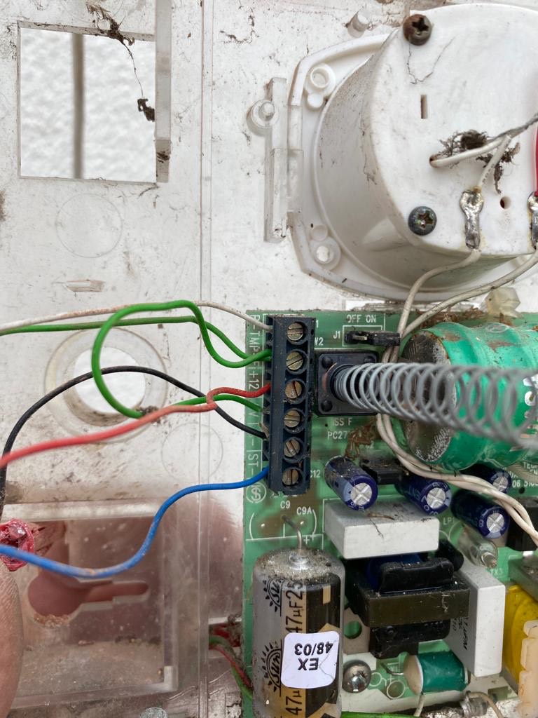

Hi,
I have a Gardtec control panel and keypad but have recently had our property rendered so took the opportunity to update the bellbox and chose the Pyronix Deltabell X.
It's been wired up and the two lights at the bottom flash one at a time, the backlight appears to always be illuminated. The control panel is displaying error code 66 which I believe is the bell box tamper code.
The picture is of the old bellbox and how it was wired up. Could anybody help advise how the Deltabell X should be wired up based on this please?
Wiring guide: https://www.pyronix.com/wp-content/uploads/sites/2/2017/10/downloads/63.pdf
Thanks in advance,
Ben

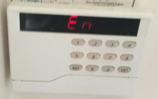

Hi,
Thanks for your prompt response. It looks identical to this one so I'm guessing 370 581/582.
Will have to post photo of the delta bell wiring tomorrow unless you can map based on previous bell wiring?

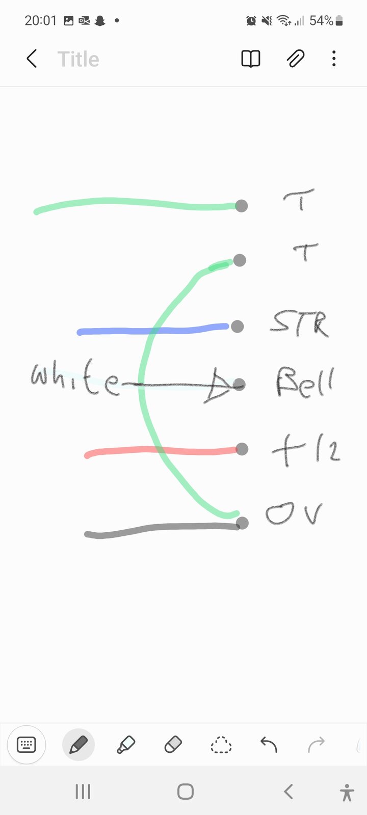

This would be my guess altgough i cant quite make out what all of the existing terminals say
