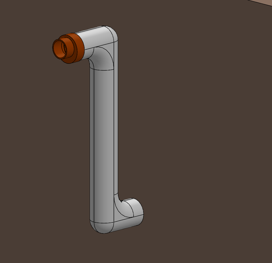

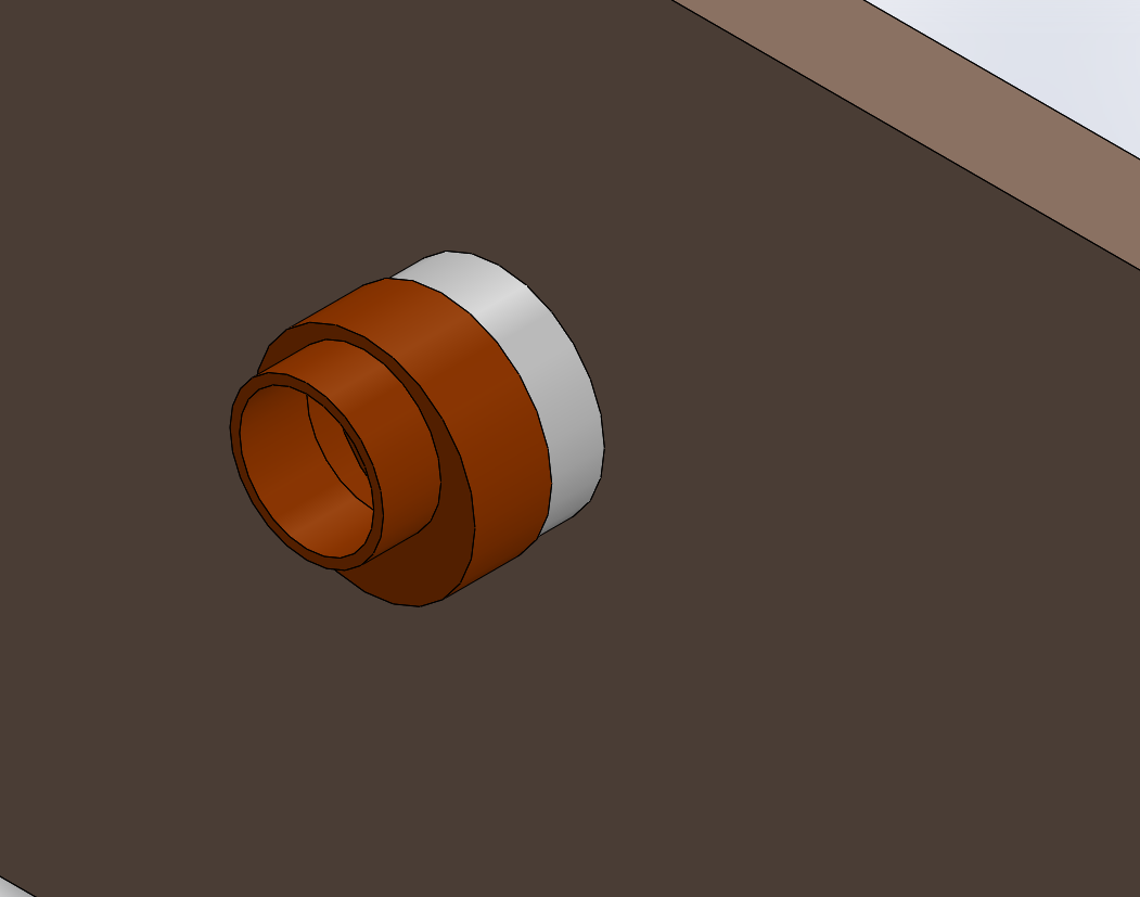

I have some CAD sketches attached as an example.
So this will take the exhaust and the air intake away from a situation at the moment where the air intake risks run off from the roof. And exhaust away from combustables. Should the conservatory still be steel shielded at the elbow which would be close?
Is this a legitimate solution if using all manufacturer parts (which are available).

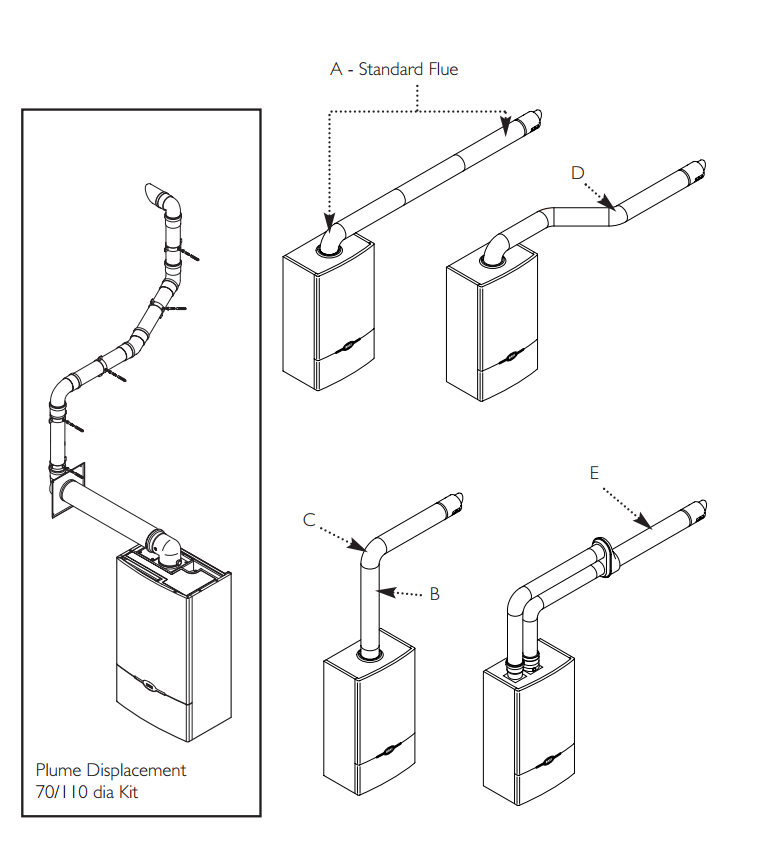

The boiler is a Baxi Combi HE133 Plus.
From the manual the installation methos of the flue is "A - Standard Flue"
The Plume displacement kit noted has been advised by Baxi. But as far as im aware this kit takes the inner plume away leaving the air intake at the wall? Thus giving the same potential for water run off into the air intake.
I would be looking at 2 x Part B and 1 x Part B to make the periscope to take the whole thing away. Thus doing the same as the displacement kit but for the whole lot including air intake. Unless the displacement kit does take the whole lot and then id get one of those and cut out the middle pipework...

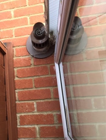

I had my wife take this as i am currently working away.
From the picture i believe the last panel has slid down about an inch possibly. Its not firmly fixed and can be removed. This is because when it went up we saw the problem and left that part waterproof but not finished. Its been up about 6 months. Theres plenty of leeway cutting back the panel, as i say push it up an inch and probbaly take another off it then cap off. But its still going to be 50mm from the roof.

If the roof were to be trimmed back so it's at least 25mm away from the flue to the side and modified to prevent water streaming down it onto the flue (some kind of deflector maybe?), and the window below is not openable, then there's nothing wrong with this as it is. If the window below is openable, get it changed for a non-openable one.
the pane below is not openable, and the next openable window is on the second panel, ~800mm from the flue outlet.
the deflector makes sense. I think i read somewhere (here actually) about a 1m fire shield? What is the 1m measurement?
Rich
