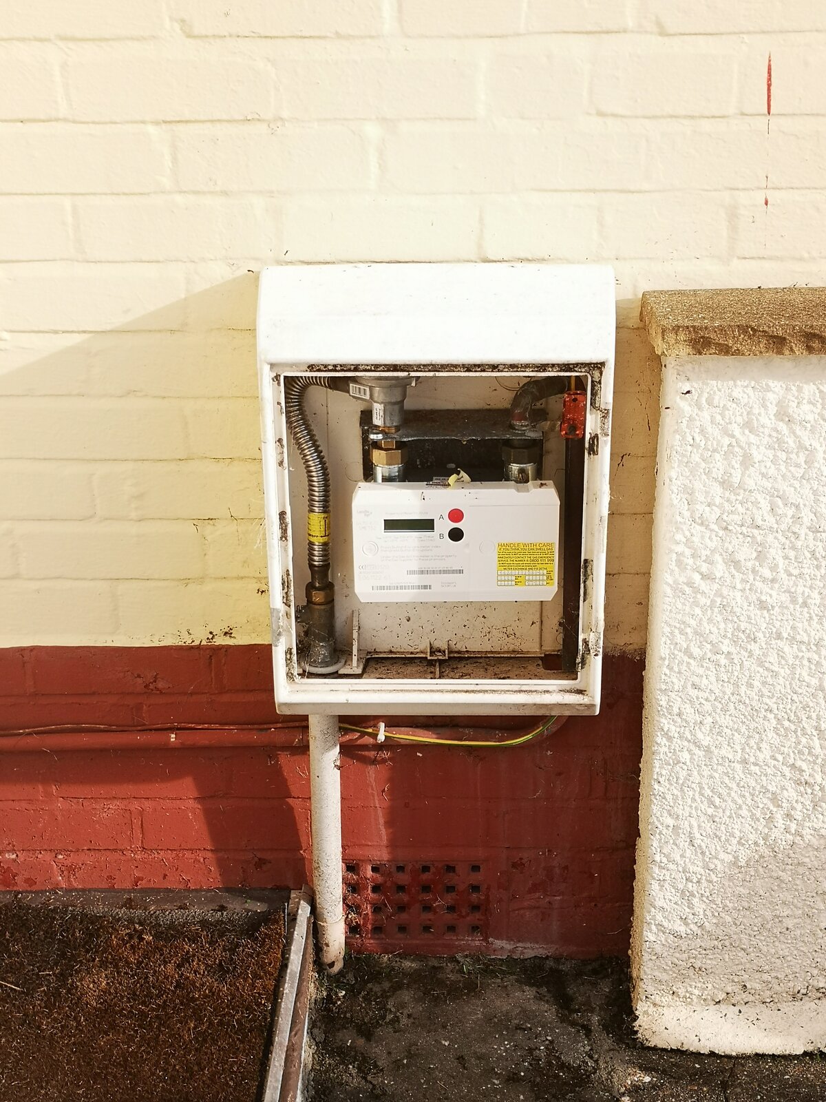

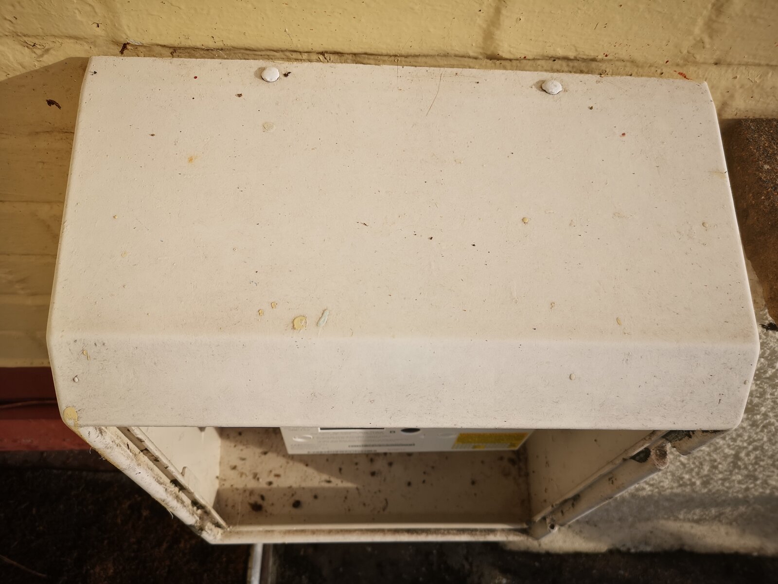

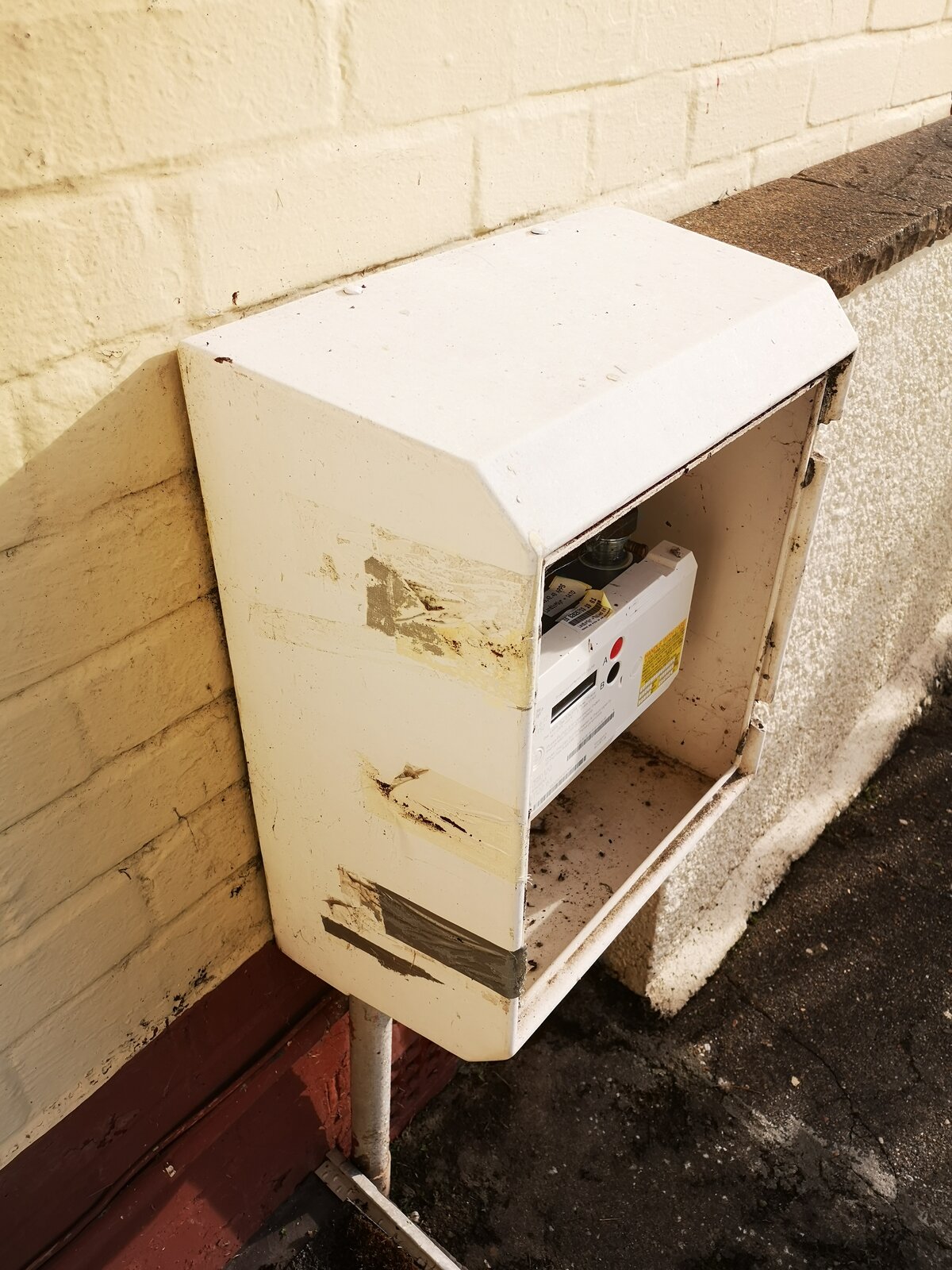

Hi all,
The hinges for the door of our very old gas meter box have broke. It was held on by some "lovely looking" tape.
Is a replacement door something I can get online? Or do I need to contact a professional?
Is it a particular model?
Does the door just slot in to the holes? They don't seem broken.
I attach some photos of the box.
They are often cheaper on ebay than from merchants
its a mark 2 surface meter box so this is the door you want . The hinge pins push into themselves then pop into existing holes
