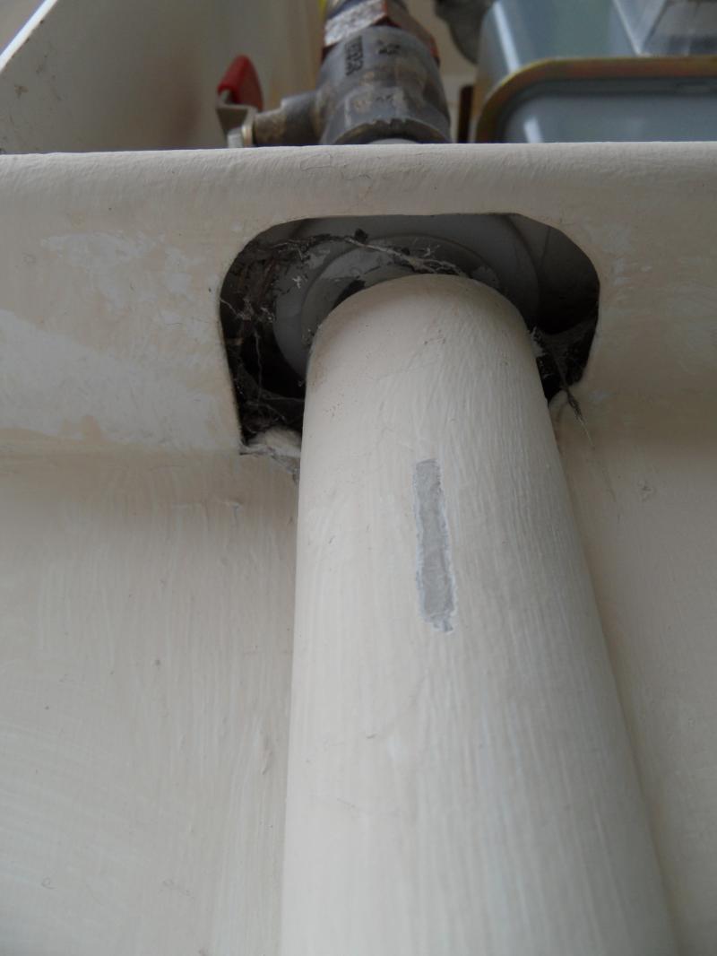

Gas meter regulations inside porch.
As far as I am aware a sleeve for a gas pipe does not need to be fire resistant as the gas is adequately contained in a steel or copper pipe.

Agile its a service pipe and if sleeved its plastic .
the sleeve has to be fire resistant
If its a plastic service pipe ( which the OP has not confirmed ) then its probably correct that its non compliant.
But I see many plastic service pipes entering property a short distance so I can only assume thats considered acceptable. Even have one like that in my Midlands house!
The "sleeve" is a GRP riser Glass reinforced Plastic these are designed for outside use only and should not be used indoors GTC are correct in their diagnosis Im afraid

The gas pipe contained inside the GRP riser IS PE and as such cannot be installed internally GTC are correct and to be honest that price is a decent price I would go ahead and agree to let them do it, this situation is not part of the GSIUR regulations that most of the people on here are familiar with it comes under the Gas safety Management Regulations, a lot of people on here giving you false information, the problem is before the Emergency control valve so nothing to do with the majority of posters on here

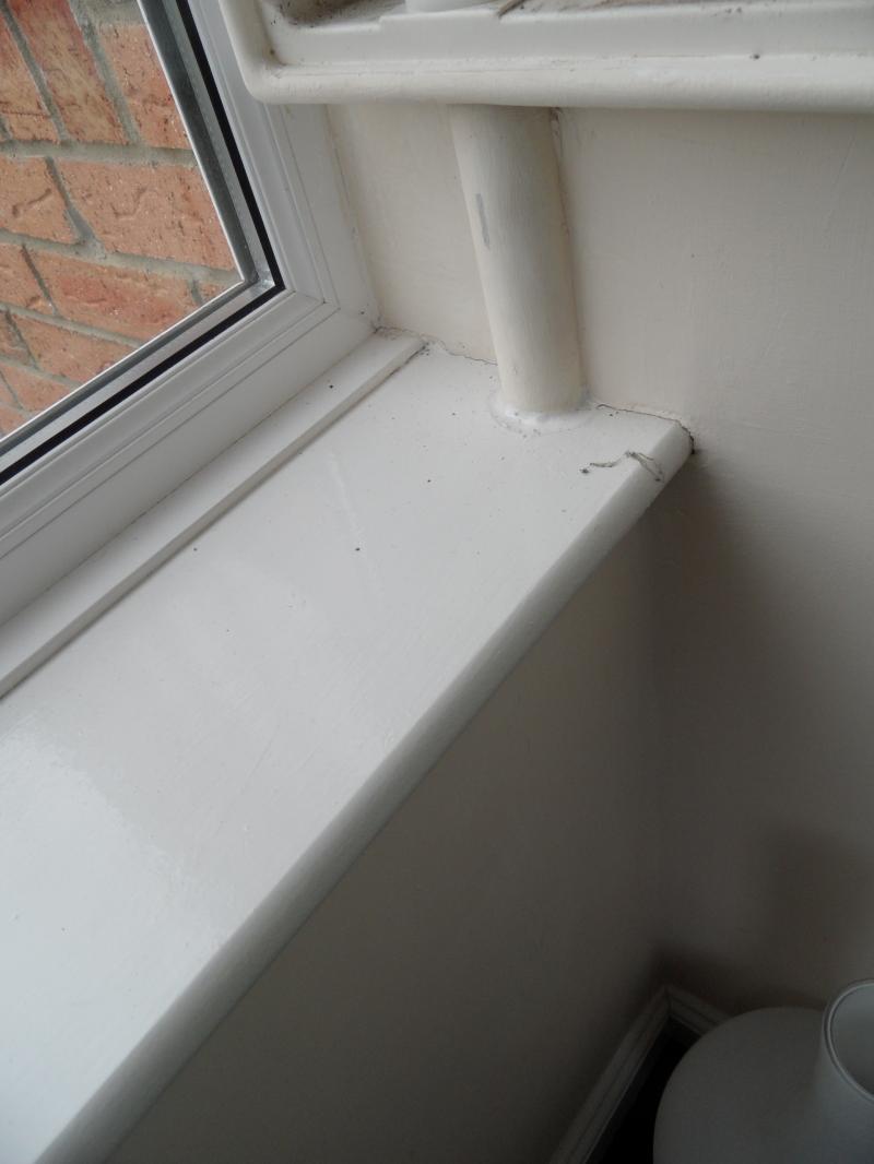

The PE comes through the wall into my house below ground level and then connecter to about 1m or steel before the meter.
Is that permissable?

Agile are you sure its PE and not yellow plastic coated steel house entry
