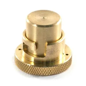

They must have access to a Gas Safe person, ask them to cap it properly.Thanks Guys, for all of your replies.
Brian.
Brian.
OK, but consensus seems to be that even if no pressure drop is found, it's still not acceptable to rely on the bayonet fitting.Test pressure isn't dropping therefore not leaking
wrong it is a perfectly acceptable to leave its a basic acs question . Yes a plug is better but do not say no its not
The cooker can be unplugged temporarily, not permanently. It needs capped properly.I don't know, but some on here say it's OK, others that it's not.
OK, it's not my cooker, I posted out of curiosity. I didn't see how to use a manometer, before spotting the obvious, isolate at the meter and connect the manometer downstream.The cooker can be unplugged temporarily, not permanently. It needs capped properly.
Wrong as per usual try reading the regs or even gas safe TBs oh yeah your not qualified so stop trying give advice on something you clearly don't understand... tell you what denso sneek into th CC and see what the pros have said about it somany times in the past..The cooker can be unplugged temporarily, not permanently. It needs capped properly.
Do portable gas barbecues get capped off after every use do gas pokers get capped off after every use...eh no because a bayonet is an acceptible method to leave . Whether someone wants to go beyond that is up to them so get it rightThe cooker can be unplugged temporarily, not permanently. It needs capped properly.
