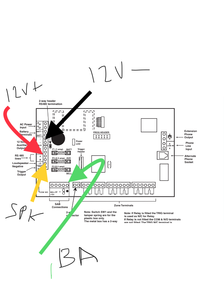

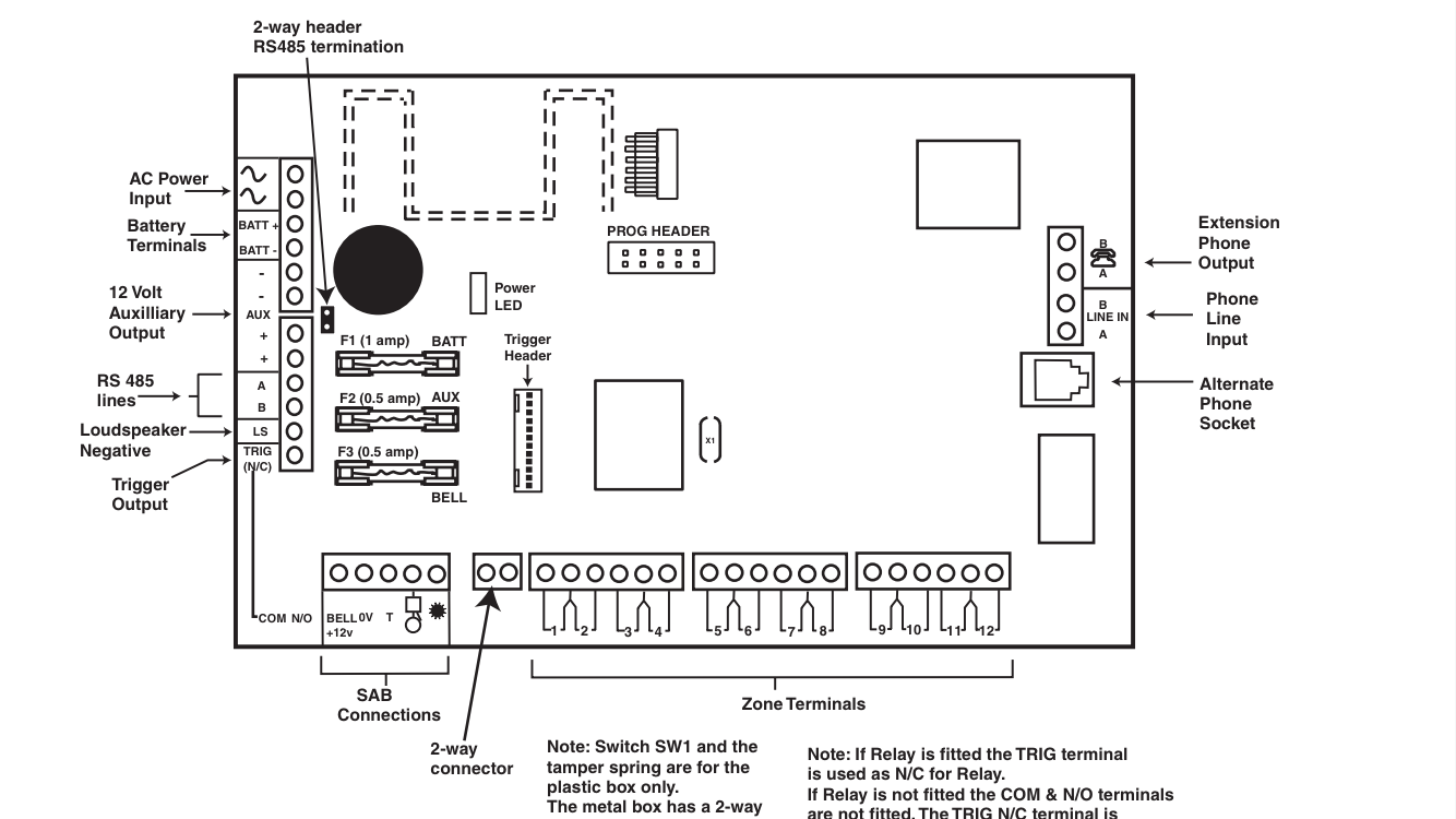

Hi there. First time poster here.
I have a galaxy g2-20 Alarm panel that I wish to add the Pyronix twin alert sounder to it from here https://www.securitywarehouse.co.uk...yronix-twin-alert-internal-sounder-p-345.html
I found this wiring diagram of it attached.
I have full engineer access to it.
I’m trying to work out the correct way to wire it in and looking for some pointers.
I’m so far presuming:
the sounder To g2-20
12+ To 12v + aux
12- To 12v- aux
Spk. To Loud speaker neg
Ba. to ?????
T. To ???
T. To ??
Would like any direction how to wire in the tamper and BA.
Thank in advance

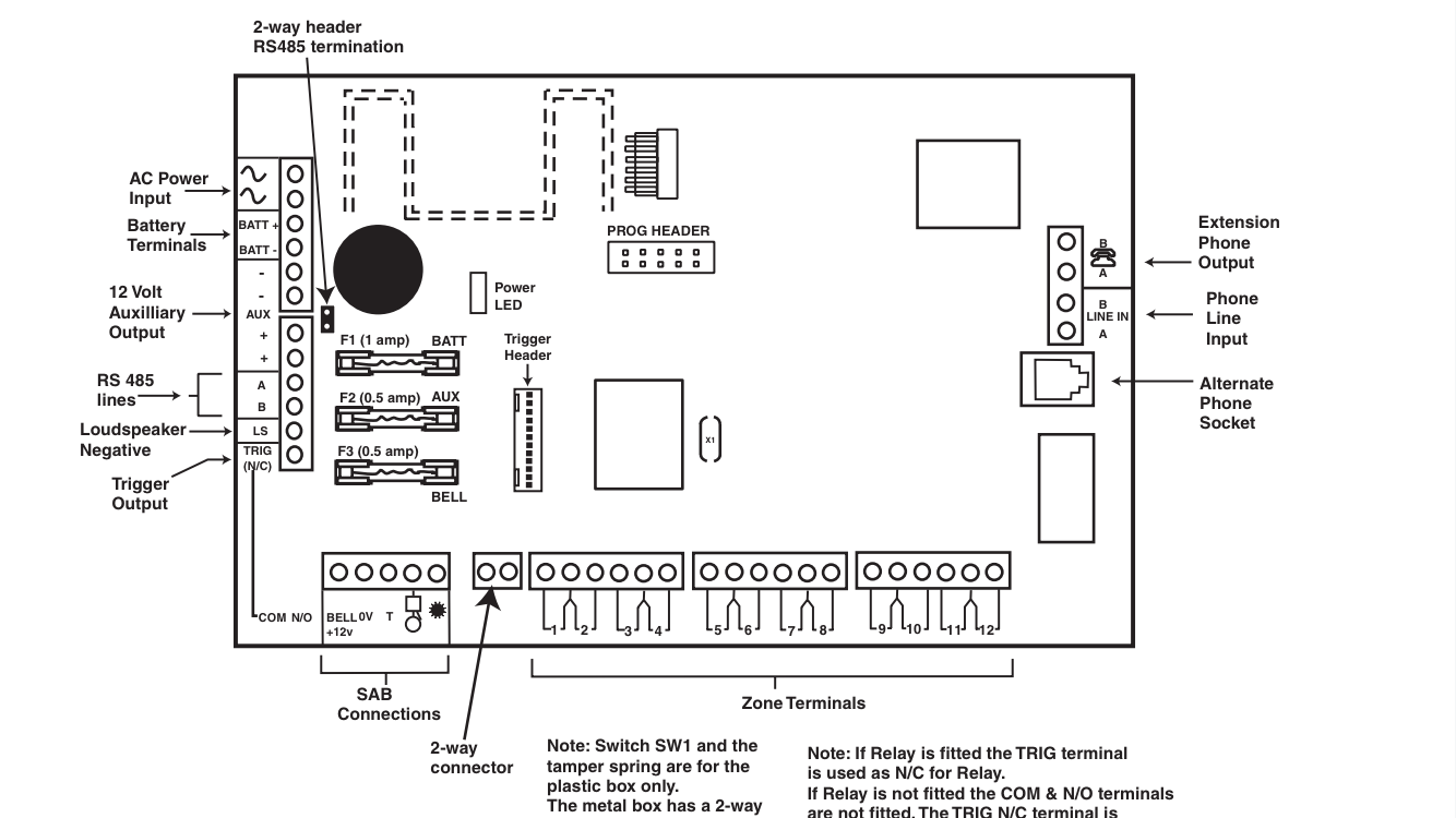

Ba goes to bell trip ....the bell icon on the sab block bottom left the tamper goes to a zone via a 1 k resistor if you have a spare zone
I haven’t opened it up in ages but I’m presuming the bell outside is already in the bell icon? Is so I just tee in with it?
The other connections are as I said?
I do have spare zones but not sure I’m really too bothered about a tamper for this so I could just leave it unwired?
Thanks.

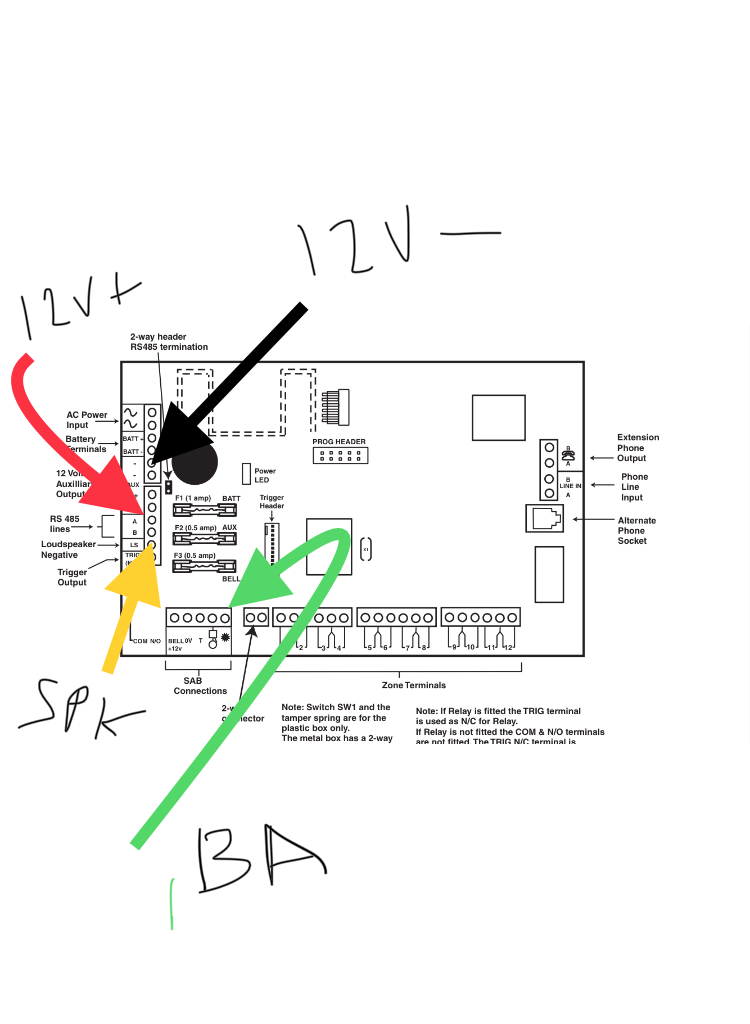

If I was to wire the BA in to the strobe symbol input would that mean the sounder would still carry on past the bell time until the alarm was cleared.
@sparkymarka
Ok just for confirmation I have added a pic via phone app.
Do I need to link the tamper out on the sonder or leave it open?
I am not really worried about wiring it in to a tamper in all honesty I can’t see it would make much difference as already inside the house.

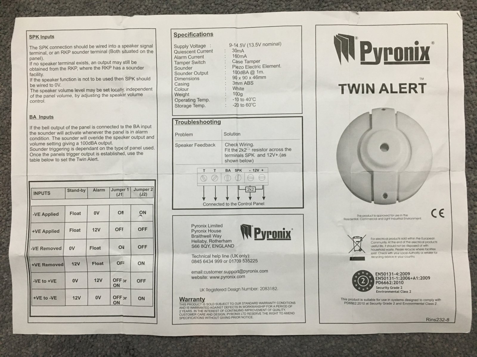

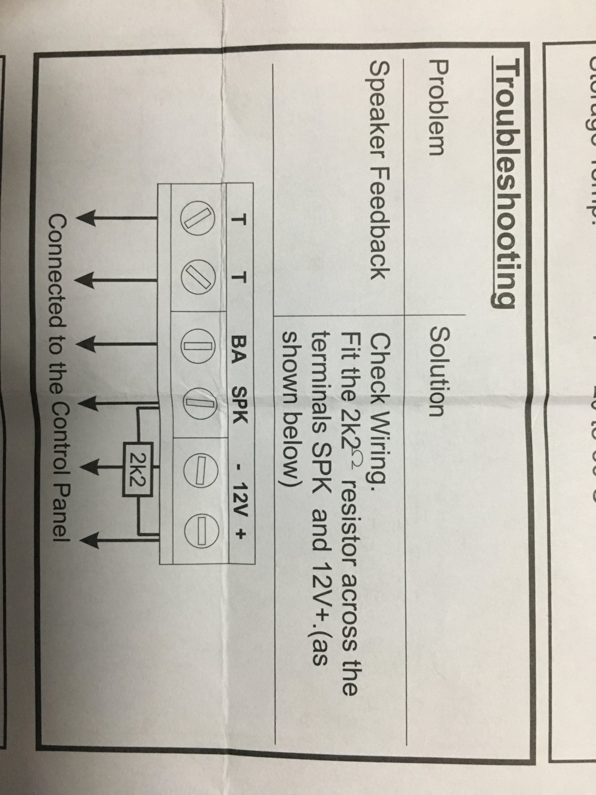

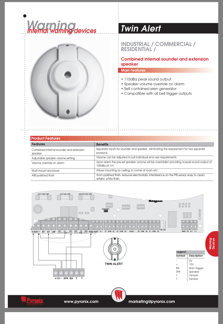

Just to update and hopefully it may help anyone else out in my situation.

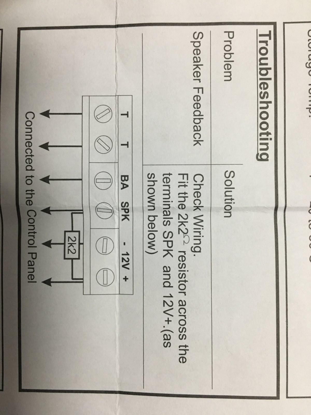

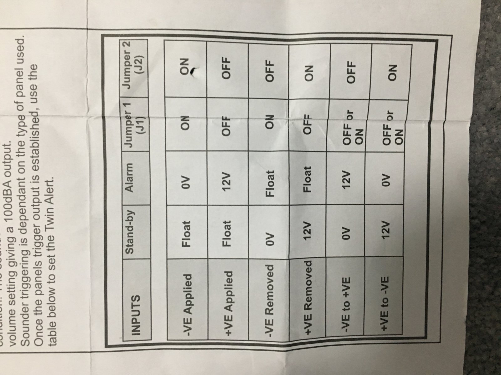

I wired the internal speaker as per my diagram back to the panel apart from the stobe output was already being used by the bell so rather than t in to that i made the set/unset output no1 (under the speaker neg) and changed it to stobe via settings. Additionally I made sure the speaker (no2 output ) was definitely set to speaker before connecting everything up. I also had to fit a 2k resistor across the speaker and 12v+ on the internal speaker it’s self (as per sheet), jumpers on speaker were let as set in my case.
Tested and working great as a normal speaker and then goes in to a higher tone/alarm when the alarm is actually triggered.
I have uploaded the information sheet I got with the speaker.
