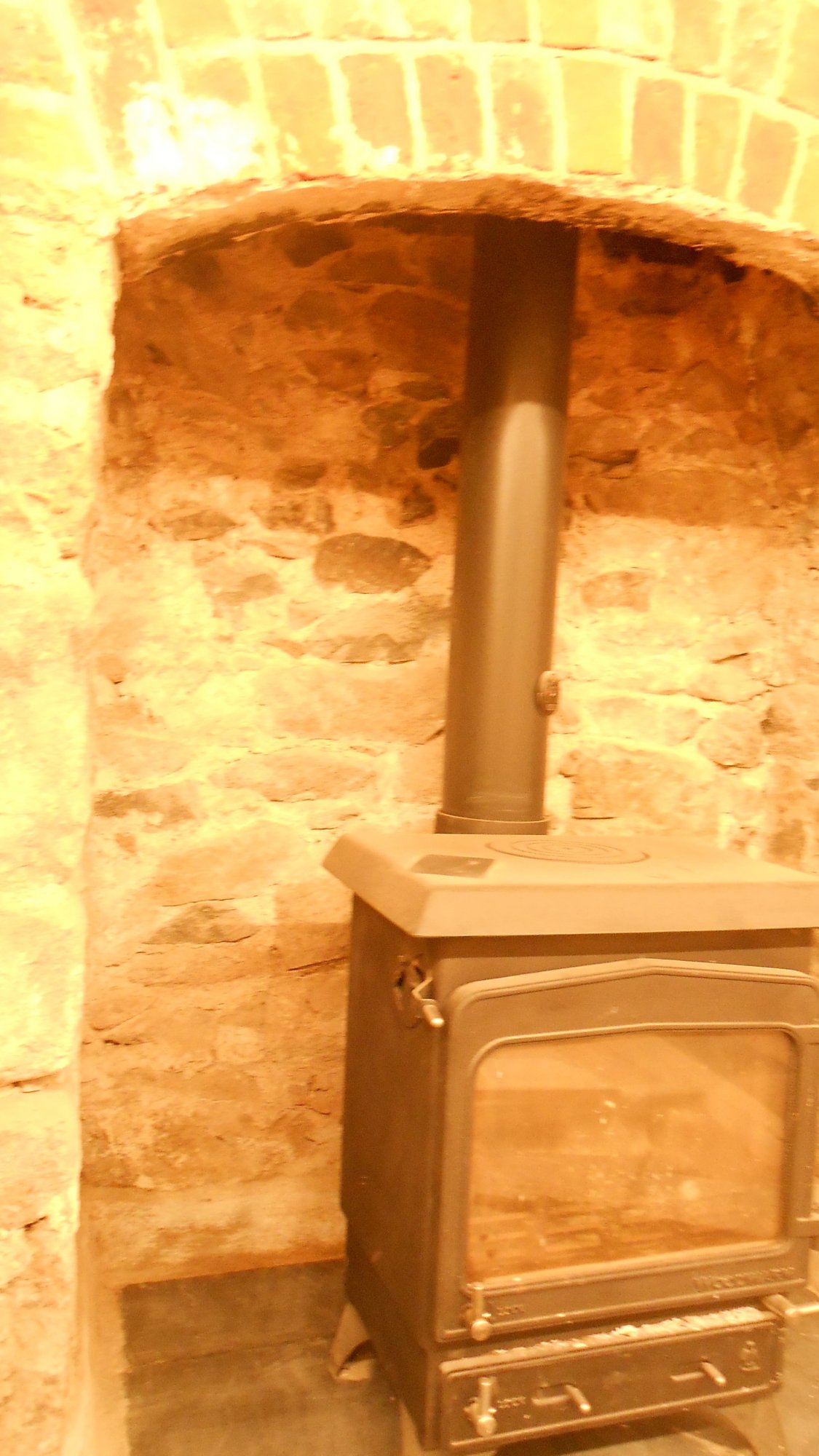

We opened up an old chimney, and have had a woodburner installed (with a flue)

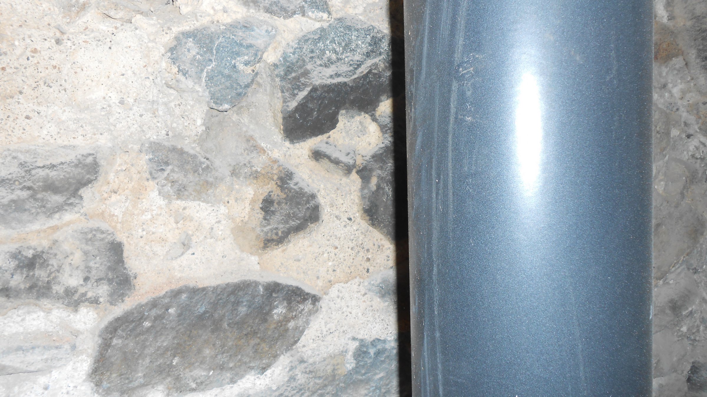

We have a damp patch on the back of the fireplace recess (about 4' above the hearthstone), which was there for some time before the burner install, and is still there some months afterwards. We find drips of water on the hearthstone. It seems worse when the weather is wet.

Photos - the damp is on the darker stones which are seen in the pictures to the left of the flue - we also get spots of water which have dripped down onto the hearthstone below
You'll have a closure plate above the stove, but do you have a liner, and is there a chimney cowel fitted.

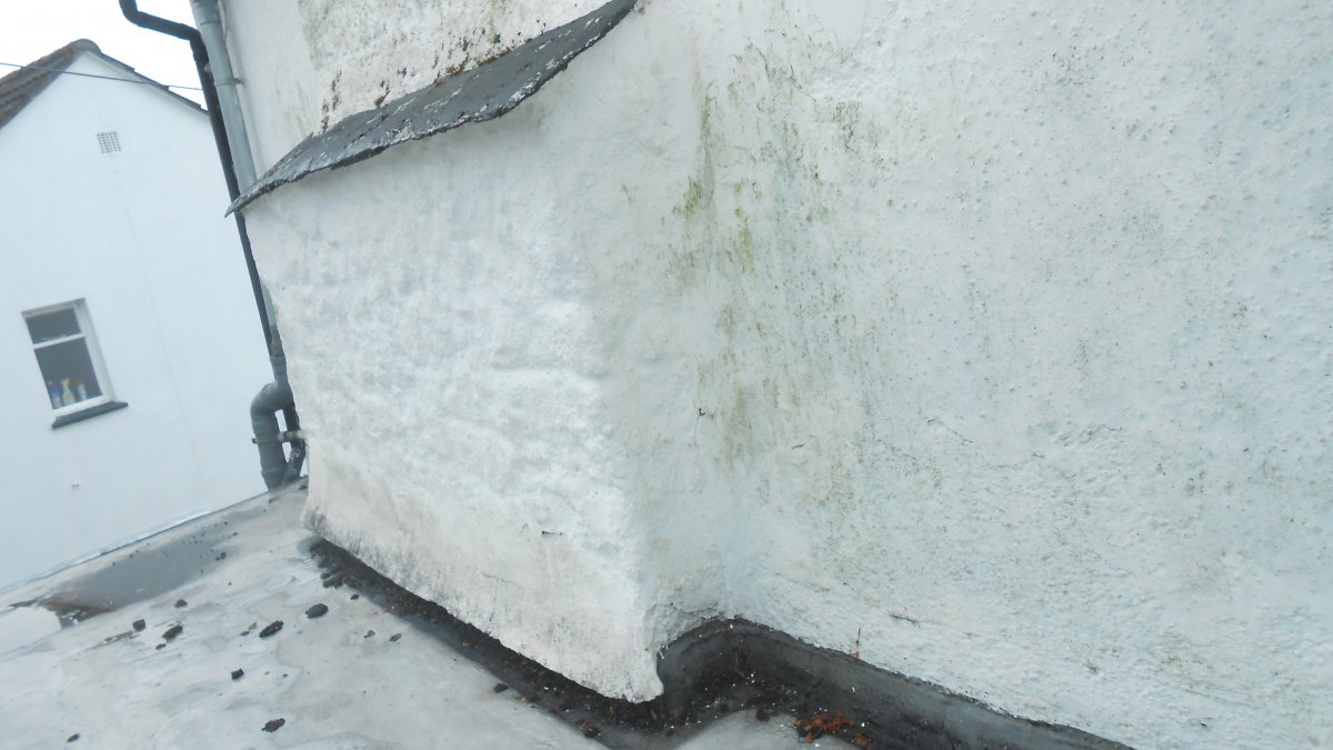

You'd see if there was a cowl by looking up at the chimney, but if you've got a liner, then there should be one. If there wasn't, then that could allow water to come down the chimney, and drip from the back of the closure plate, so unless there's a source of water that's dripping into the chimney flue (especially as it's worse when it's wet) then you need to maybe look at the single storey behind the chimney, and check to see if the roof is letting any water through. So pictures of that needed next.

Yes - they did install a pot hanging cowl

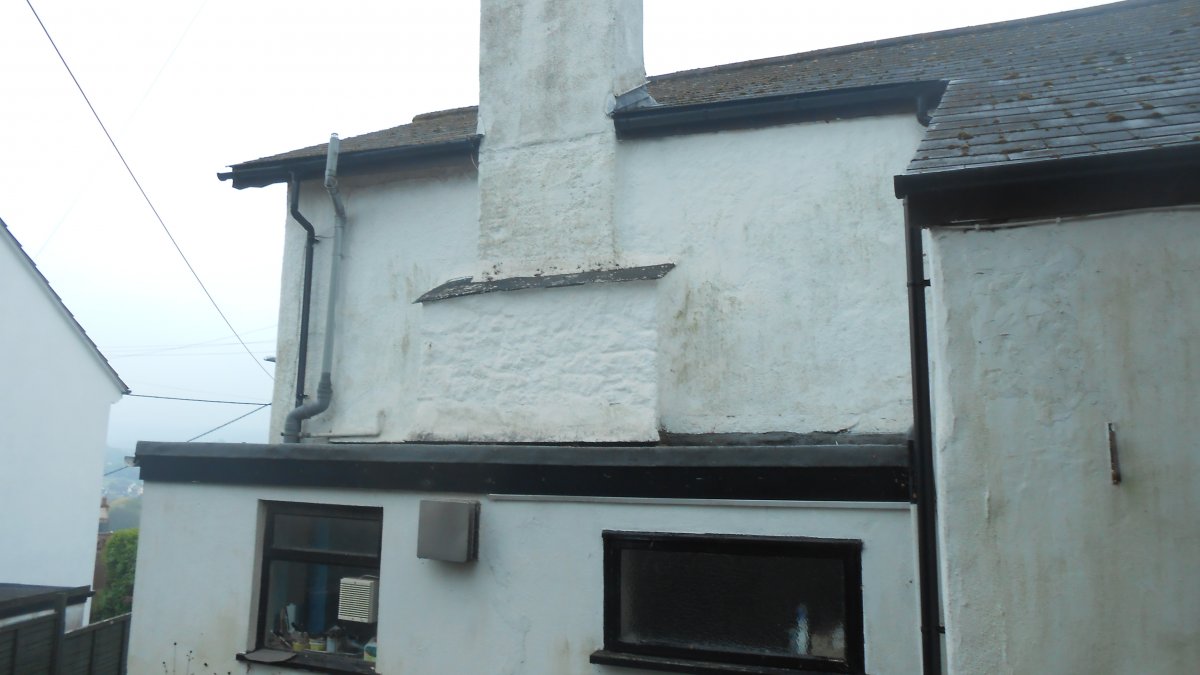

a couple of photos at last:
