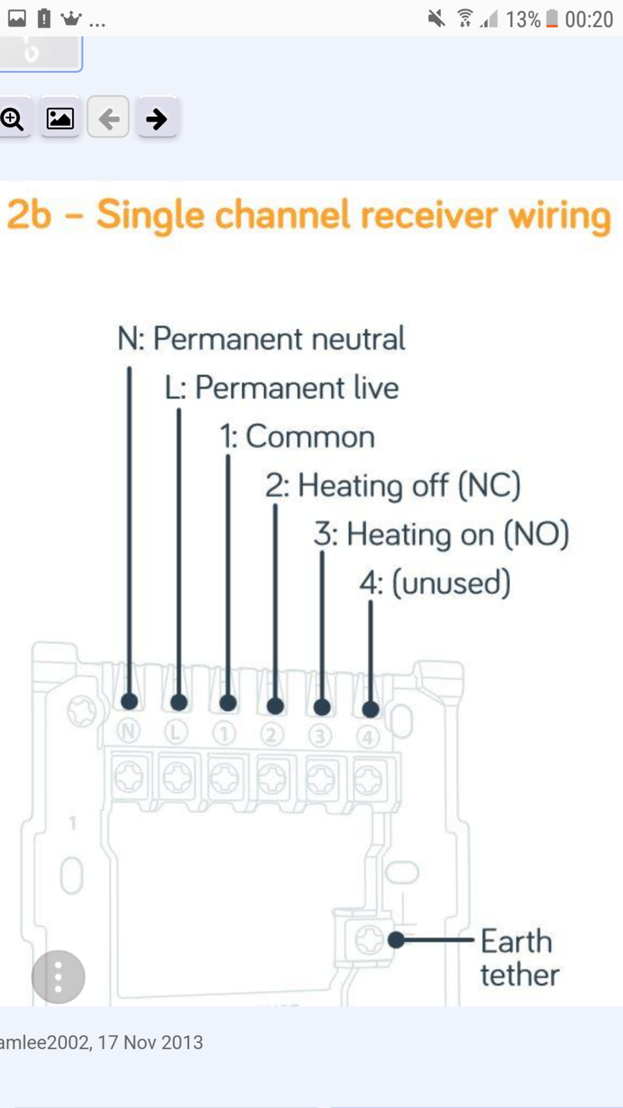

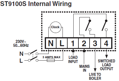

Hi.
I know this is an old post but im hoping someone can help.
I am trying to install the hive and I have had trouble matching my Honeywell st9100s wires to the hive single channel wires requirements.
Can anyone help??
It seems the ST9100S has two sets of contacts and the Hive only has one set, it would seem wires going to 2 are only using 2 as a junction block, hive shows 4 on their system is also just a handy terminal for joining wires, so reading the two diagrams not having used either I would expect.
1 to 1 on hive
2 to 4 on hive
4 to 3 on hive
That is assuming I have got the correct diagram for the ST9100S.
