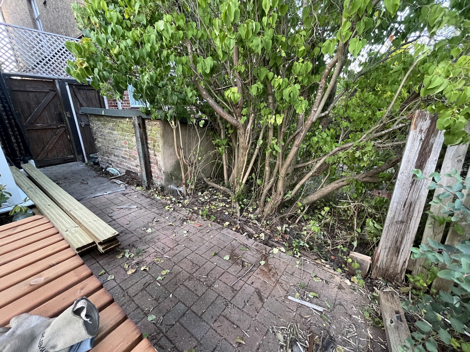

Hi all, any ideas on how to approach getting some new fencing up here?
It’s my first time with a fence and I’m mainly wondering about how to get the footings for the posts in - I haven’t tried but I’m guessing that digging holes for footings where those tree roots are will be a real challenge. I do have an SDS drill which I guess may help.
For where the little brick store is I was thinking about just attaching the posts directly to it. It’s very solid indeed.
Any advice welcome!

Digging near tree roots is tricky a digging bar and sharp spade will help more than an SDS drill. For the brick store, fixing posts with proper masonry bolts should be fine if the wall is solid. Don’t forget drainage at the base of the posts.
Thanks all - going well so far and have taken note regarding the tools.
Fixing to the coal store has worked really well!
The roots haven’t been too much of an issue - it’s more our soil is incredibly crumbly and hard. But we’re getting there
Appreciate the advice!

as to the OP - with al those roots in the ground and the driveway on the other side - I would just form the hole with a metal bar (old half shafts are good) and then drive the post in with a sledge hammer - no concrete need for a fence there
