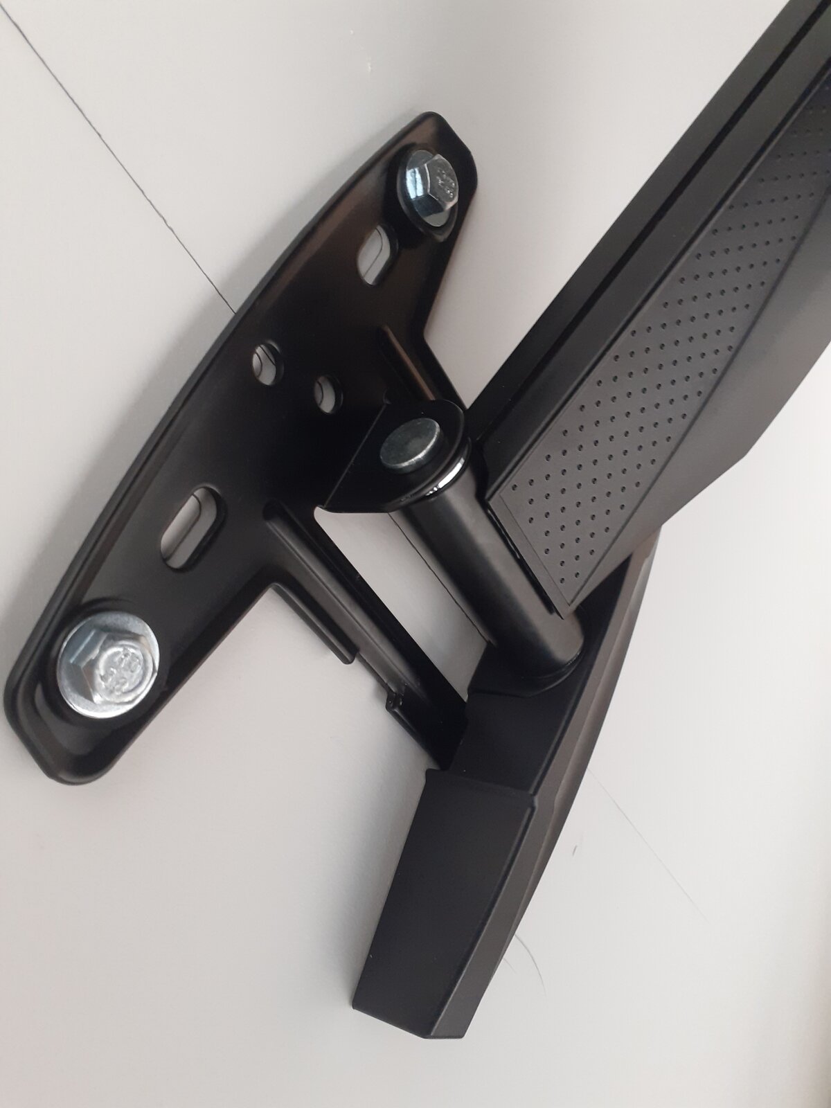

My mate's TV had bolts put into his brand new flats wall (wall with neighbour) so I presume dob and dabbed onto concrete, he said plugs were used so not thunder bolts. What length and type of bolts are these and what plugs?

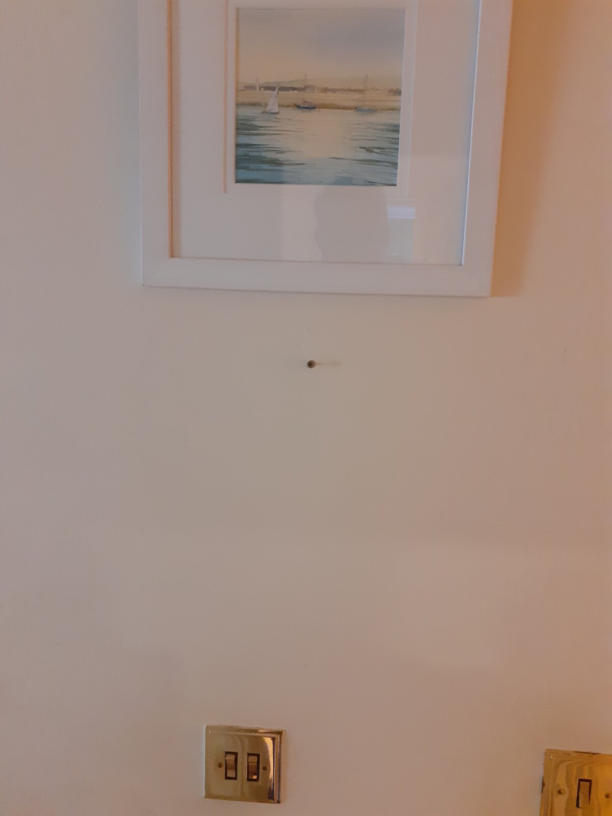

Secondly, i put a shallow plug just above light switch, is it enough to the side to miss the cables from light switch below? (2nd pix.)

That's the strength - grade 8.8 here.
What size are the bolt heads? That's normally a pretty good guide as to the diameter, 10mm head will typically be a 6mm dia thread, 13mm head will be 8mm dia thread typically.
It will say 8.8 on the head, that's the tensile strength.

Get yourself a stud/cable/metal finder for the cable. Marvellous for calming anxieties!

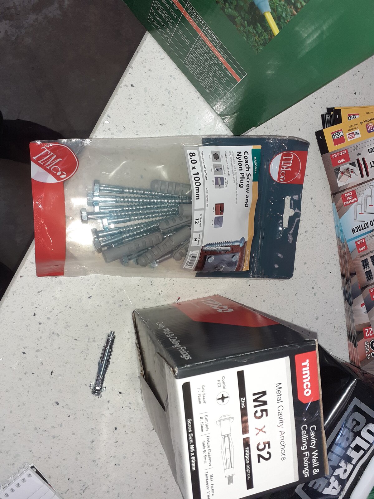

I bought these two. I guess the cavity anchors are the most common size used for one plasterboard thickness. Are the coach bolts (100mm) with 12mm plugs meaty enough for a dog and dab wall for a TV?
You back doing handyman work, @Keitai ?
That depends on how "thick" the plasterboard + dot and dab are. Up to about 40 to 50mm in total on a 100mm screw and you should be OK for a light load on a decent wall (so I wouldn't try it with Thermalites!). TVs don't weigh that much, do they?
I think those coach screw sets are actually made for fixing timber battening, etc onto walls. Coach bolts have a parallel machine thread, a square beneath the domed head and get nuts screwed onto them - completely different
So you'd go with those rather than coach bolts for a telly into dot and dab walls?
