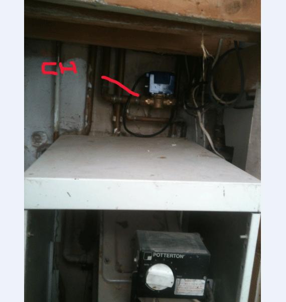

A pic showing the cylinder and the 15mm pipe to the bathroom rad would be helpful.

Okay got you. I'll try again. the 2 x two port motorised valves have just been fitted on when HW only is on the pipe to the left of the CH valve in the picture doesn't heat up so I don't think it's passing through.

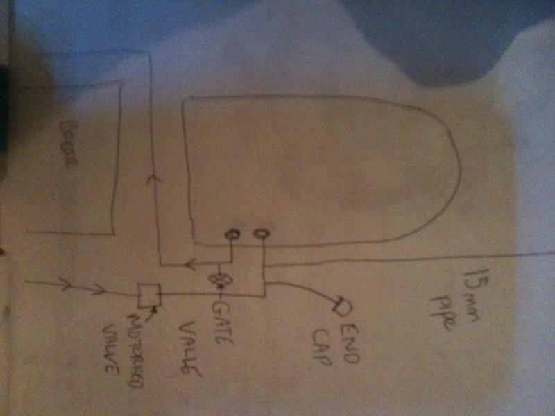

Couldn't get a photo because there is a cabinet on the side but I could get my head/hand round the back enough to work it out and draw this. The 15mm pipe is definitely coming out of the higher one between the motorised valve and the cylinder.
That eliminates one possibility - reverse circulation due to the pipe being connected to the cylinder return. But it raises two questions:
1. Is the bathroom rad completely isolated from the rest of the system?
2. Where is the return for the bathroom rad?
I'm thinking that there may be a path from the bathroom rad return to the rest of the system, so you are indirectly getting a reverse circulation situation.

Thx,
The bathroom rad gets hot when only ch is on also but if there is a path from to the rest of the system I guess that would happen also.
I'm going to lift some boards at follow it through.
Regarding the subject, getting ch when hw is on is what needs sorting but I'm pretty sure this flow issue is heating the hw when only ch is on therefore making the cylinder stat and mv irrelevant.
