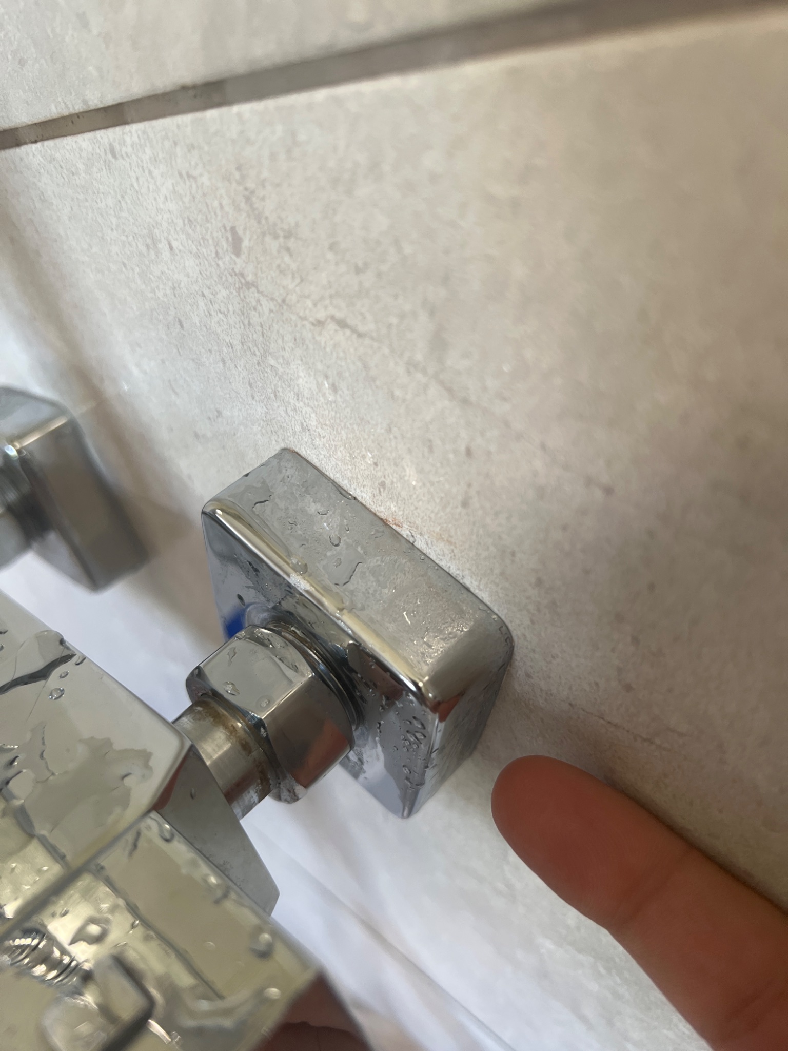

Hello,
Any suggestions on the best sealant to get this fascia/cover to stick to the tiling and stop water going behind it?
A thin bead of transparent silicone applied to the top and side (cleaned!) surfaces.
Or: demount mixer, remove cover plates and gob up the gap between pipe and tile.
