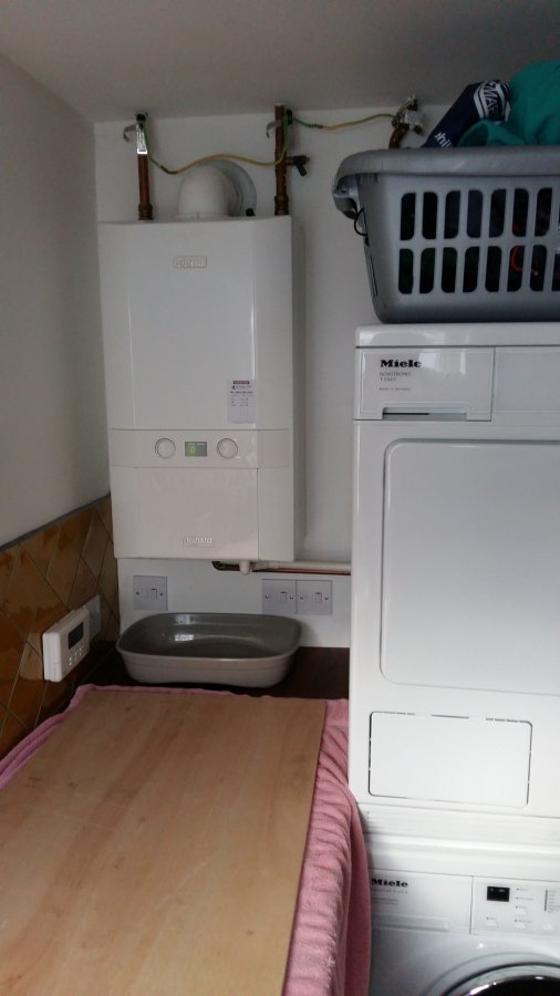

A few photos of the install: boiler siting/casing/flue/terminal siting and surrounding areas might be useful!

Pic attached. This was put in 5 years ago. We've been told is still complies to latest regs.
It's a smell with the boiler casing that escapes into the room. One of the RGEs agreed this one time he took the cover off and got the smell.

The case seals on that model look pretty robust.
But if you think the case may be leaking you could stick masking tape along all the joints.
Also look underneath in case there are any grommets missing from the cable entry holes.
