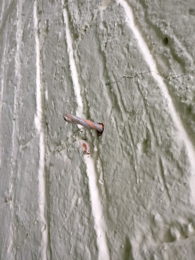

So I'm doing this now with my drill in hammer mode on full speed and an 8mm long bit.
I get a few inches in quite quickly then suddenly it just stops... I seem to have hit something I cant get through and I've no idea what.
Any thoughts?
iron pipe?
soft red bricks jam the drill if they are damp.
Success! The bit was clogged I think, shopping it clean got it going again :)
