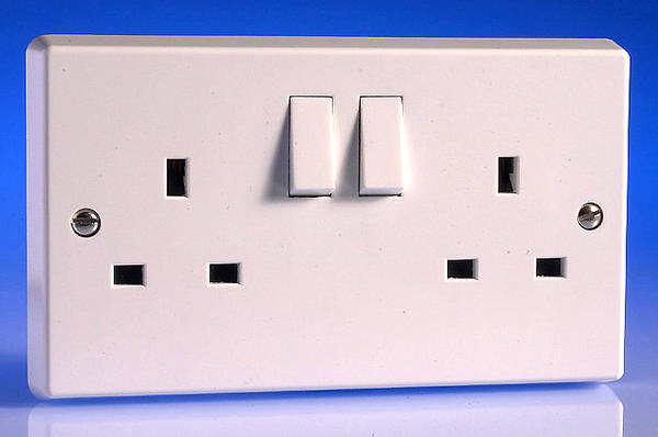

Over here, the difference in price between one of these:
(approx £3)
and one of these:
(approx £30)

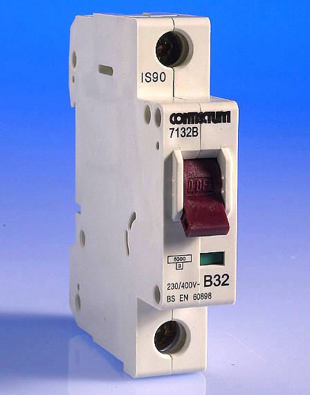

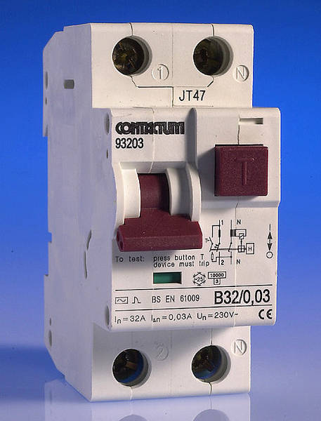

is such that if you want more than one protected outlet on a circuit it becomes cheaper to use a breaker like this:
(approx £40)
