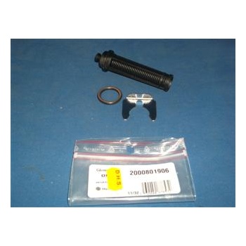

Hi, I know this is an old thread nut my 30cxi has developed a leak similar but in a slightly different part of the housing in that area. It appears to be a super fine jet of water from the Dcw inlet housing. How easy is this to replace for a novice or should I get the engineers back yet again?
For a pro this is probably pretty easy as boiler repairs go.
But I saw a similar fault and the leaking water had damaged the electronic parts of the boiler!
But perhaps not one of the easiest for a DIYer although there is no very specialised knowledge needed.
Tony
Ive narrowed the fault to a part number from the diagrams. This seems to be a simple unclip, pop out and replace job. Please some advice would be very welcome.
2000801906 - SANITARY FILTER 24 VR

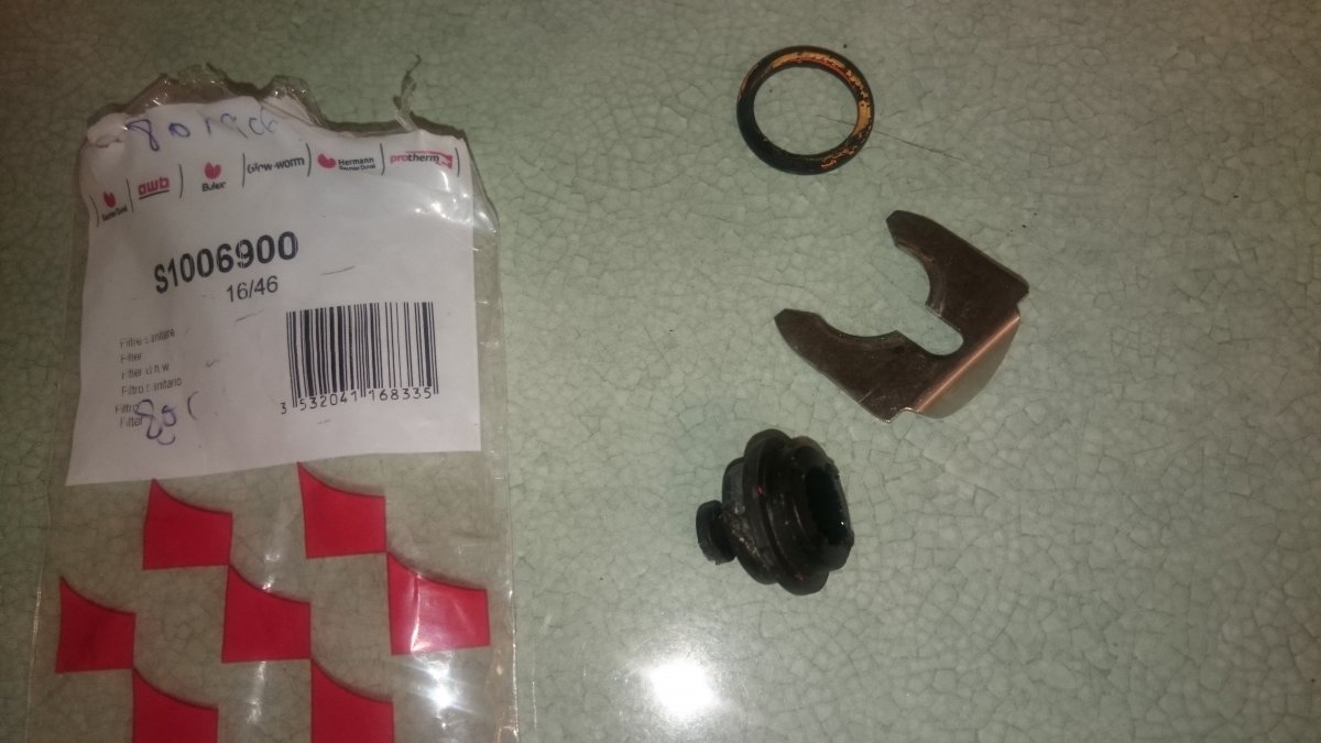

Well part came today, £22 Inc delivery. Decided to give it ago after a little advice. 10 min job start to finish and signs that the engineers that I'd paid hugely for the privilege of using in the past had obviously bodged the job. Part I removed had obviously been altered and refitted.
New part popped in and all back on, repressured and £200 saved, jobs a good un.

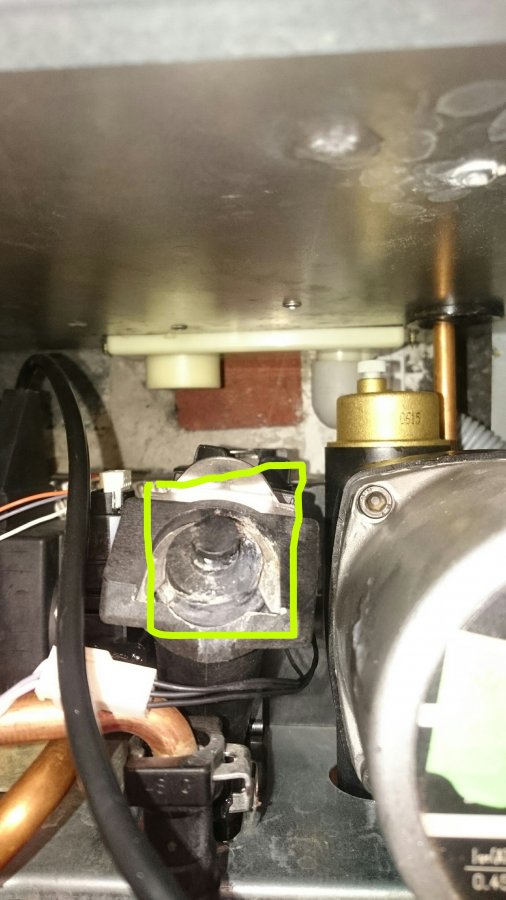

Same issue here unfortunately ( same place as pics kindly provided by Paul).
Are there any updates on this issue, and has replacing the flow switch resolved the issue.
My issue
Thanks in advance guys
