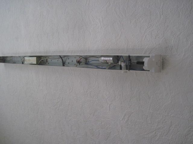

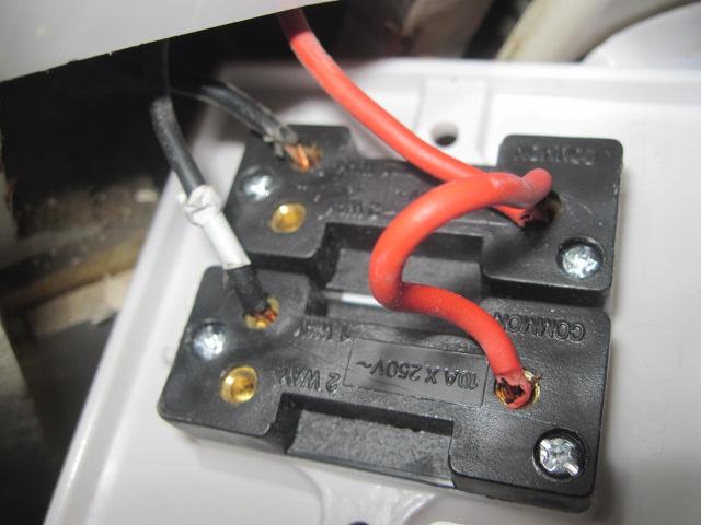

Photos as requested the switch at the bottom of the photo is the one to the tube, the other switch is to an external light that is now disconnected with the end of the cable terminated with blocks.

From the photographs it looks like you have live and switch live (black with white tape) at the switch.

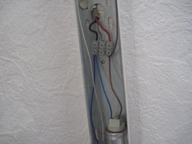

At the lamp unit you have moved from a switch live(black with white tape) situation to a live(red), neutral(black) and earth (which doesn't have sleeving on by the way).
This means there must be a junction box or terminal block behind the lamp unit.
You will need to check to see how that is arranged - possibly photograph same.
Neon screwdrivers are not very accurate for testing purposes and you may be reaching the point where you need to call someone in to sort it out for you.

This is what I would expect at the jb. You can see how the live, neutral and earth loops are set up. A live (red) leaves the live loop goes to the switch and comes back to the jb as the switch live (in your case black with white tape) - it then goes to the top right terminal changes to red and then goes to the L terminal on the lamp. Similarly, the black (neutral) goes from the lamp back to the neutral loop.
This is what you are looking for - forget for the moment what is live or not because your tester is not the best method of properly identifying it.
If the set up is at shown in wiki then with the power off check that all connections are tight - if they are then there may well be a problem with the actual lamp unit itself.

I have even tried changing the appliance with one from another room and still get glowing tube when turned off, maybe it has always glowed when off and we haven't noticed.

Well that confirms that your switch is switching the neutral, not the live.
