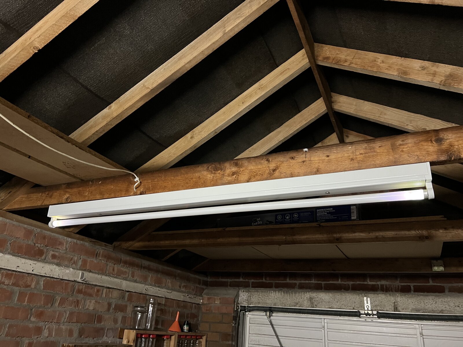

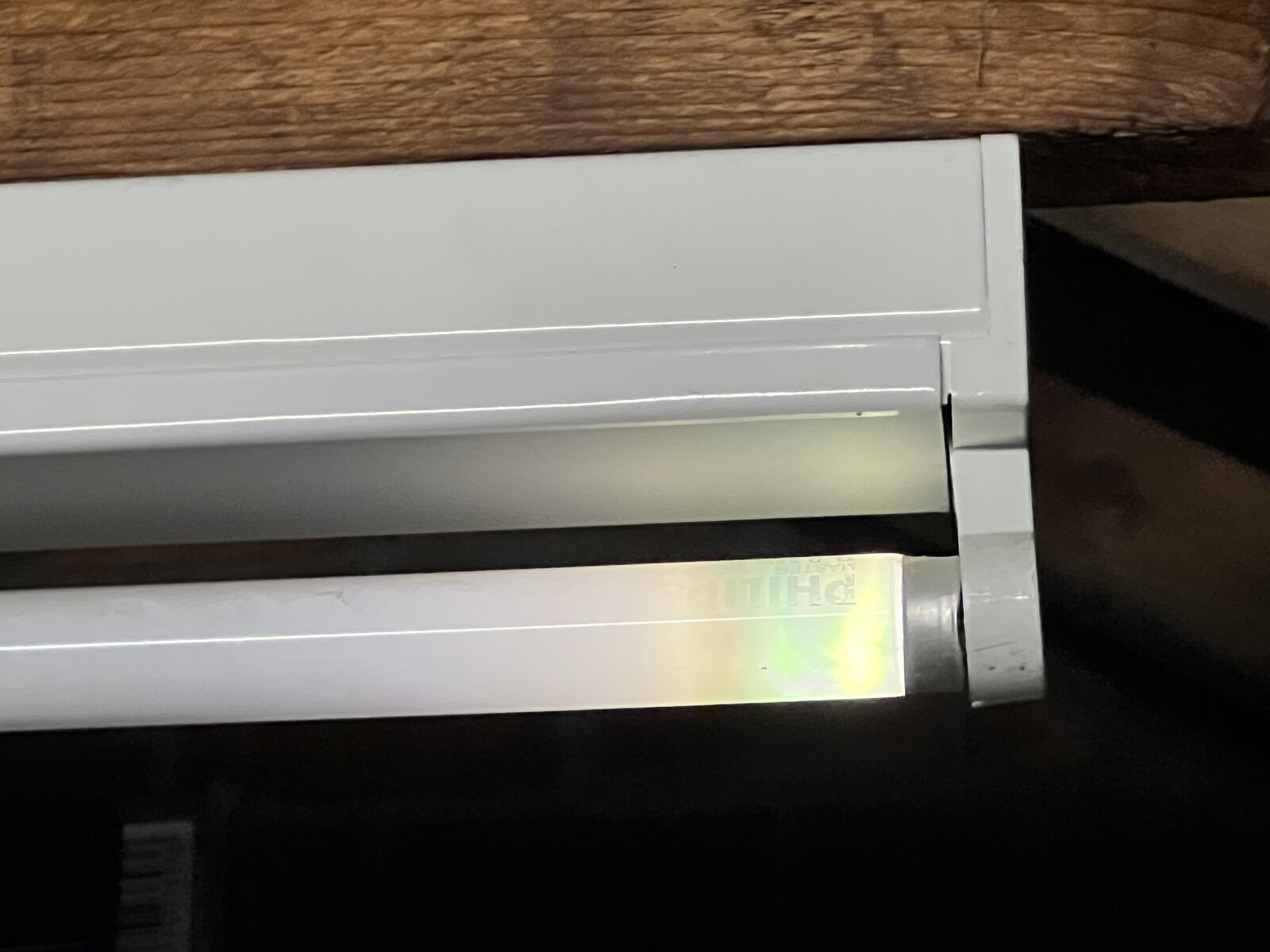

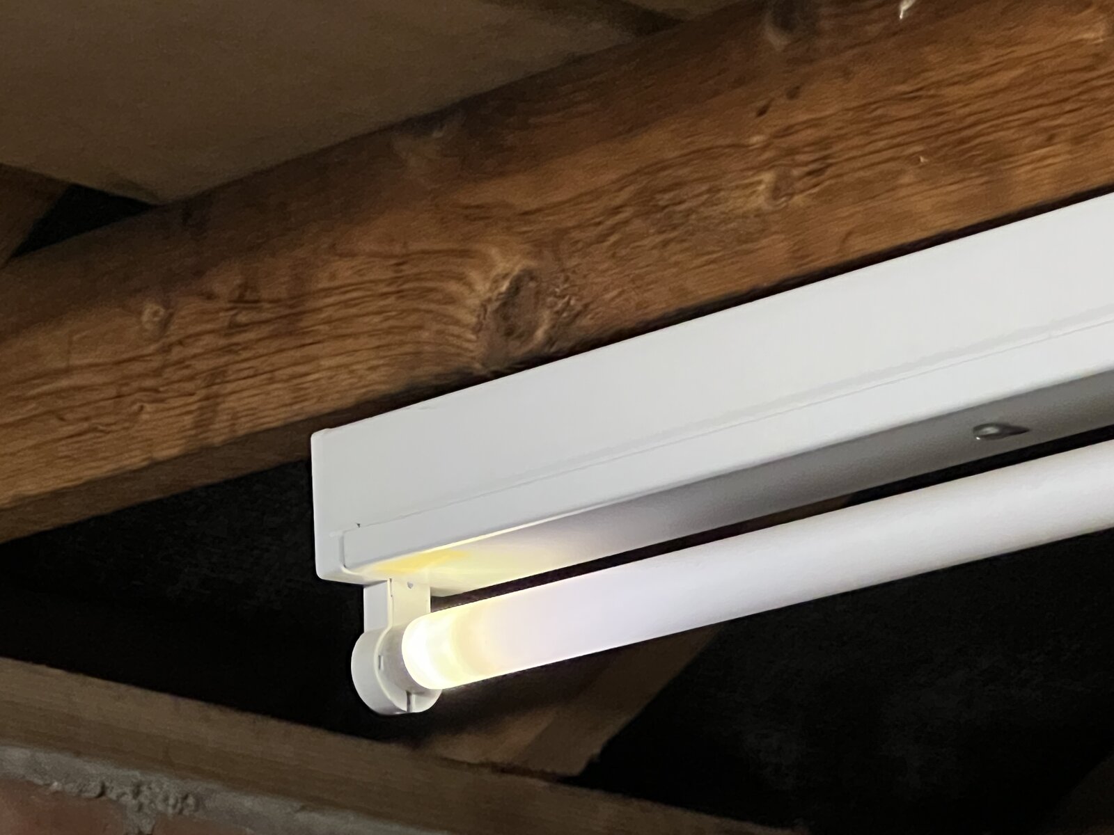

I have two fluorescent tube lights in the garage. Both were there when we moved in so I don’t know how old they are. Recently one of the two has stopped lighting when I turn it on. The two ends glow, and flicker but the tube itself never actually comes on. See the photos for what I mean.
Does the tube itself need replaced or is this a fault with the starter?

If the tube glows orange at the ends, the tube has reached the end of its life.
Could be that a new starter is required - swap the starter from the working fitting, if the tube now springs into life shows that the removed starter has died.
But best to replace the tube with a new one, will probably be more brighter, as fluorescent tubes dim over their lifetime.
If the tube glows at the end constantly, without flashing or the ends dimming, then the starter ins't working
If the tube flashes but doesn't strike, the tube is bad
But, if left on with a bad starter and the ends glowing, will wear out the emmision material on the filements and if left flashing from a bad tube, it'll wear out the starter. So doens't really matter what is faulty, its normal to change them together. An older starter that works but has slowed down will also wear the tube more.
