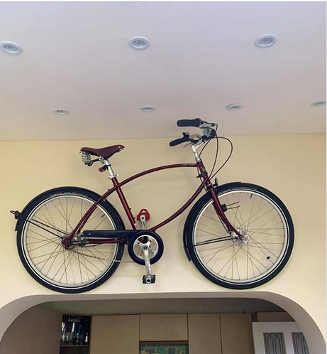

The main advantage of LED is you have the same spread of light to a fluorescent, but can select the output, so 5 foot long and just 2200 lumen on the second one, and 24 watt, same area now has GU10 down lights, Kitchen bike.jpg I think 16 x 3.5 watt so 56 watt, 4080 lumen so around same power as original fluorescent and 1000 lumen less output, he says it looks better, also our hanging baskets of flowers changed for a bike, seems an odd decoration to my mind.
