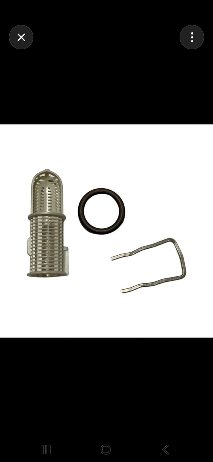

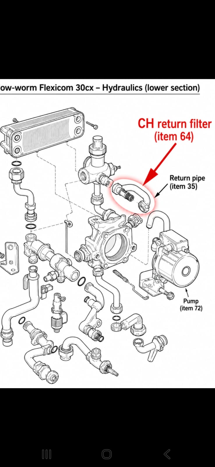

Can a blocked filter cause f9.
It's had new pressure switch already.
The filter in picture do these block on Gloweorm causing intermittent f9 ?

Unless it is restricting the pressure sensor reading, I would say no.
