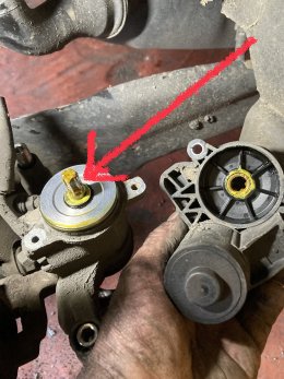

It has an electric handbrake.
Is there anything complex about changing the rear pads I need to be aware of?
thanks
No. Will be the same as my Audi. Release the handbrake. Remove the wiring and the two bolts that hold the EPB pinion onto the calliper, wind the epb spline back with a suitable socket, push the piston back as per a normal calliper piston, fit the pads, fit the epb unit, apply the handbrake, job done.
Follow Mottie instructions but at the end, before applying the epb, pump the brakes until you get hard pedal.
Then apply the epb.
Audi mechanic told me they do this when vcds unit is busy and it worked on my VW and Audi.

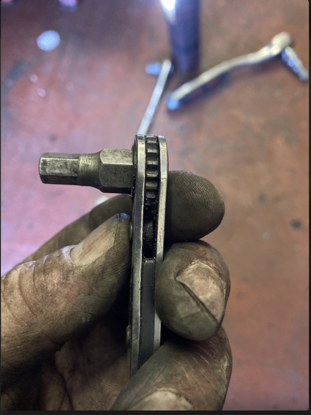

Oh, and if the Golf is anything like my Audi, it's not easy to get an Allen key onto the calliper bolts. I ended up using a bit with a 10mm bit on the other end that I put in my 10mm ratchet spanner.
