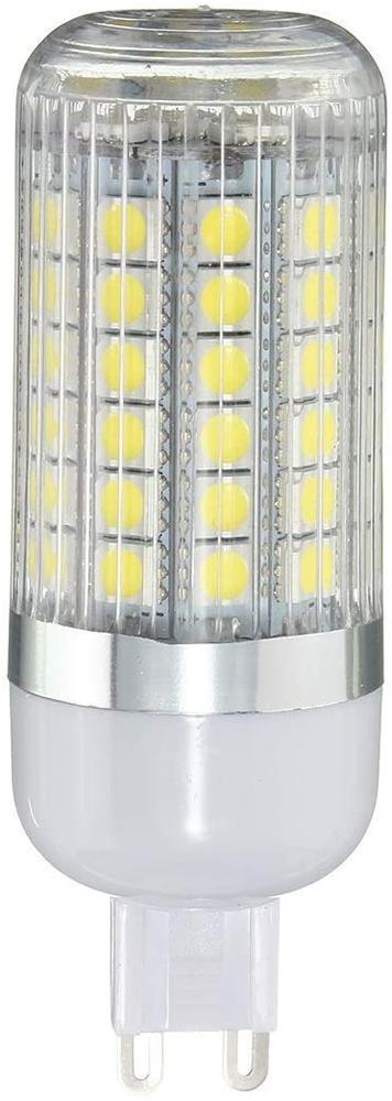

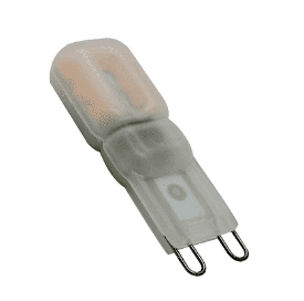

The big problem with LED light is like fluorescent it can produces a 100 Hz pulsed light which can affect some people and also cause a strobe effect, this can be prevented by using a capacitor after the rectifier so some lamps do not have the problem, I had problems with G9 lamps, the local electrical supplier provided these G9-small.jpg lamps, which had a flicker problem and also flashed when switched off, a load capacitor stopped the flashing, but only way to stop flicker using local suppliers was to use on quartz lamp.

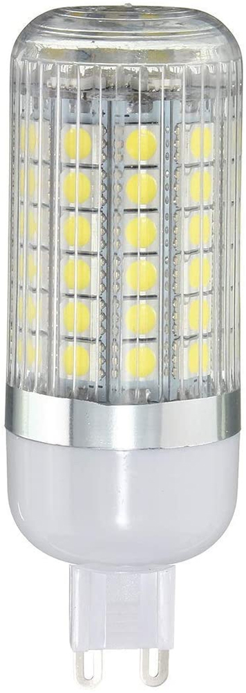

My wife found on the internet these G9-big.jpg lamps, which stopped the flicker, one went faulty so I took it apart to find what was inside it, the current was limited by a capacitor, and fed into a full wave rectifier and a large electrolytic capacitor which which stopped any flicker, the electrolytic capacitor was nearly as big as the previous bulb, and the covers could not be fitted. And the bulb was strictly speaking not allowed for sale in the UK as no wattage or lumen markings, but it worked, I also found a dry joint so repaired the bulb.
However there is no way to read adverts and select bulbs which have no flicker.
