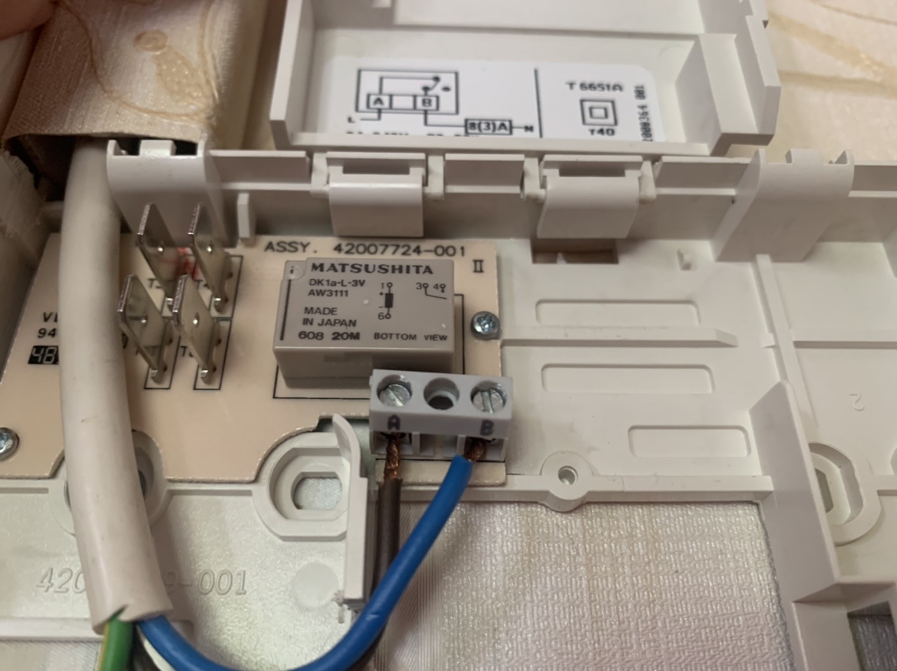

Hi all,
I’m trying to install my Nest E as per the instructions for a 2 wire system there doesn’t seem to any useful labels on the existing thermostat that would allow me to connect to the correct terminals of the Nest E.
All I have are 2 wires (blue & brown) and a clipped earth that are connected to 2 terminals on the Honeywell that are marked A and B. (See pic)
Can anyone tell me what to connect here - I was hoping that the existing thermostat would be clearly marked but A and B is a bit vague!
Yes, A is live in and B is switched live out, which should be sleeved brown if mains voltage.
So Brown to Com and Blue to NO
Thanks guys, all done and seems to be working. Now just have to sit back and collect all those sweet, sweet savings..hopefully.
