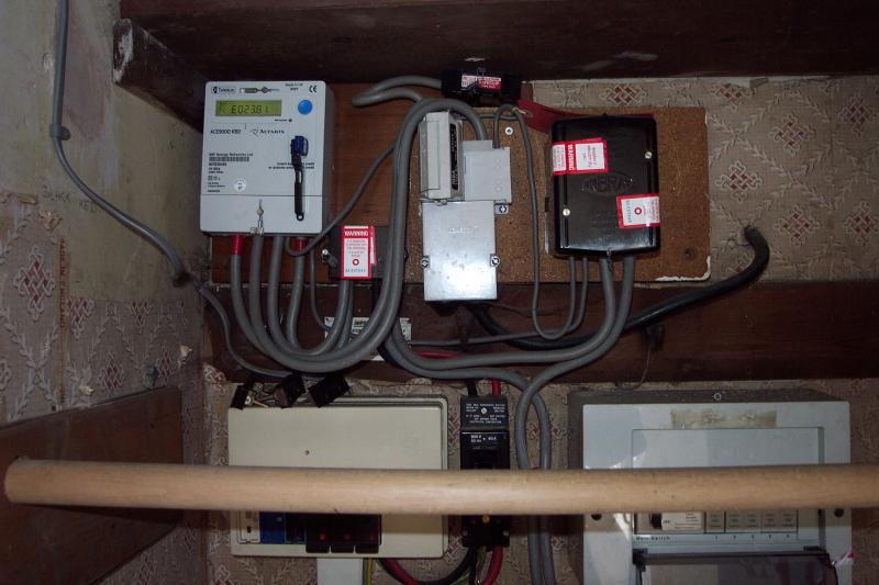

Why don't you post a picture of the existing fusebaord and incoming supply arrangements - always the cause of some amusement.

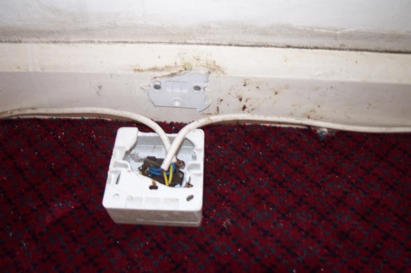

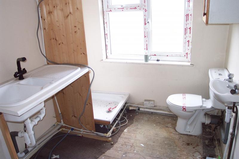

2nd Bathroom - socket on wall under window. Cable wired into the back through a broken side.

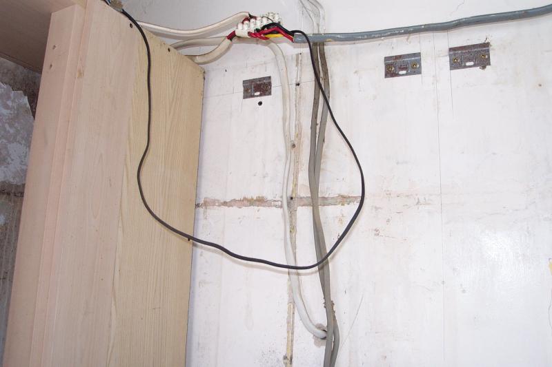

Conn block under shower
Cooker cable - split to feed the cooker, extractor and another power shower through wall.

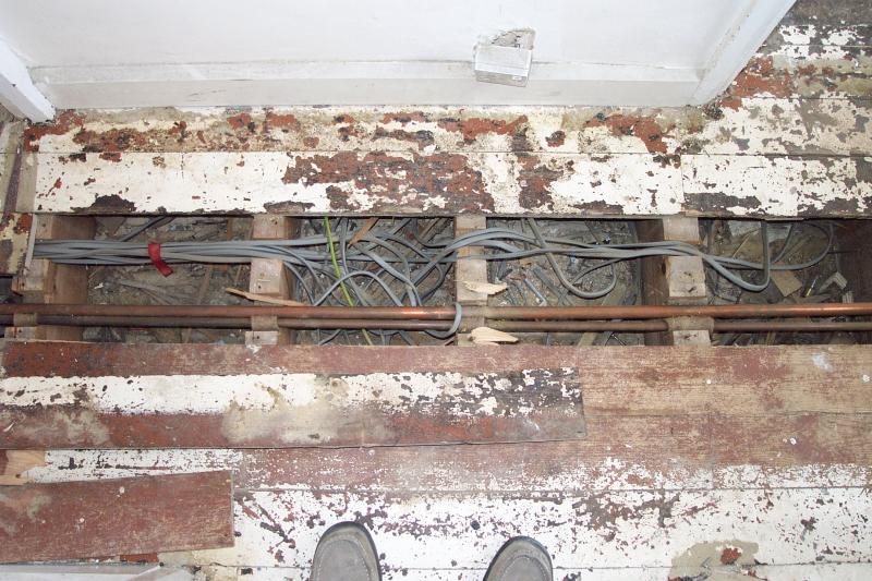

I'm going delving under boards tomorrow.... Stripping out the last of the water pipes [ all of it! ] & redundant cable [lots of it - they were powering all sorts inside and out] - remove extension cables wired into the back of wall sockets and then follow the cables from fusebox back to fusebox.... I want to know what's going on myself first. I'm hoping the original rings went in place properly - before the last occupant started messing with it!
sadly, if the installation has been chopped about as much as it appears then it may be more cost effective to have the place rewired, although this may not be quite as expensive as it initially seems if you can find an electrician who is happy for you to do the donkey work, which you appear capable of.

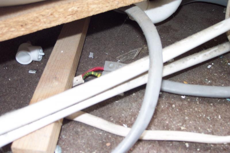

The cut wires on the non-tripping trip - wondering what they connected to.
With 3 or 4 sockets on surface mounted extensions - originates plugged into a socket in the same room.
Yet, with all this spaghetti, why all the extensions? Heh!

One of your problems will be that brown voltage ELCB.
It is redundant and obsolete
They don't work in todays installations, thats why it probably doesnt trip!
That will mean you need to protect the Wylex board on the left and sort out the earth cabling. Test them and bring them up to date. Put them together in a new MET with 16mm to each fuseboard.
That Crabtree board on the right. Is that a 30mA RCD being used as the incomer?
Tisk tisk.
Hmmmm! The meter can't be that old - you'd think the leccy board would have condemned it if obsolete - then again, if the guy was to just put a meter in....
I'm going to say 'yes' but have no clue what MET is - will look it up!
The board on the right is for economy 7 - Storage heaters - these are going & I'll remove all that wiring. Have to have leccy in to swap meter about & remove the '7' tails.
Client wants that going in an outhouse..... will consult Building Control regards suitability.
Definite rewire time - nothing there worth keeping, and as the place is being refurbished, no better time to do it.
The third fuseway from the left on the white Wylex board has the wrong shield fitted - the painted edge types were from the older models which were dark brown.
Sorry, I was referring to the ELCB - given the meter is recent, I was kinda assuming the out-of-date ness, would have been sorted when it [the meter] was put in.
Yeah, start from scratch -
DNO tend to only care that the meter is recording correctly and that you are making it clock up money for a big bill, they arn't fussed on the state of your wiring
